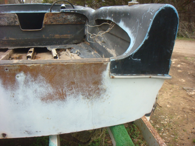

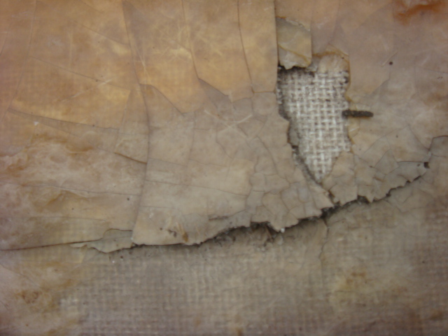

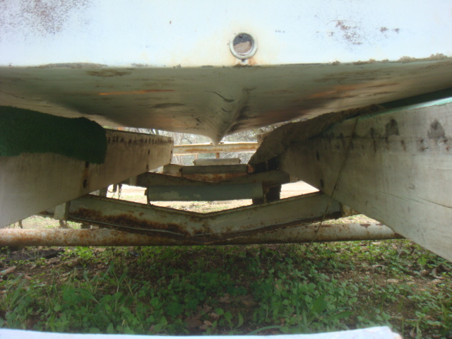

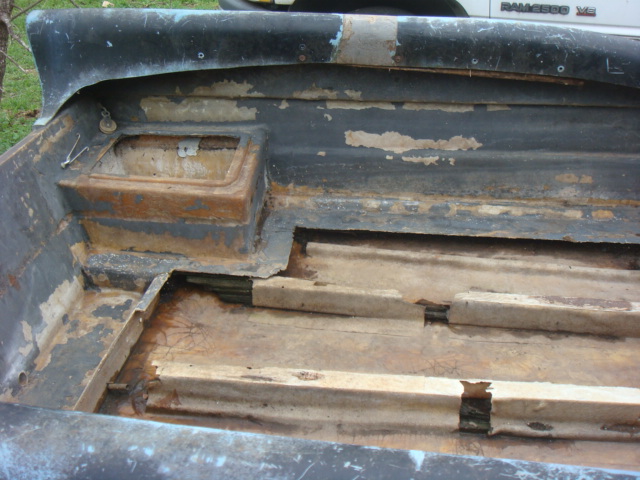

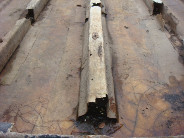

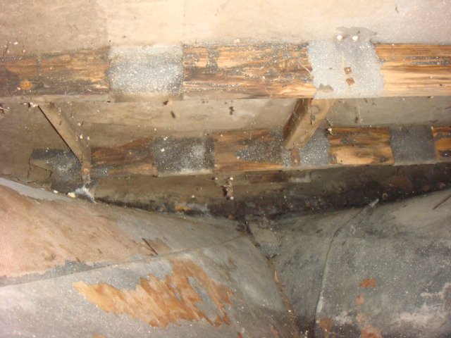

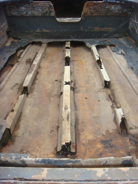

After a good cleaning it is apparent there is some damage. I found two of these crunch marks, probably from the multiple times the boat was moved in the last 10 years. There is also major spider web cracking in the floor of the hull. I dont see any in the sides, but it is covered in cloth. I also found a few round holes about 1/4 inch diameter. At what point does this job get out of hand? Can I fix this hull?

The lay-up in these pictures looks very poor. A good fiberglass layup has more glass than resin. Resin "rich" lay-ups are failure prone, because the resin by itself has little to no strength. When resin is applied too heavily, it tends to crack like a dried lake bed. This hull looks as if the builder thought more resin would make it stronger - but it does the opposite. What does the rest of the hull look like?

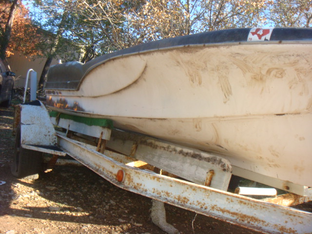

Re:Mystery boat hull condition 13 years 11 months ago #55532
All of the advice is right on. You don't have a picture of the whole boat. If is a real classic you want to keep, then by all means "dig in". If the bottom layer is salvagable, then it's possible re-laminate over and under. If not, then you might want to look on craigslist or the boat recycler. You might get lucky and find another boat that will cost you the same as the whole repair would.

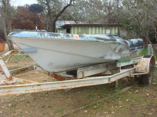

Re:Mystery boat hull condition 13 years 11 months ago #55580
I am no expert, but the rest of the hull does not look as bad as the bottom. There seems to be much more cloth along the sides and the transition to the floor. The hull sides all feel strong, along with the bow. All of the "lakebed cracks" appear to be on the bottom back half of the boat. I have been in possession of this boat for a while, and I plan on fixing her. If she was a Glastron or a Redfish she would have continued to the landfill, but being what she is not, I want to keep her forever. It seems like my focus needs to shift more towards hull repair before woodwork. This might be out there, but is what about remolding the hull, just like all the knock-offs did in the day?
