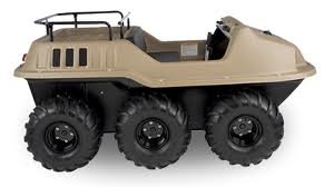

Buss, maybe you can get on of these. Amphibious in case you find a lake with water. I believe they started making these in the late 60s. A Glassic ATV!? B)

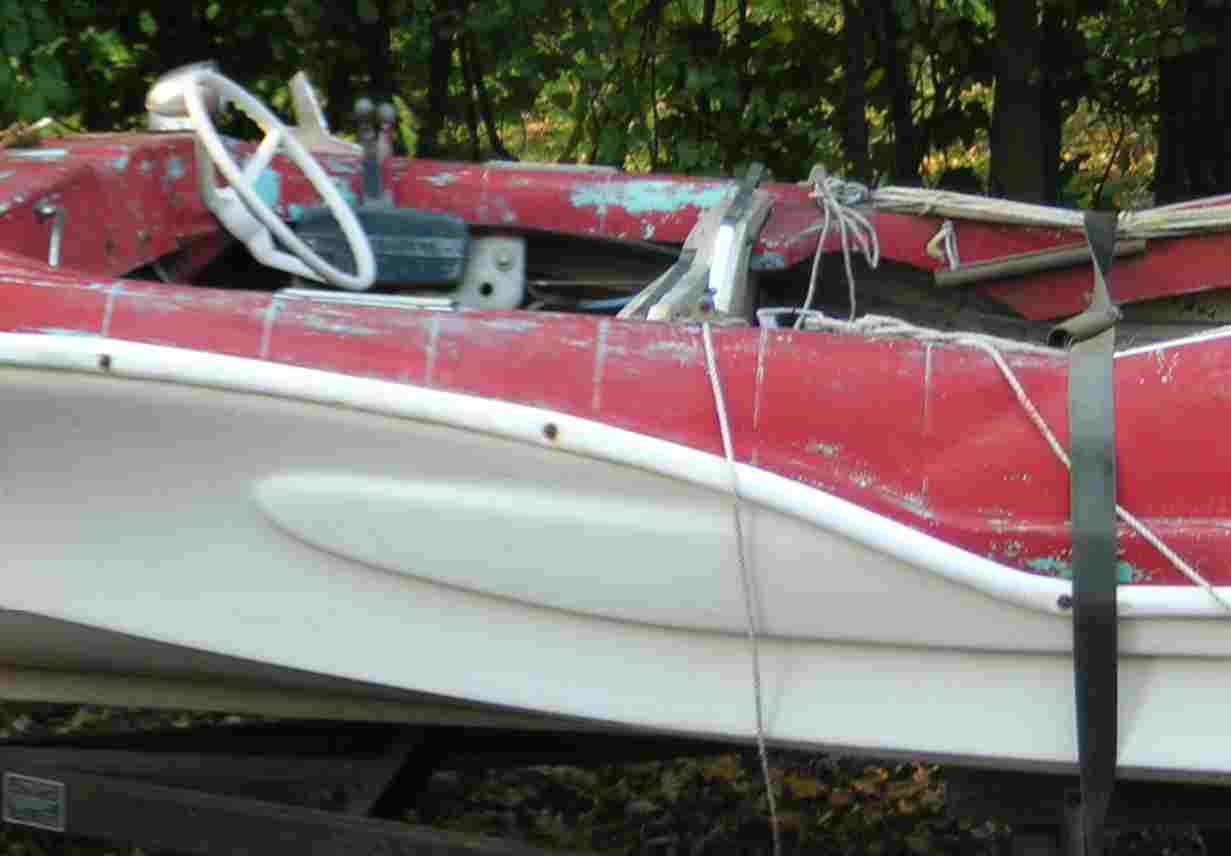

Hey John, Have you seen the red fish in Waverly on eBay right now? Know anything about it? Thx, Joe
Re:Mystery boat interior shot 13 years 11 months ago #55321
i've been following it on ebay....haven't went to look at it...would only be a 2 hour trip 1 way but we have 5 red fish now so no more room...has the cool steering wheel and the attwood bow light (with the center light missing as usual) wonder what shape the balsa is in....the sea sharks don't show up that often...looks like it should be worth the money....john
