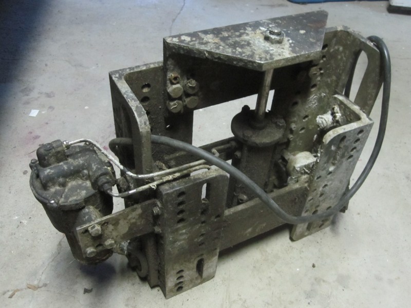

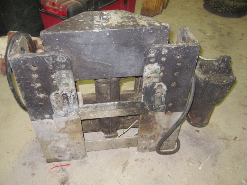

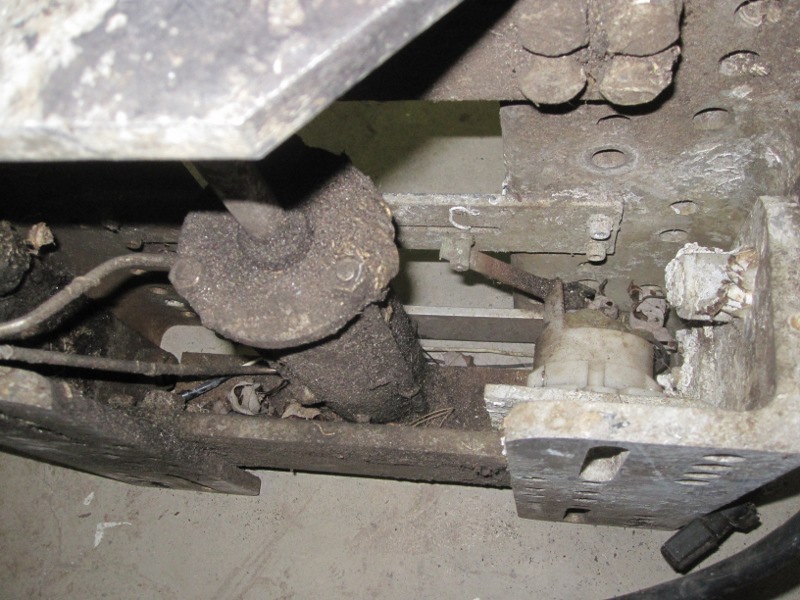

Picked this baby up today and am on a mission to identify it. I haven't cleaned it up yet, but can tell it's a Power Lift brand. Doesn't look like any of the current models, at least with a quick search. I may disassemble it to clean it well, then see how it works, or may just try putting power to it, and see what happens. It's filthy, so over the next few weeks I'll be cleaning and playing with it.
Is it the kind of thing I might want to put on the Power Cat if I get it working?
Any ideas what model it is, and/or where I could find more technical info on it?

Three wires, I assume the black is ground and blue and green are either up or down. Motor works both ways, but piston doesn't move. Need to clean it up some and figure out why the piston isn't moving. Good chance something is bad. Looks like it came from saltwater too.

Nice find, Frank. It looks like a VERY early CMC Power Lift. www.cook-mfg.net/ If your cleaning uncovers any numbers, CMC may be able to answer any questions, supply parts, etc. Good luck, hope it works with very little fussing.

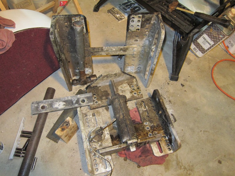

Re:Power Lift 14 years 1 day ago #54919

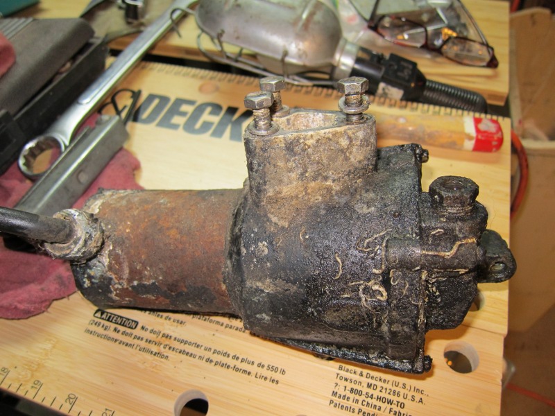

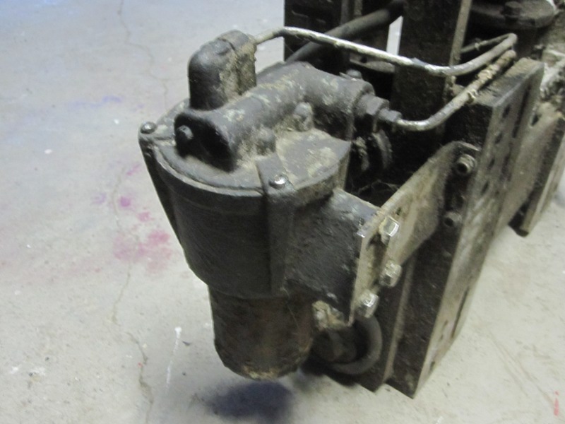

Started pulling it apart. Motor was easy to take off, 3 bolts and 2 brake lines. Big side bolt (1 1/8" heads) are kind of a bear to get started, but once started, not bad. Got a number of pins to punch out, but they are just under 1/2". I think they're steel pins in aluminum, but not sure. Need to come up with a way to get them out. Hole is bigger than 7/16, but will look for a punch that size, or make something up.
Motor works, but I think the piston is froze, so don't want to run the motor much till I can get the piston out.
Frank

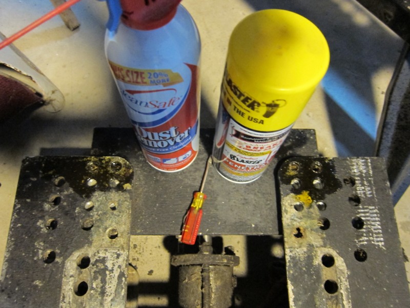

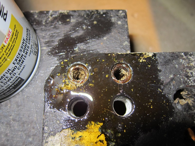

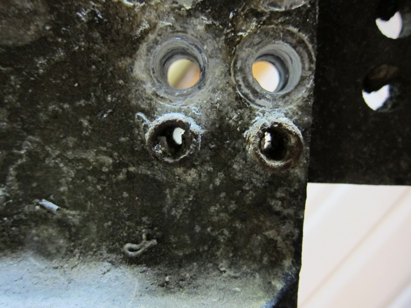

Roll pin removal? 14 years 16 hours ago #54930
I bet these babies been in there 40 years if they've been in there a day. Tried pounding them out, no luck at all. Cleaned around the rim, blew it out, and hit it with PB Blaster, gonna let it soak. Any suggestions for getting these babies out?
Once they're out, the unit comes apart.
Frank
Re:Roll pin removal? 14 years 14 hours ago #54934
Frank,
There are many ways to get something done, and others may be along with other ideas, but here are some I have used.
Assuming it's aluminium I would heat it with a torch. I would also find a piece of 1/2 diameter steel to use as a punch. Chamfer the edge so it won't dig into the aluminium as it goes through. Ideally you would machine a guide pin on the end to keep the punch centered on the pin when you start out, but it looks like they are depressed enough to keep the punch in place.
It would also help to have someone with a Vise-grips holding the punch so you could hammer more easily.

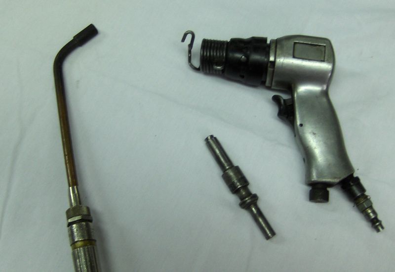

If you have an air chisel you can make a tool that can hammer the homemade punch. Grind off the end of a muffler tool for an air chisel. See the photo.
High frequency blows tend to break things loose better than one sustained push. It breaks the oxidation bond. I use mine to break things loose like that a lot.
The key is having enough heat to expand the aluminium quickly before the pin can expand also. That helps break the bond and enlarges the hole.
An oxy-acetylene torch with a rose-bud tip is ideal. See photo. Next would be a big propane torch plumbers use to thaw pipes. Last would be one or more, hopefully more, hand held propane torches.
Safety glasses for all involved as the homemade steel punch is soft and metal splinters are possible.
Plan B would be to try and drill them out. Free hand would be difficult. You will need a big drill motor. Better yet would be a drill press. Start with a drill bit that is slightly larger than the hole in the pin. Use plenty of oil. Keeping upping the drill size until you can take a sharp punch and peel the remaining pin material out. That should preserve the hole diameter.
You always need a plan C. Here is a Plan C, but I hesitate to describe it as it can bite back badly.
Plan C would be to cut the punch to about the same length as the pin for safety, find a good sized hydraulic jack, and find something the jack can't lift. Maybe a bulldozer, an eighteen wheeler, a basement beam?
Support the assembly so you wan't crack it, set up the jack and punch, and then heat the casting quickly. Use the jack as a press. You might get lucky.
I always have better luck with heat and vibration than my 20 ton press.
Be careful with this setup. Keep anything used for transfer of push from the jack to above it as short and straight as possible. It can be spit out like a bullet if it gets crooked, so keep your head well above the jack.
Good luck with your project.
Re:Power Lift 14 years 14 hours ago #54935
Boy, those are EXCELLENT suggestions, thanks!
I think I'll try suggestion #1 first. I have some 1/2" steel stock around and could do that. I also have a monster floor drill press that will go down to 250 rpm, so maybe suggestion #2 next. Gee, maybe suggestion #2 1st...
I have a good friend who has suggested I bring it over and he'll press them out (suggestion #3).
I'll keep y'all posted, but thanks again, great ideas.
Frank
Got it apart! 14 years 3 hours ago #54949
Got it apart! Let it soak in PB Blaster overnight, made up a wood block this morning, used a deep 1/4" drive socket that fit real well, 3# sledge, bingo! Thanks for the tips all. This will make it easy to keep disassembling. Pins are still in the block of fir (2 in each end), will split it tonight when I get home to rescue the pins.
Frank

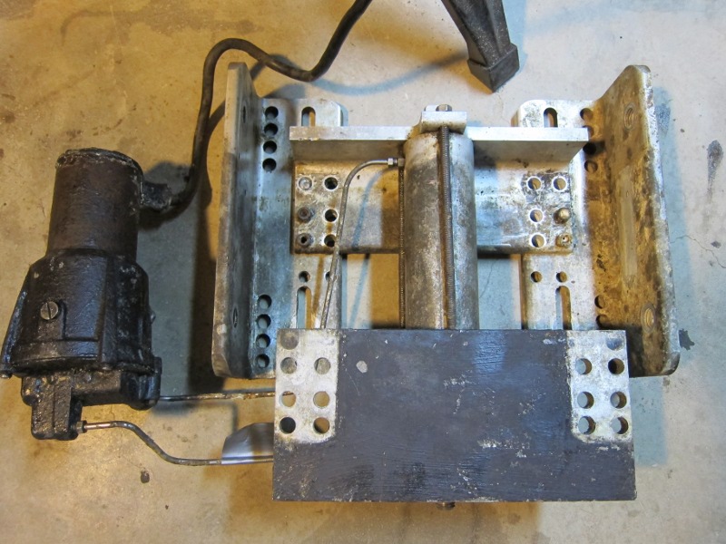

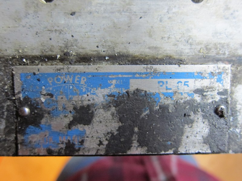

Identified unit & ready to test 13 years 11 months ago #55001

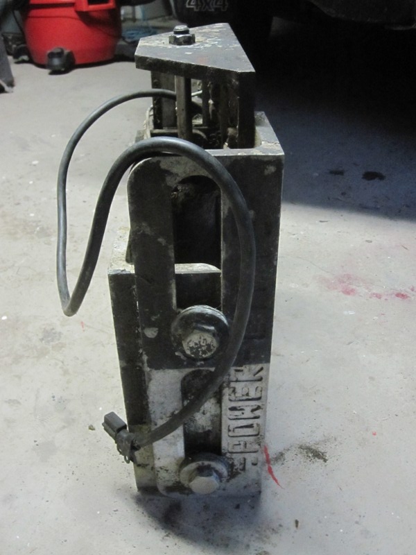

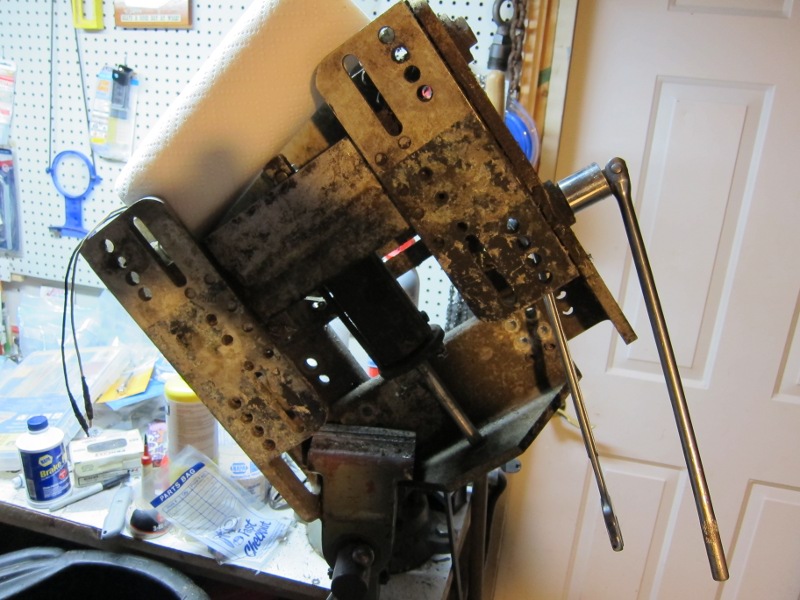

It's a vintage CMC PL-65. Last piece I was cleaning had this black rectangle. Some PO had obviously done some painting. I was able to carefully scrape enough off to verify it. I emailed Cook Mfg. to see if they have a manual for one of these babies. We'll see if they respond.
Got it about ready to test, trying to figure out how to get it upright for a test. With lines on but not tightened, piston rod moves up and down but not easy like when a line is detached. Need to get it upright, tighten the three long threaded rods that hold the piston end cap, tighten the lines, fill with oil, put power to it, see what happens. I know the motor works, it's now a question of the pump.
If I can get this baby working, I wonder how to integrate my PT&T with it, and also wonder how or if I can get a low water pickup for the old Merc? Don't know much about this stuff.
Thanks!
Frank
