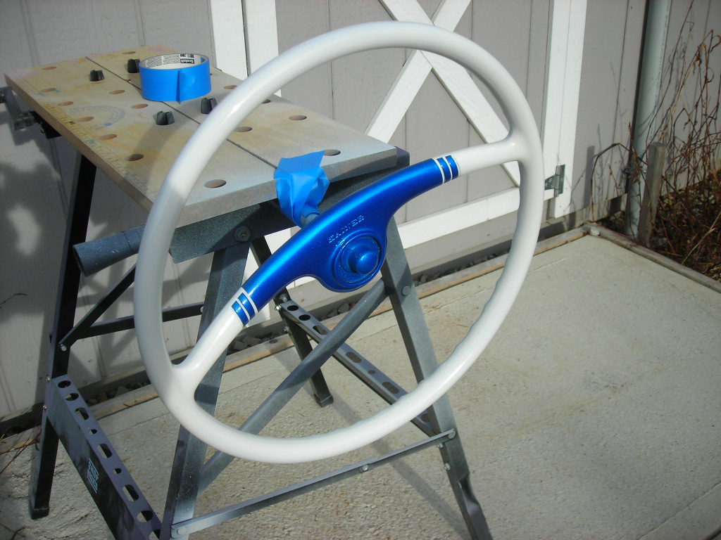

My steering wheel resto 14 years 1 month ago #54204
doing away with the old black Atwood on the SR600
and here is the replacement
before
during...
and after..
Can't wait for my chrome to get home !!!

Boy it comes right at you and says,"Look at me." Nice work, good color.
Re:My steering wheel resto 14 years 1 month ago #54208
Now that will wake you up first thing in the morning. Nice job on the paint,and she should look great with new chrome. Keep up the great work, Skip.
Re:My steering wheel resto 14 years 1 month ago #54209
mopar it looks great,take it from me i have done many of them.
they arent easy to do,john
Re:My steering wheel resto 14 years 1 month ago #54243
High praise right there...Thank You

Re:My steering wheel resto 13 years 7 months ago #63451
since all of my posts disappeared in the forum changover....
the chrome came back and I made a plate to install on the boat
the 600 is in gelcoat process right now !!!

Re:My steering wheel resto 13 years 7 months ago #64802
not to critique or anything, but i woulda done something to that dash to compliment that incredible steering wheel...awesome. what kinda paint did you use?

great job,here is a tip the next time you do a steering wheel to make it easier.
1st buy a piece of all thread and some large washers ,put the all thread through the steering wheel and put on washers and 2 nuts,to keep it from spinning off the nuts,then put it in a vice,you can then spin it as you paint it.and get all sides at the same time.
i lucked out and have a leg from a table that i use instead of all thread,but it would be the same.john

Re:My steering wheel resto 13 years 7 months ago #65109
curious as to what kind of paint...and do u expect the finish to last?
Re:My steering wheel resto 13 years 6 months ago #65343
dupont urethene...should last forever
