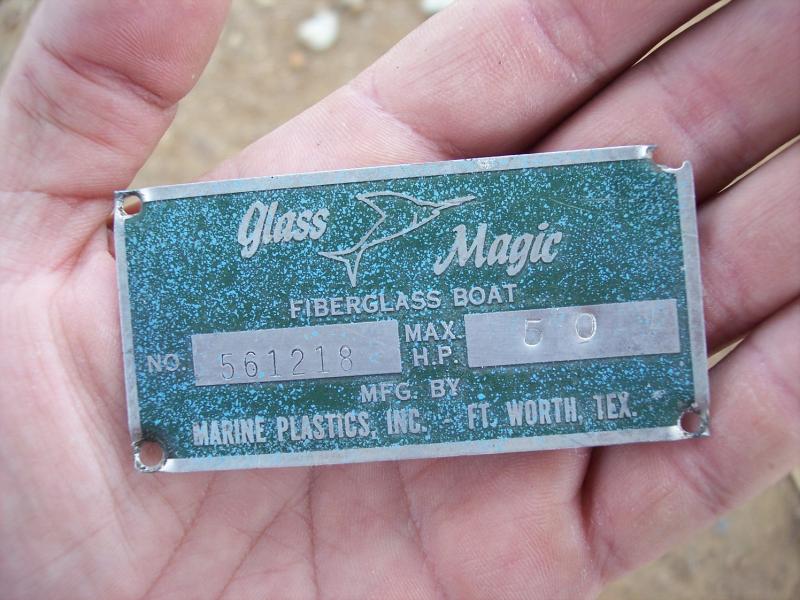

Here's an example of a 1956 Glass Magic ID tag.
Serial numbers often contain year of manufacture, length, three or four digit sequential numbers. Probably will meet all requirements if you make up the number of your choice and fix it somewhere on the transom like a Coast Guard Hull Information Number plate.
