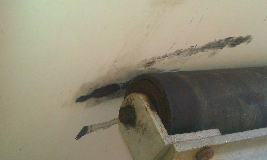

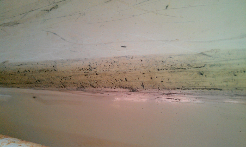

I was under the boat the other day and found these issues.
The first is on the keel it looks like little small chinks of gel coat came off the other is where the rollers on the trailer contact the hull these weren't there before I went to Clear lake and lake Redinger where the roads were filled with major potholes.Keel

1 - Keel It's said that gel coat begins to age and break down as soon as it's applied. The keel is one of the spots that is most subjected to damage, and one of the hardest spots to get at when the boat is on the trailer. It looks like somebody painted the hull somewhere along the line, and stopped short of the keel. The gel coat there is really in need of sanding, fairing, and re-sealing with either fresh gel coat or paint. You could run her another season or two, but I'd make plans to do something with it in the fairly near future.
2 - Trailer Rollers The rubber in the rollers gets old and hard, begins leaving residue (marring) as well as rubbing through the gel coat where they contact the hull. At the very least I would replace the rollers, using newer "non-marring" polyurethane components, and strap her down a little better as Skip suggested. Ideally while you have the boat off the trailer addressing the keel, that would be a great time to convert the trailer over to bunks. This spreads the contact area out supporting the hull, reducing the pressure points rollers have, and cushions the hull more IMHO.

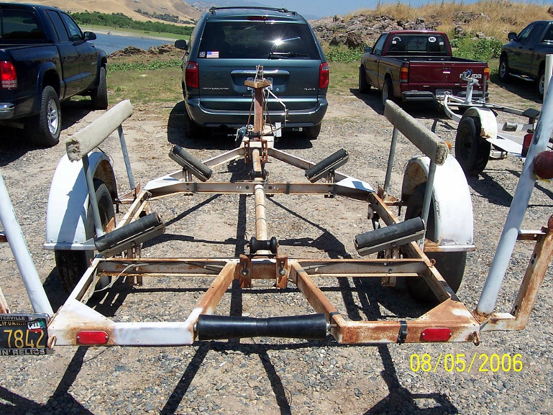

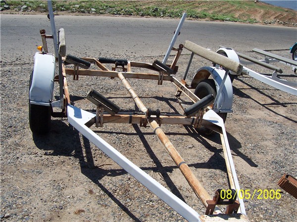

Thanks for the input. I won't shhoot the messenger. I have included a picture of the trailer. It does not have shocks just leaf springs. and the ony way the boat was attached to the trailer before this was by chains and turnbuckles at the transom. I now have a strap I wrap around just abouut even with the forward rollers. I like the Idea of the bunks I cannot find the correct size rollers for the side supports anyway.
So on the keel I will need to sand it down and re-gelcoat it fairing it in with rest of the hull? or can I just fair it in and paint it?

Wow, that is some fine looking trailer there. Yea, your trailer is really in need of bunks to get good suport on the hull of the boat. There are not enough rollers on it as it sits now.Bunks would be the cheapest way to go at this point. As for the keel you can fair and paint it and you should be good to go. Gel coat would be best, but it really takes some work and it is really hard to do unless you can flip the boat to do it.It is really hard to put gelcoat on upside down and have it turn out good.Shocks are not really needed on the trailer , although they do help some. Just as long as the boat is not too heavy for the trailer you should be fine with just the leaf springs. It don't look like your to heavy as it sits now so you should be ok there. Nice pic there. Good luck and keep us posted on your progress. Thanks Skip.

Good looking boat, and crew, you have there Hustler! The trailer just needs a little TLC and the bunks, you'll be just fine in that department. Here's a thread from the Trailer Forum about the brackets needed, and how Todd (thetudor) installed his.
www.fiberglassics.com/glassic-forums/13-trailer-talk/49422-qtq-shaped-trailer-bunks.html
Looks like you may just need the top part of the brackets, some boards and some carpet. You might be able to use the upright brackets you already have. Good luck with it, and keep us posted on your progress okay!?

If you are on rough roads a lot shocks are nice but in your case your boat is light. You do need bunks and I'd put a few more rollers under that keel. Does the bow hit anywhere when you load on a steep launch. We have some real steep launch's here. The bunks don't need to be huge but you want to support a good area.I'd get rid of those side rollers completely if it was mine. My second roller it comes in contact with is about 10 inches in front of the first one the boat touches and when it had those two it will not rotate on me. They are placed so I can put the bow on the first roller and straighten the boat with the bowline then just crank her up. As I pull out the keel rests on another roller as I pull out of the water and my block at the back. It is easy when I'm by myself that way even in the wind. That block in the back saved me from loosing the boat when the winch line snapped last spring on a steep launch. It had not been secured yet.

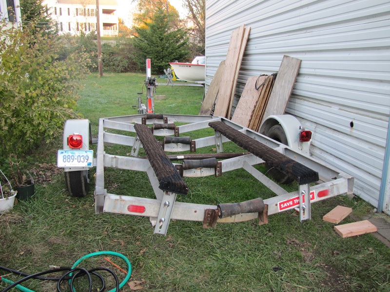

Here's what I did with the trailer for the Glastron. The bunks are 7 ft long and made with a non-pressure treated 2x6. They do extend to the transom for support. Also, they are spaced so the inside edge of the bunk is under the center of the stringers in the hull (when the boat is put on properly). This make it bearing at the strongest part of the hull. I needed to balance the spacing between my desire to have it bear on the stringer but not have it too narrow so the boat is not stable. I think I have achieved that.
The keel rollers still need to be reworked to work with the hull, but this should not be a problem.
Now I have got to figure a system for being able to self-center the boat. The CC trailer has me spoiled.
