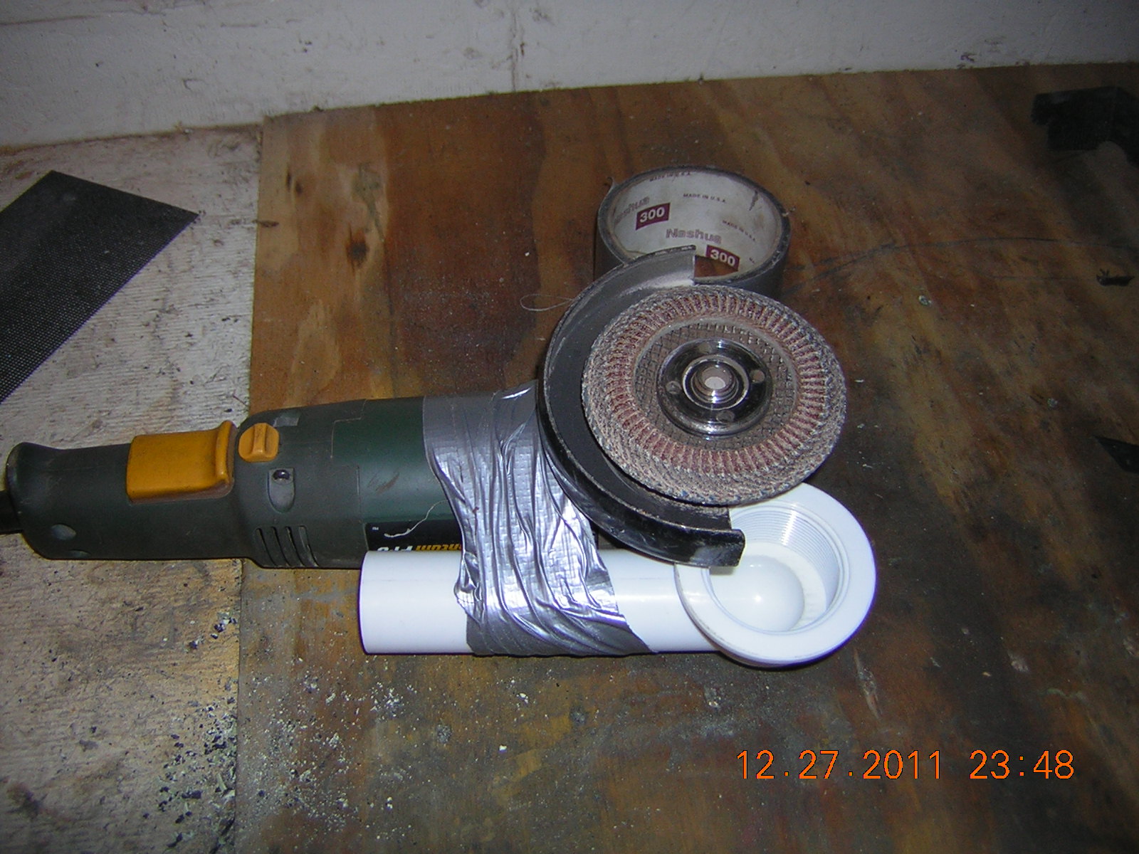

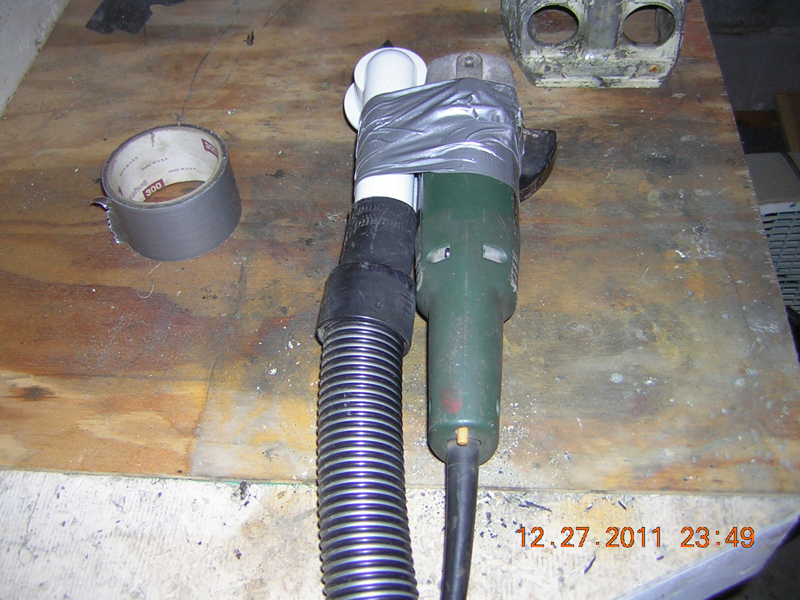

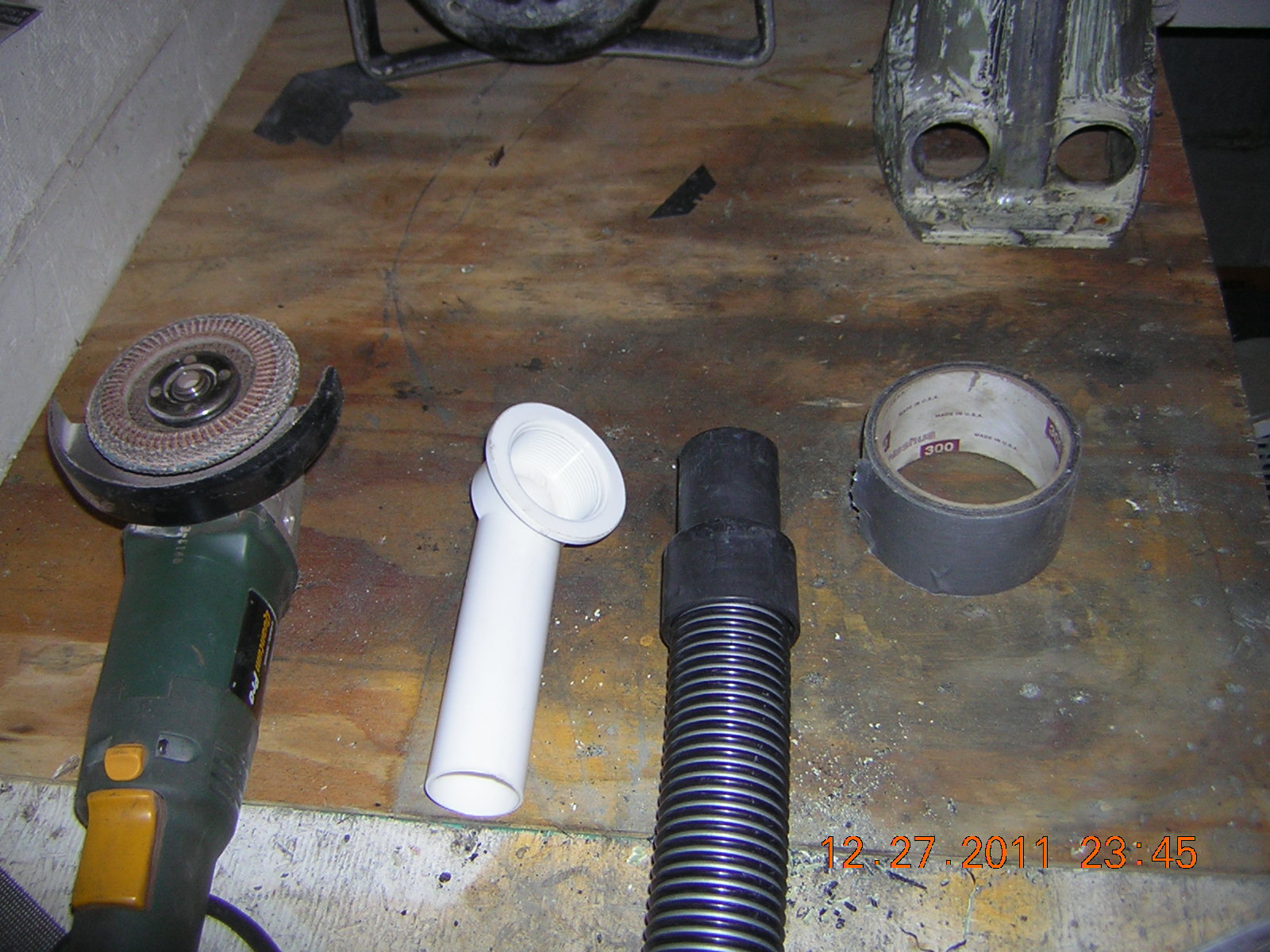

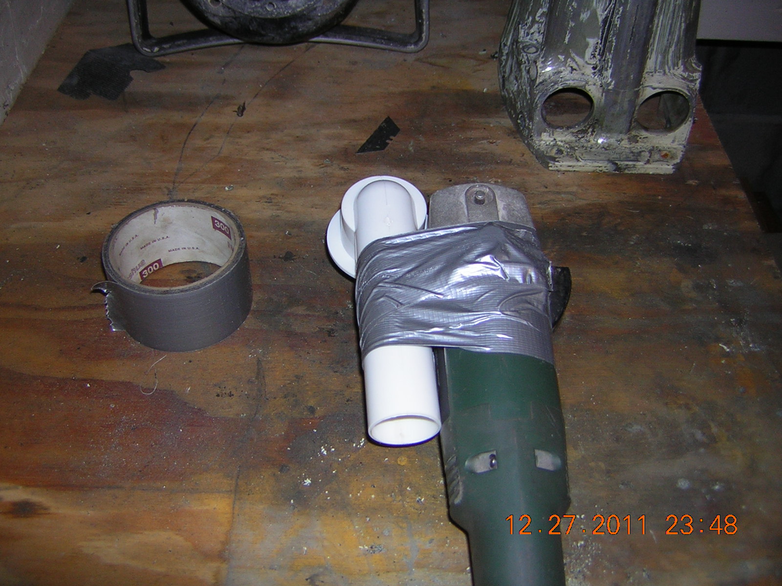

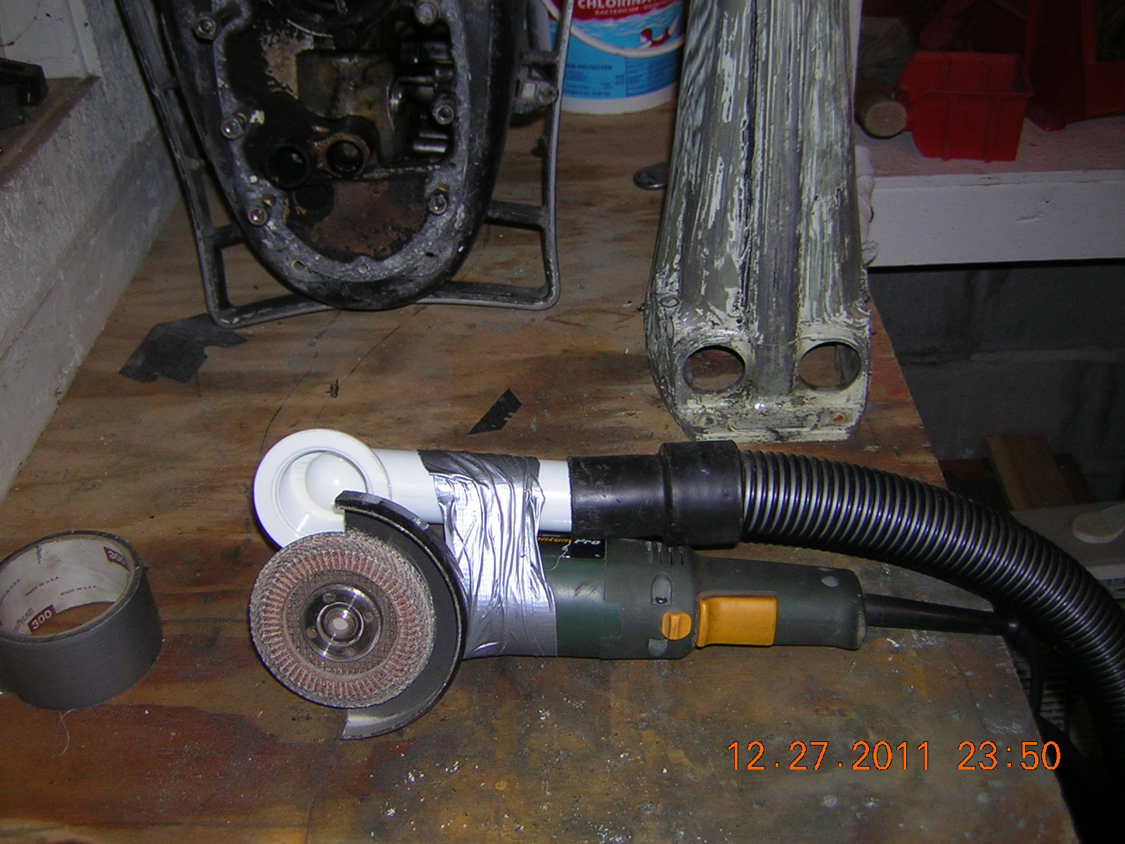

Ok, are afew pics of the grinder dust collector I use. You will n eed 4 things to do this. 1- Grinder. 2- 1 1/4" id. elbow. 3- 1 1/2" id vac hose. 4- Handymans secret weapon.
[img] [img]http://www.fiberglassics.com/media/kunena/attachments/legacy/images/boat_grinder_029-20111227.JPG
That is the simplest one that I use. I works pretty good, but it will not get 100% of the dust, mybe 75%. Better than nothing. If you need more dust gone you will have to buy a enclosed vac. tent with positve air flow to draw all dust out. Skip.

hey that looks like that classic Japanese para scope used on a mentor?
Re:Hardtop progress/dust collection question 14 years 3 weeks ago #53302
Bathtub fitting?
Re:Hardtop progress/dust collection question 14 years 3 weeks ago #53315
that or a kitchen sink, double sink.

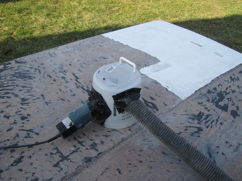

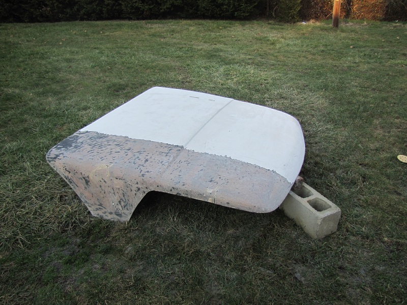

OK. I tried to build a dust collection hood from a $2 plastic bucket from the hardware store. Not very successful.I have one other mod to try to get it to work before I scrap it. Actually have the top 60-65% stripped at this point.

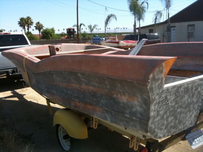

I'm very concerned that the way you are gringing off the gelcoat is going to cause you major problems. From the pictures, it looks as if you are putting a million grinding mark "shiners" into the glass. This will take a massive amount of fairing and sanding to correct, otherwise the boat finish will look like cobblestone. Have You considered sand blasting the boat yourself, or even better - sending it out to have it blasted? There is also a special gelcoat planer that shaves off the surface a few thousandths, leaving a level and clean layer of fiberglass. No trying to be critical here, just warning against making more work for yourself than intended or necessary.

I got the dust collector to work! The attached pic shows what I had set up. The bucket is a 5 qt paint bucket. The bottom was partially cut out and a piece of plexiglass installed over it. The handle (drawer pull) was attached to that. Holes were cut and the 2-1/4" shop vac hose went into one and the angle grinder into the other. Each was sealed with duct tape (yes, black duct tape). It collected probably over 90% of the fine stuff that floats in the air and 80% of the heavier stuff. The heavy stuff could be mostly picked up by turning off the angle grinder and just using the hood.
The down side is that it is not effective on corners, edges and difficult on the small vertical sides.
The remaining stuff I can take of easily with a random orbital with 40 grit.
Bruce, I understand your concern and it is something I wrestled with. A random orbital sander would be gentler and probably required less filling, but the time and material factor weighed in as well. I did the best I could, but there are some areas that will need a fair amount of filling. I accepted that as part of the program.
If there is a sand or other media blasting system that can take off gelcoat without damaging the underlying fiberglass, I'm all over it. The deck on the boat is going to need to be stripped as well and any alternative would be welcome

Bill, I do remember seeing NO NAME. The entire boat, as I recall, seemed very sturdy. My first thought " a mini WWII landing craft" LOL :laugh: Not surprised the gel coat was really thick.
Our Hardtop also had a black coating under the gel ??? Much of it remained after blasting.
Larry
