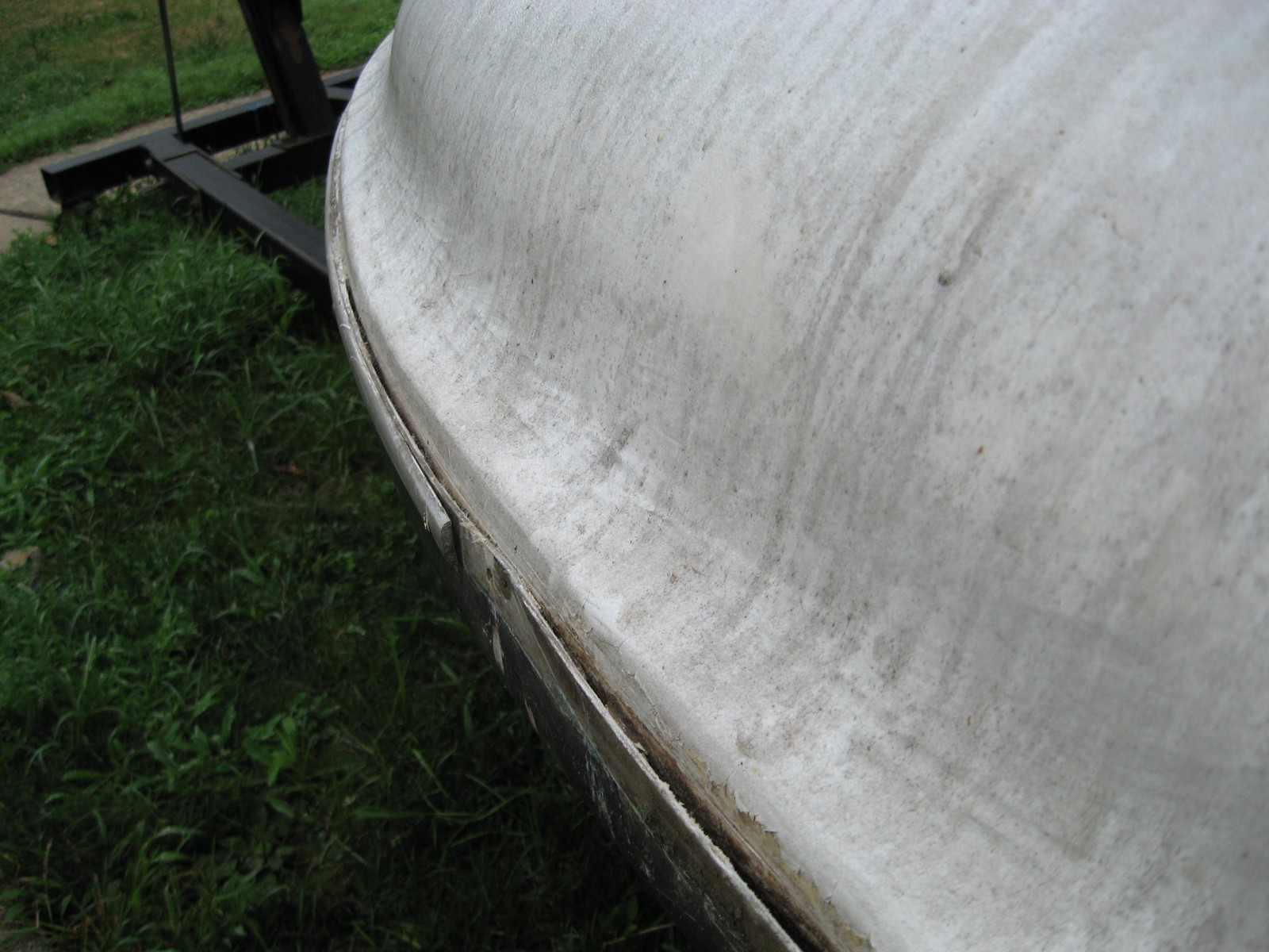

getting a bit past my experience level here
need to do some heavy glass work on my SR600
and wondered ...
when you take the aluminum rub rail off
#1 best way to cut the rivets ??
#2 I would like to reuse the aluminum channel but the rub rail inset is old and stiff..is there a way to soften it to slide it out or best to just scrap it ??
this rub moulding is solid and the channel is 1 long peice as is the moulding.
#3 any suggestions for salvaging it or should I just fing stuff to replace it ??

MOPAR: If the pull away from hull is prior dock damage,? I can see
a tight isssue.. One would want to keep the ALuminum channel against the top fiberglass. Typically # 1) one would unscrew the TWO END CAPS , upper rear side corner & try to push the rubber rub rail backwards away from hull.. IF dry rot it will break up .. Could be in TWO sections with a seam at the front bow..
2) One would UN-DRILL off the rivot heads with about a # 7 ...0.20 drill bit. 3) Take a round PUNCH & Hammer the back end of the little stud, free of the hole till it falls INSIDE the hull , away sweep out later....4) The top deck is usually like a shoe box fit or slight LIP, to pull out & UP ...BUT the AL channel should have plenty of glue / caulk to stick to glass top .. IMO

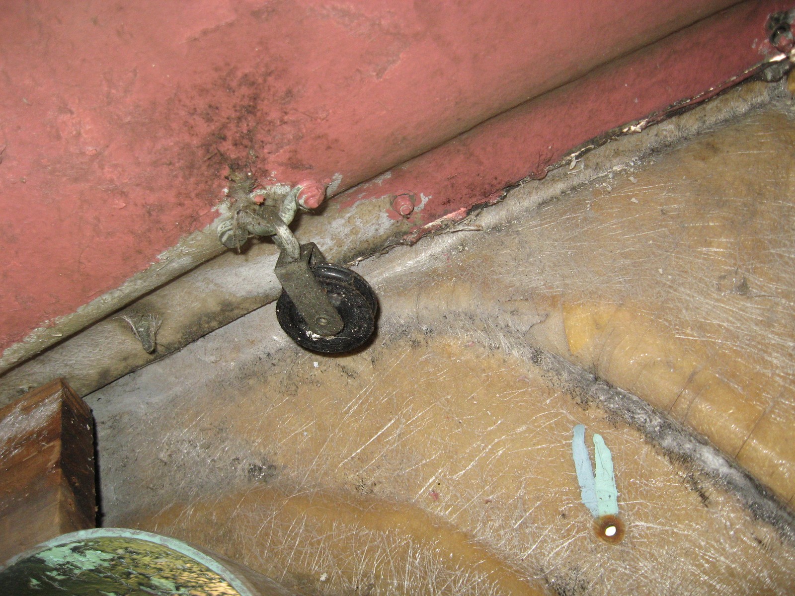

You might try a heat gun to heat that rubber some to make it more pliable. I would try to save the aluminum. Make sure your rivets are not little screws too. My winner had some rivets but was wood screws where there is wood in it for flotation or stiffness in the gunwale and small screws under the fore deck and is a two man job to take those out unless you got the worlds longest arms. Boat was upside sown here, to the left is the wood and has a mixture of wood screws and rivets. Little bolts went to the bow to the right. The little bolts came out easy as they were all brass.
