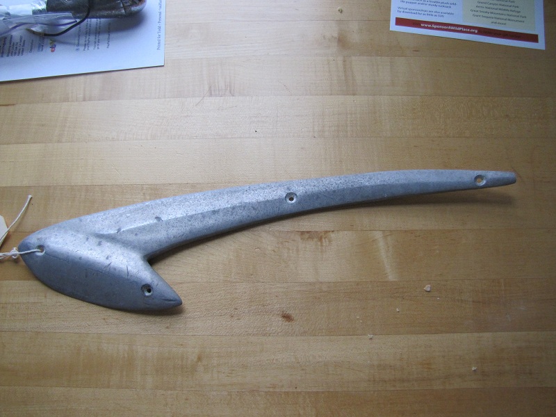

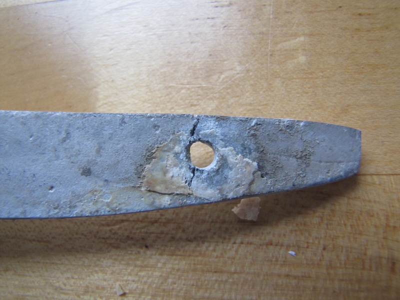

Here's a pic of the problem area plus a full shot of the casting. Thanks for all of the great suggestions so far. Keep em coming.

It appears the crack is on the back and might be able to be welded on the back without it affecting the front. My concern is it's pretty pitted and might not be any good when it's done. You'd have to sand through the pits, then polish.
In my opinion, the crack is a minor problem. Most anyone at all skilled with a tig could fix that.
Then again, the picture may be misleading and it may not be as pitted as it looks.
But, as far as the crack, if it isn't coming through the front it could be welded with any rod and not show, even if it is through it wouldn't make much difference.

The pitting on the casting is relatively minor. I did start on a section of it and it should polish up well. In a perfect world, it would be nice to have them re-cast because there are some scrapes that will not come out. However, I am going to be spending a lot on other items so I need to keep the cost under control. Perhaps in the future I would do it as Phase II of the restoration (unless I get a good deal on it now).
The crack does go to the front, but not as far. I haven't cleaned off the back of the casting, where the photo shows, because I wanted to see what I am going to have to do first.

Looks like it could be soldered easy, Heat with MAPP gas, flux a couple times and flow fill with solder. If ya let it go chances are it would continue to crack. Might be able to pack the crack with JB Weld using a dental tool.

Any competent welder can repair that casting in a jiffy. Ask to see a sample of the welder's work, or get a referral to someone who knows what they are doing. A difference in welding rod color will be very difficult to see on a contoured part like this. The age of the casting is not a problem. Have the screw hole completely filled, and damaged areas ground out & welded. No big deal. Re drill the part for the mounting screw & counter sink the hole for an oval herad screw. Clean it up with a disc sandner and finish sand by hand. Then buff it out & it'll look like new. I have stuff welded all the time - Aluminum is VERY forgiving.
The "Home brazing" stuff is called Durafix. It works OK, but it is not aluminum. It's a zinc alloy of some sort. The part has to be perfectly clean or the rod won't adhere. A small part like that casting could become overheated & melt if not very careful. Also, the durafix metal is much harder than the parent aluminum, and re-shaping the part after brazing with Durafix is very tricky because if this. I use Durafix on some stuff & it works great. But on this part, I would leave this work up to a professional welder.
