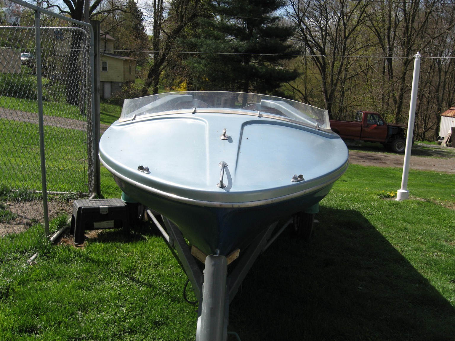

I am new to this site this evening so I thought I'd introduce myself and fish for some tips and tricks for my current project. I live in south central Georgia and I have a 1959 Larson All-American. It was built about 20 miles from me in Nashville, GA and I am the second owner--the original owner pulled it off the factory lot and kept it for 48 years. The pictures are from right before I purchased the boat on its 1979 Gator trailer.
I have the original motor--a 1958 Lark 50hp V-4. I believe it's the "Starflight" (sp?) model as it is dark metallic blue. The motor had never been removed(!).
The boat is the two-seat version and is medium blue over white. I've repainted Interlux Largo Blue over Blu-Glo White, so it's a little darker than the original color but the same paint scheme. (It's very faded in the photos.) Yes, the stripe has been restored! :)
The boat has been totally stripped and the restoration will be somewhat modernized to provide for serious saltwater fishing. The electronics and steering will be modern, and all lights will be LED to minimize power consumption. The trailer has already been rebuilt with all new wheels, hardware, and lights.

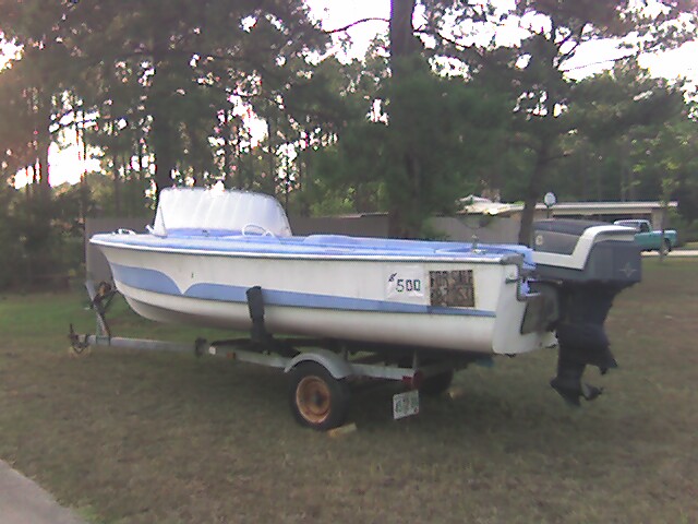

Nice Larson! The decal near the V in te stripe said "All American" The "larson" decal further aft is a diffeent style than the teardrop style that is readily available today. Maybe someone else knows where to find the right style decal for you.

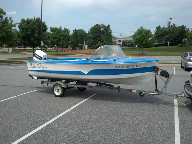

Here she is today! Very nearly finished--just the install of the permanent deck repair to go. (We've been using a temporary cheap plywood deck during repairs. I bought an early 60s windshield from another member here. It has a much stronger frame then the 59 vintage and it mounts forward of the original. That allows for a little more room behind the wheel while keeping the same style. I decided to go with modern LED lighting (including 2-mile fronts) instead of refitting the original fixtures.
This boat actually did not have a decal in the sweepspear "dip." However, in the bright sunlight you can still see the ghost of the rear decals at the stern--even after the restoration and new paint.
The paint was brushed on with my wife and brother doing the final coats. (I did the primer and sanding work.) The color scheme is authentic and the colors are very close to the original medium blue and white. The graphics company my brother works for did the name and custom 4-inch numbers. The name font is "Blackadder" and the numbers are the typeface of the British Royal Navy, including authentic dropshadows.
Two penny coins are epoxied inside the hull, one 1959 and one 2012. The gauges are Faria "Chesapeake" with grey and white faces. My wife picked them and they look perfect. The radio is a compact Standard Horizon with an 8ft silver core Shakespeare antenna.
The motor is a 1984 70hp (the cowling lies!) Johnson. It's mounted bolt-through with 1/4 Lloyd's rated sapele under 1/4 stainless steel plate on each side of the transom. The permanent deck repair is 3/4 okoume.
