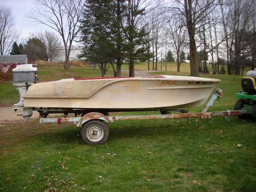

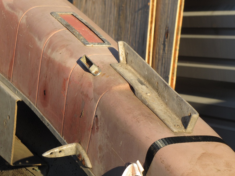

I am going to have to remove a lot of he gelcoat on the topsides of the Glastron. There are many spider and other cracks throughout the hull. I have done some repairs but nothing this extensive. I have a few questions; 1) What are the best tools to use for the job? 2) How do I do areas with small details, such as the "ribs" shown in the picture? 3) What precautions should I take to keep from making big mistakes? 4) What should I do to control dust for health reasons and not coating everything else in the building. and last, but not least, 5) what is the easiest and quickest way to do this?
I have taken some small sections down with a random orbital sander and 40 and 60 grit paper and the cracks go all the way down to the fiberglass.
Thanks in advance for your input.

First of all, be VERY careful. It's highly likely that a lot of the details- like the 'ribs'- are ONLY in the Gel Coat. If you remove it, they will go along with it, and you'll have to replicate the details somehow. The Gel on my Lake N Sea was in terrible shape- No spider cracks, but it was powdery and flaking off in places, so it ALL had to come off. Is yours that bad, other than the cracks? You might be able to get by with a good sanding.

Andy, you are right about the details being only in the gelcoat. They appear to be semi-circular (or close). I'll make a Play Doh mold and see what I can determine. My thought was to use a round file and cut something at least partially into the fiberglass. They only occur on top of the fins, where the stern light(s) go and along side the front seats. I would put a couple of layers of fiberglass behind them when I take the deck off to reinforce what I have removed.

there is a trick that i learned a long time ago to put back a ridge line,that has been sanded off for one reason or another.
1st lay up masking tape on one side only of the spot where the ridge is to be replaced,then keep laying one layer of tape on top of another until you are just a bit higher then you need,then lay down the filler of your choice, before its totaly hard gently lift off all of the layers of tape,it should give you a straight even line of filler,so half of your ridge is done.
then after its all dry,you just lay down your filler on the other side,and there is your ridge,its hard to explain by typing it,i hope its not too hard to understand what i just wrote,lol,it hard for me even.
