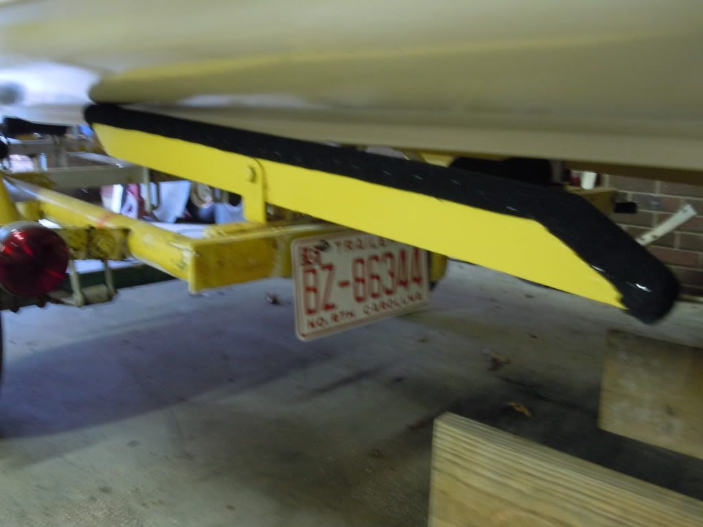

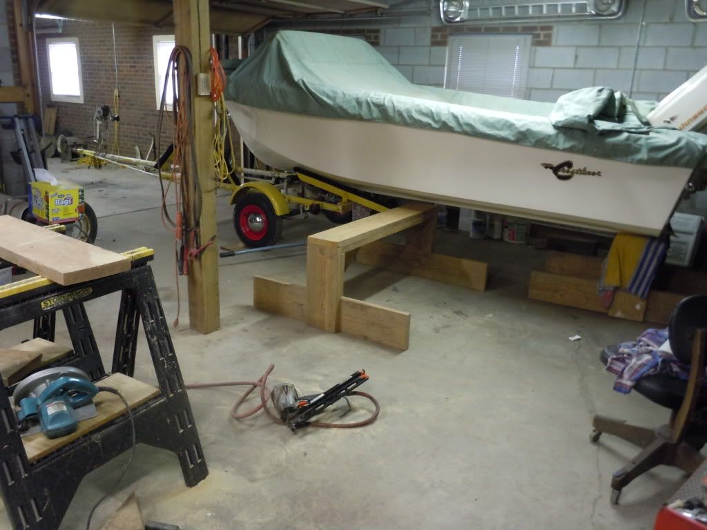

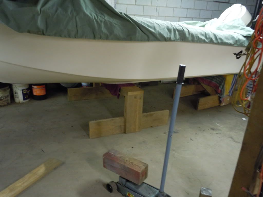

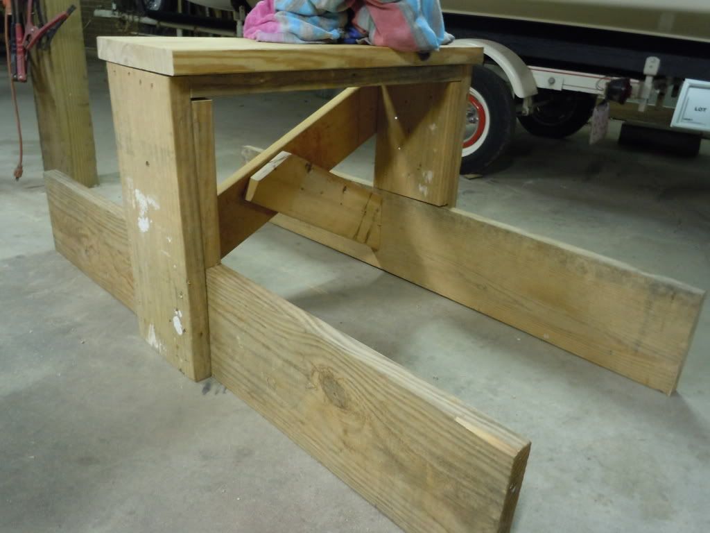

After months of putting it off,I got the back " stern-stand " completed. Give it a test slide today. Worked good for just me pushing it by hand. Now got to figure one to catch the front part of the boat. It seemed solid on the stand when I had the boat half way off the trailer. I want the stand to work for both boats.

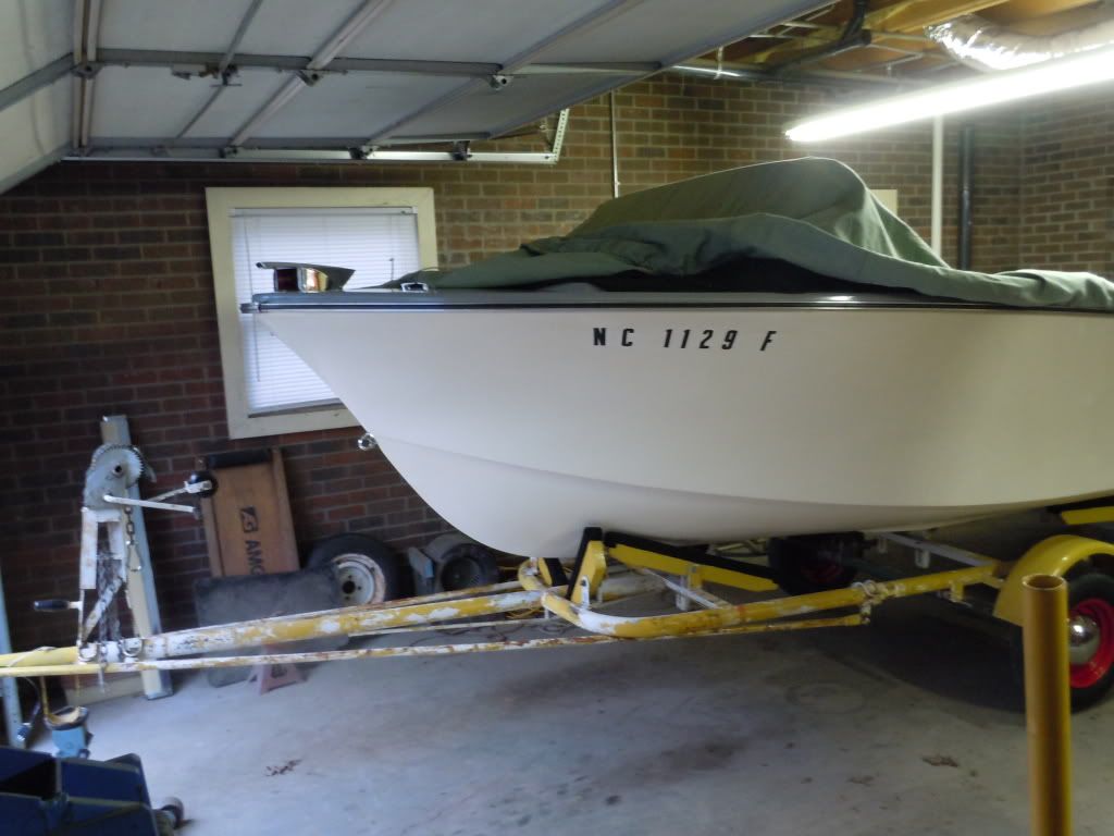

I'm sorry ,Frank. I need to learn to give more info B).I'm going to paint my trailer and finally redo the winch stand.My idea is to have it to where the boat can stay in the basement while I'm doing this.If I can, I'm going to take the boat off the trailer tomorrow and get started.

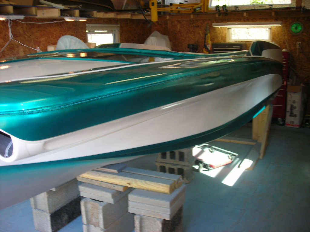

jim great stand,but a word of caution from a lesson i learned the hard way,lol,make sure you wedge the stern so it doesnt rock,i didnt on the sunray and when i leaned out of the boat to reach for a tool beside the boat i almost rolled it over,i thought that it might rock,but didnt think it would roll,lol.
as for the front of the hull i jacked up the boat stacked some cement blocks on each side then layed 2 treated land scape timbers across it to hold the boat it worked well,in the back of the 1st pic you can kind of see some of the rack i built to hold the stern,my garage floor is wood so i screwed it to the floor so the boat could not move.john in this pic you can se i also supported the center of the keel with bloocks ,with wood on top of them

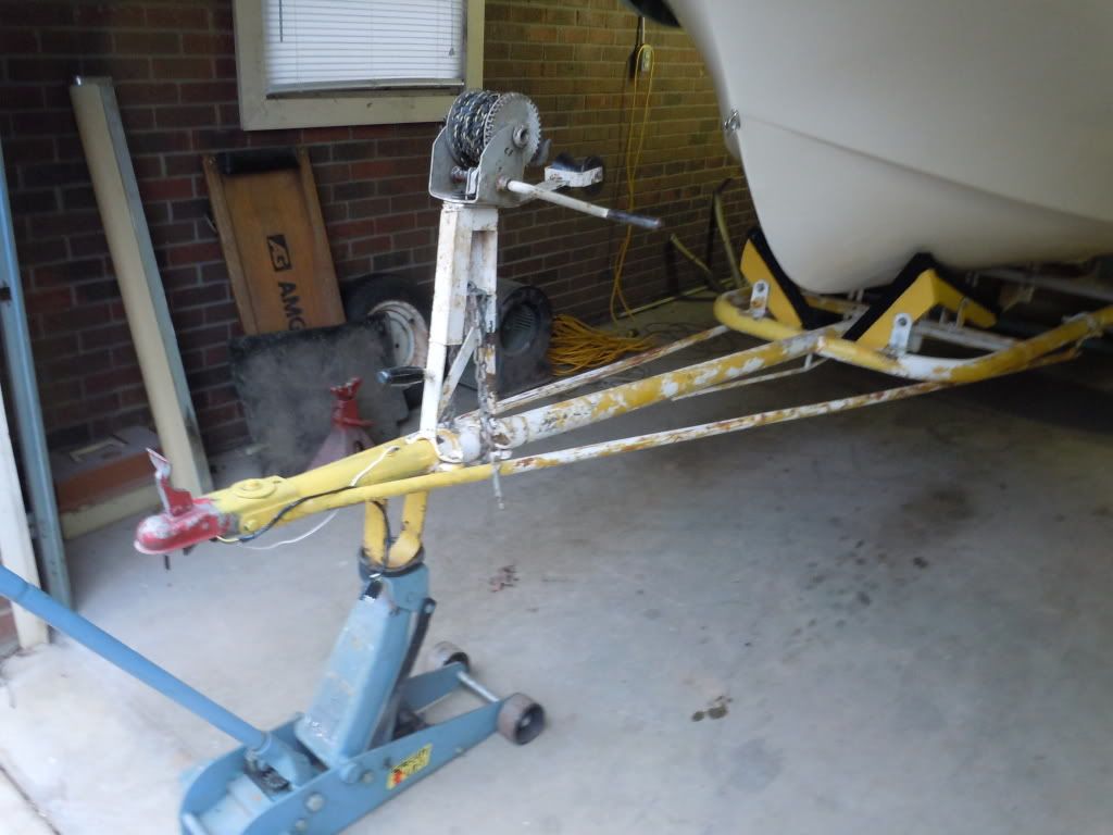

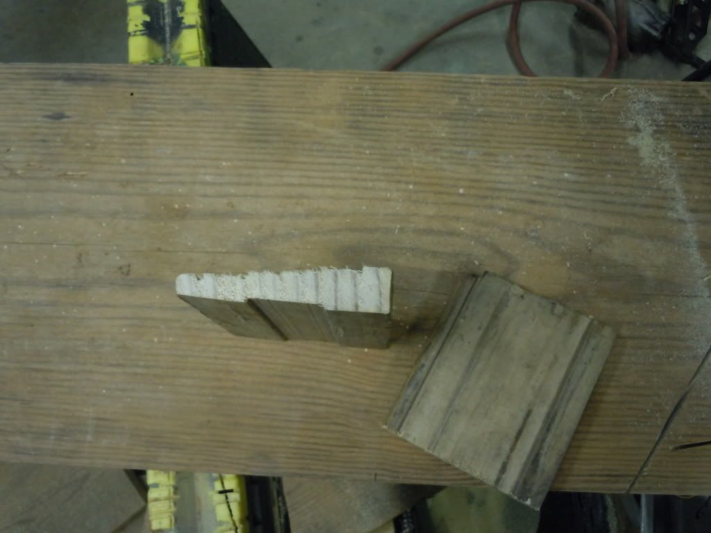

  • Karma: 60

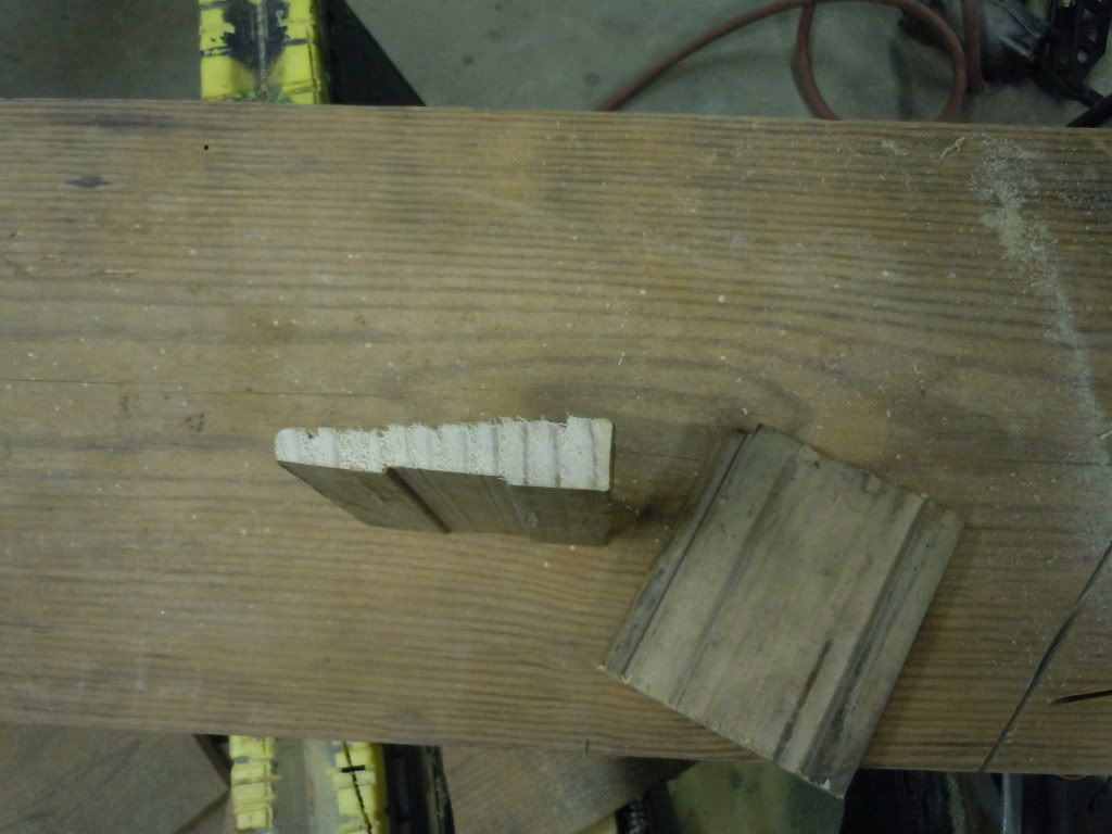

Thanks for the tip, John. Any other time,I would like some rock & roll out here in the country lol.I found some scrap door casing that worked good for wedges.I was trying to do it without the use of my cherry picker cause the bow light was too close to the garage door and I couldn't get the end of the lift high enough to pick the bow up. I got it off easy enough. I just used the two rear rollers on the trailer and a jack under the rear roller frame to lift the bow up to the second stand's height. Both stands are 24" off the floor. I think they will work for the aristo as well with some extra side shims to keep her from rocky rollin' ;)

  • Karma: 60
Thanks guys, yes Mark, when It was perched on the last two trailer rollers, I was having visions of a busted bow on the floor.lol You can bet I kept the trailer wheels scotched :laugh: . I built the last stand while the boat was on the last two rollers of the trailer so I could measure it. But it really worked well especially for just one person doing it.
