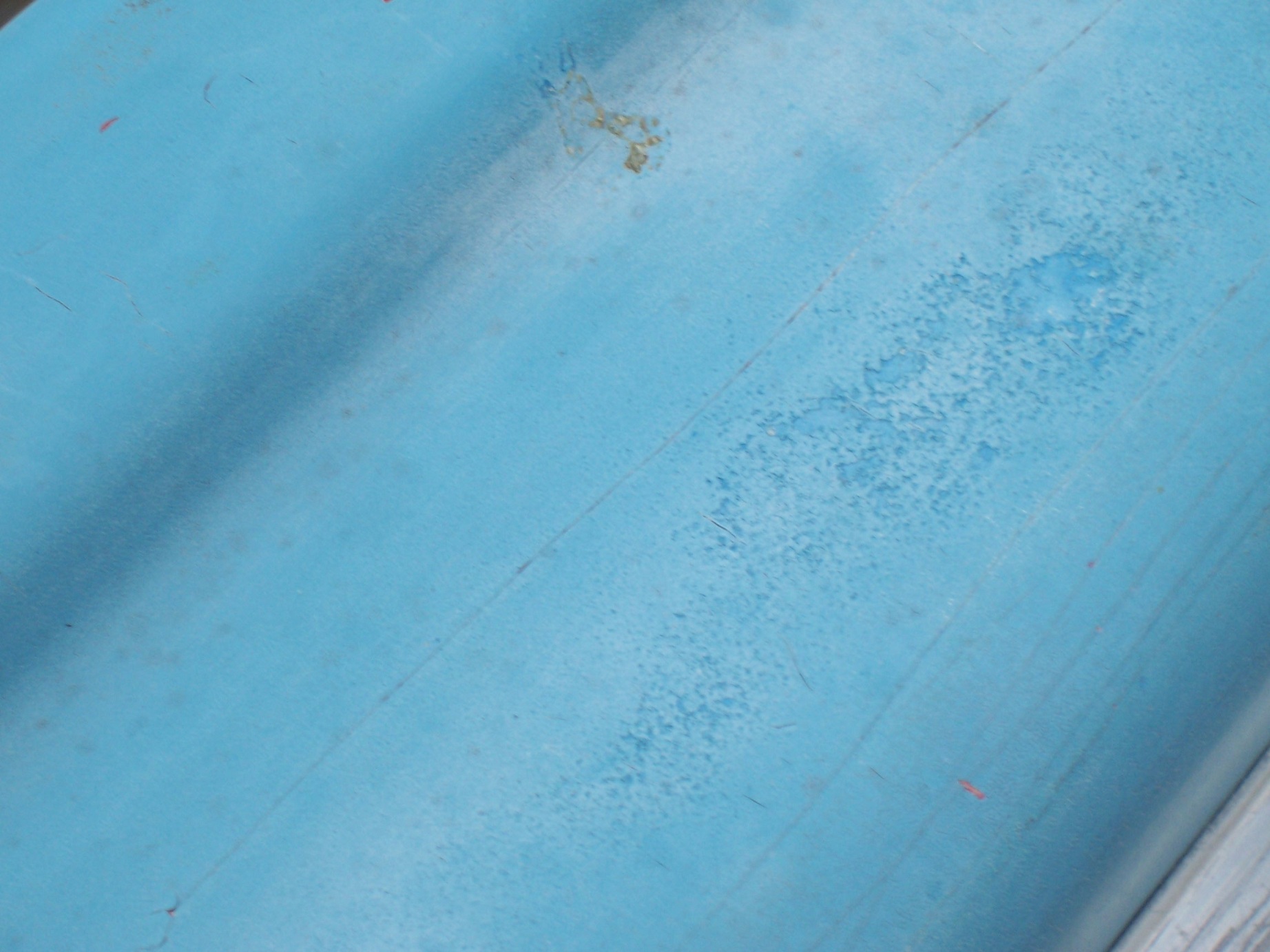

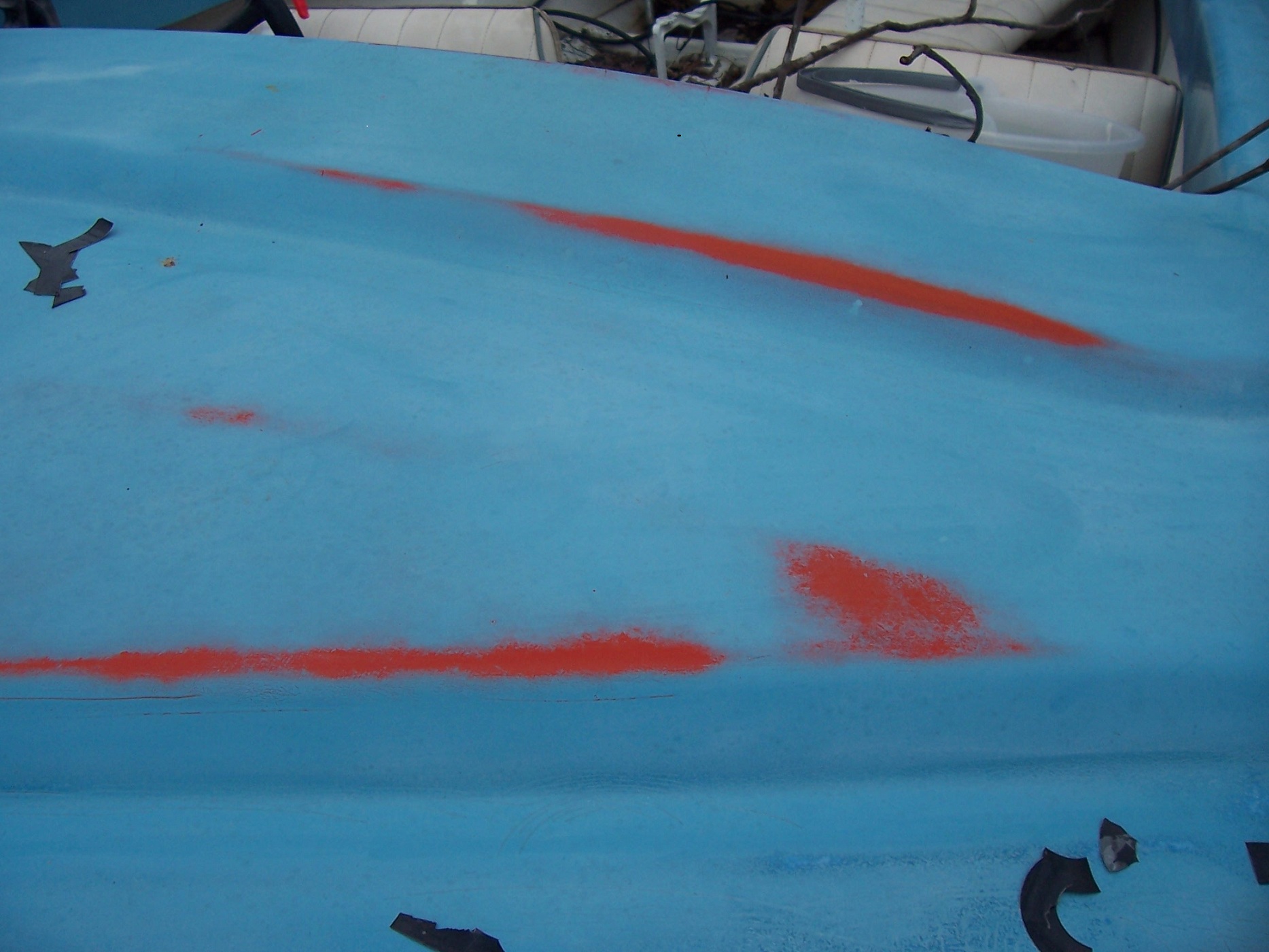

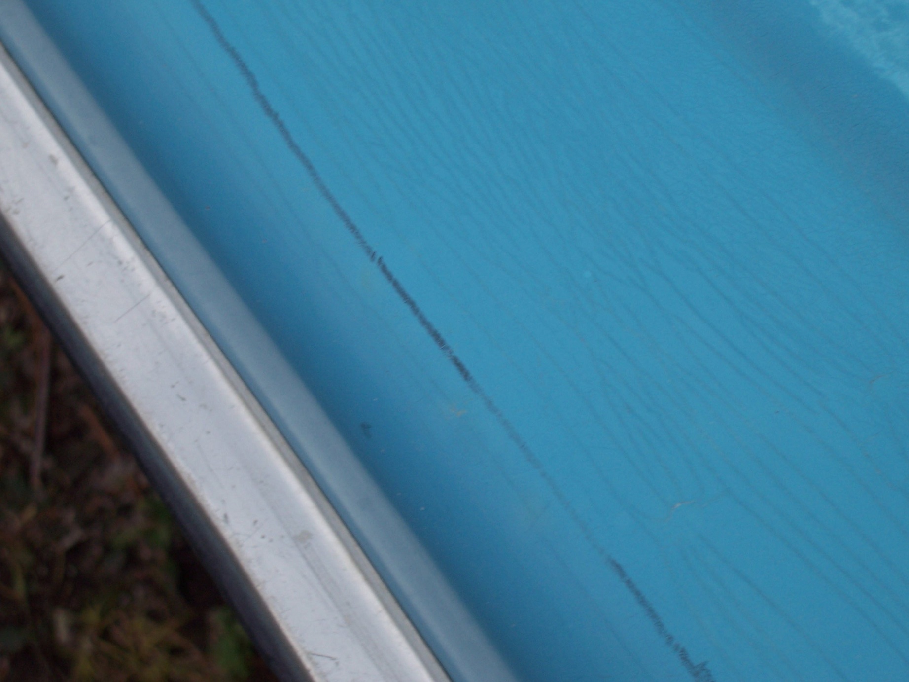

Thanks all for your input, and help. I took a couple of pics of the red and the cracking. Over all she is in good shape, just a bit of weather wear. I am not refurbishing for resale, will keep her for a reason to get out. I was thinking painting as a way to protect from future weather. I did finally find a prop, an original mercury for the Mark 78AE. Should give a speed at 5500 rpm of 45. Will load pics, and thanks again

hi az,nice to meet you,from the pics,it "looks" like your boat was originally red,and was painted blue at sometime,but sometimes its still hard to tell even with pics.
i would try to do what bob said on a small spot ,just to see if the red buffs out,john

I'd be willing to bet, based on the photos, that is paint over red Gel-Coat... Wether you choose to gelcoat or paint, I'd take it ALL off, to avoid compatibility issues down the line. There is nothing worse than putting on a nice coat of paint, only to find it bubbling and peeling later.
