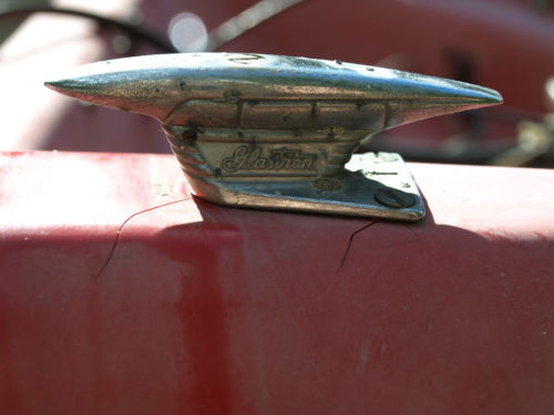

JB: Your search for decent Glastron factory cleats is a tough one. While cool, they were of poor quality when new. The plater I use has threatened to throw me in his tank if I ever bring in a pitted die-cast zinc "artifact" for chroming. Unless your budget includes $1000 for reproducing the torpedoes, or you are entering top flight shows, grab some brand new, Perko vintage style rocket cleats for less than $40 a set, including chocks - and call it good. PS: our dog was recovered within a minute thanks to a fantastic doggie PFD, and jet boat maneuverability.
Since we use our boat quite often, I didn't want to see myself or a child be "gutted" by the rocket cleats, so we chose some sleek stainless pop-ups that fit the look and work great.
The only negative: people are fascinated by the pop-up feature, and can't help but play with them.
