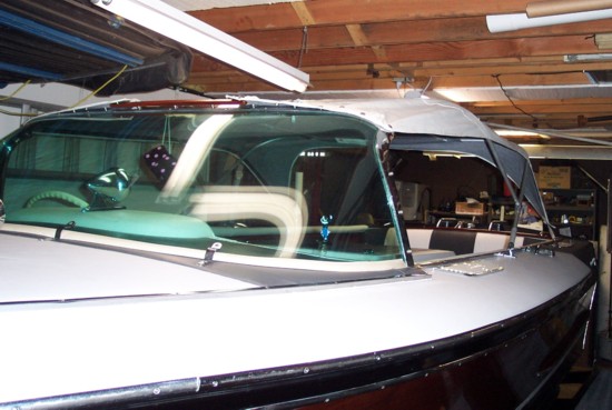

I need to get some of the rubber stuff that goes under a windshield and conforms to the top deck. Can't think of the name for it now but here is a picture of what I am refering to. Under the windshield of my Sabre.

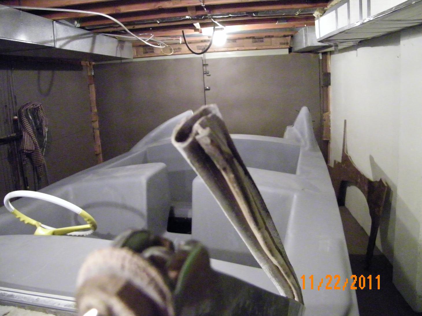

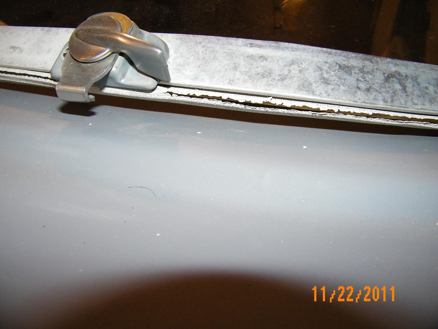

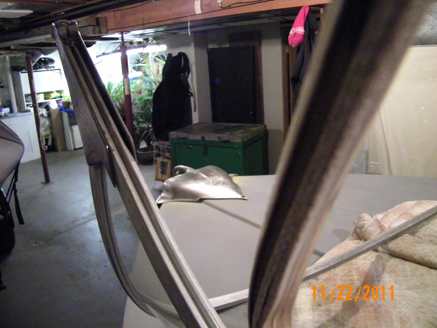

Split, Here are pictures of what I need. If you have something that will fit mail me. It would have to be thick enough to "fill" the small gap between the aluminum frame and deck. There is a groove in the bottom frame that the rubber wedges into.
Neil, how thick is the bottom seal on your window?
Here's the gap that is present and the rotten seal.
The groove in the bottom of the frame.
The shape of the seal.

I recently got my window gasket from Wefco Rubber. You can check to see if they have your exact gasket just by sending them a cross section of your gasket. I sliced off a small piece from the end of my gasket, colored it in with some black sharpie marker ink, then pressed it to some white paper (like an ink pad). Then I faxed it to Wefco with a little note telling them what I needed it for. A couple hours later they faxed me a sheet with about 10-15 different cross sections that were similar to mine. Sure enough, they had the identical cross section. It was something like $3 or $4 a foot.
