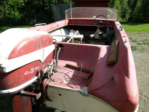

Kind of, it's paid for, just not picked up until Wed @noon..... B)
Needs a floor & windshield, but is intact, has no odd/extra holes in the deck, hull or dash! Can't wait to dig in & work on it over the winter. Trying to source poly & glass out of Pittsburgh. Cleaning out a space in the garage for it tonight! Shopping online for parts & pieces. Don't tell the warden (wife :cheer:)but I maybe more anxious then I was before the wedding. Of course, been together almost 20yrs, married for 9, so there were no wedding night surprises!:ohmy:
More pix to follow, pre-demo......

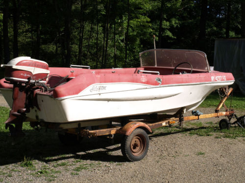

Sweet boat man! Here are some pics of mine I finished this summer. I did modify some things to make the hull better because of some design flaws for this model. Gotta find a correct windshield for mine too. Have fun with it! Looks like a good candidate for a resto.

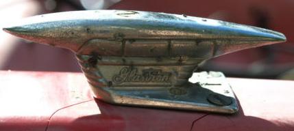

Made it home with her. Looking to have molds made & repop the deck cleats:
I looked up metal casting, & I'm not sure how to best cast these. Lost wax, sand cast, latex/silicon molds w/ plaster duplicates to make actual casting molds? ..Suggestions anyone???
Re:1960 Glastron FireFlite has a new home! 13 years 6 months ago #51145
Latex/Silicon mold and then make your waxes. Investment Casting (lost wax) would work well. I've worked at 5 different Investment Foundries, we did all kinds of stuff, art etc. Not cheap but it makes a very pretty casting.
The new parts will be about 3% smaller if you use the original as a pattern.

The latex/Silicon mold and wax plug I am confident I could pull off. It's It's the metal casting I'm not so sure about.....Investment Foundries, hmm let me spend some surf time......The pitting may require some attention after I get it cleaned up to keep from transferring pits to the new castings. I may start to wet sand the none matching one this weekend & see where it takes me. I'd really like to make the forward foot match the rear foot w/ 2 screw eyes too. But I guess the top through bolt keeps the torpedo on the base portion.....White 'pot' metal I figure? Spent some time researching chrome options too. May end up powder coating them, same as headers or manifolds..............

Get them cast in aluminum or stainless steel, the Zinc based ones are crap. Easy to die cast but not great material.
Talk to your local foundry or if you really want help with this I can steer you in the right direction. My Orthopedic Company owns an Investment Foundry in Michigan. I still know people that do artsie type stuff around Detroit.
Another option is to send them out for replating. Not cheap either. You couild always sandblast/strip and JB Weld the pitted areas. Then powdercoat or rattle can them. It depends on how bad$$ you want to look original. I'm going to JB Weld on my 1970 Starcraft clam shells, they are Zinc also, then rattle can. They have some cool paints out there that are textured.
Good luck.

John: got email, thanks for reply, timing was fine. I got it as I started removing some trim & some of the floor decking today. You didn't however comment about the pedal car project. Wish you were closer, I'd love to see some of your projects up close & pick your brain some more
Don: looks like I'll probably do my best to clean them up & have them powder coated. I've got a Singer sewing machine base for a console table (I don't even know what that means, 'cause it ain't gonna have a console tv on it.... :unsure: ) I just know that's what the warden called it. :) So it may not be too bad to add a few odds & ends to my order, 4 slat bases to support the ends of the bows holding up the boat cover, bow light, deck cleat(s) [still hope to get another!!], Glastron logo from port & starboard stern end, and the dash plaque, . Singer base: black; Trim Chrome! :cheer:

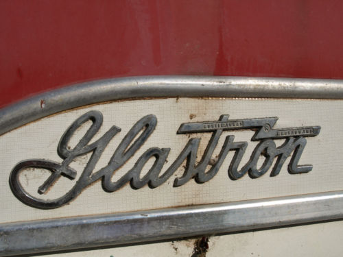

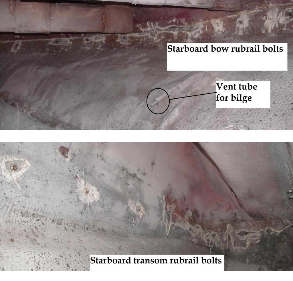

I managed to snap 1 of 2 back pins holding my Glastron dash emblem on. :angry:
Ok now the good news: floor is so rotten it almost all comes up by hand! :huh: 3-6 inch strip at hull side, 12 inches at the stern (battery & gas tank tray) corners around main seat bases (still original base, new trashed seats) and a little extra glass & resin on top of stringers, but no PLY! :woohoo:
It appears to all be original, no repairs, even some tabbing under the bow deck (cardboard spacers to prevent hard spots (??)) that might look like a repair, exactly matches the tabbing @ the seam between upper & lower hull 1/2's! The all aluminum rub rail is through bolted, and bolt ends & nuts are buried in glass. The really didn't want it to come apart at the hull joint. So that will be an absolutely zero fun factor! :P
That contrasts sharply with how aggressive a weave they left exposed on the inside across the floor & up to the gunnel. Floor deck is a smaller weave but the waffle still shows clearly under the white, gray & black deck flecking. The waffle print is also clearly visible on the exterior, but i think that may have been from sanding & or buffing the gelcoat over a long period....But it does make me think I may need to glass the interior at least once, even the chine seems to deflect easily, and it still has a little floor ribbing left attached. And the gel-coat on the topsides is toast, cracked way more then I thought, stress cracks at corners & attachments points. Photos will be shortly, let me know, maybe I am just overly concerned.
The hull joint at the transom isn't going to be a problem when I go to pull the topside off. The transom is GONE! But fiberglass skin is still intact so there shouldn't be any problems replacing transom. Just a bummer no patterns. Gotta go take a shower! Then maybe lunch, I'm hungry....

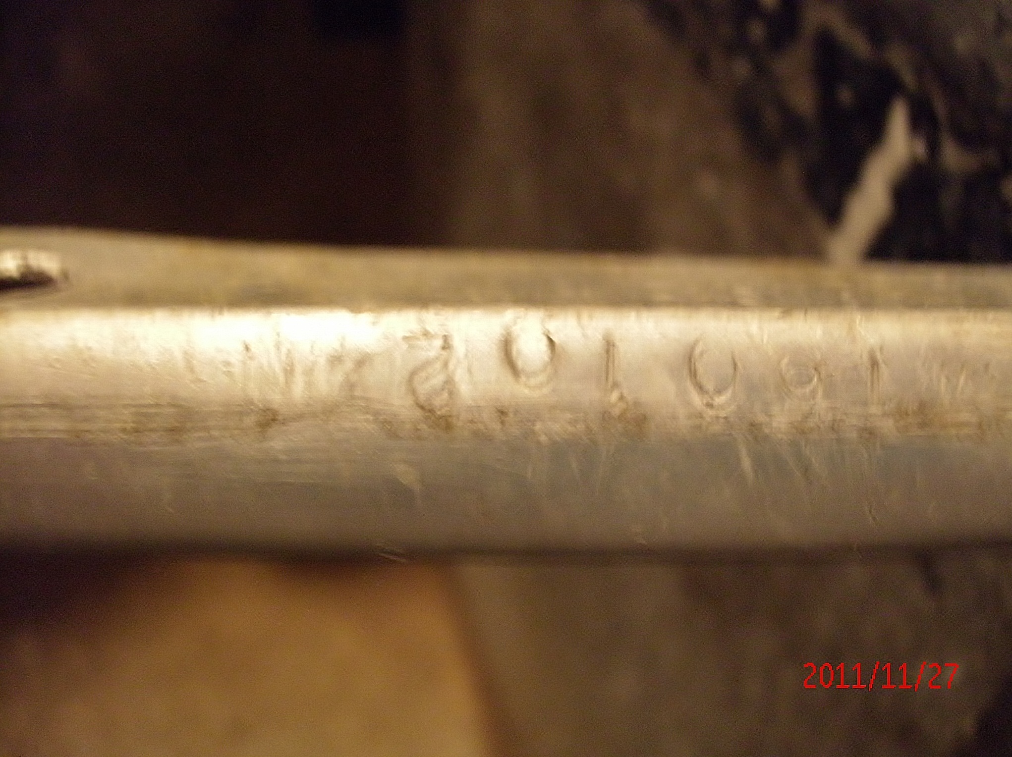

I found this number on the transom trim when I pulled the motor today. HIN??? M160102

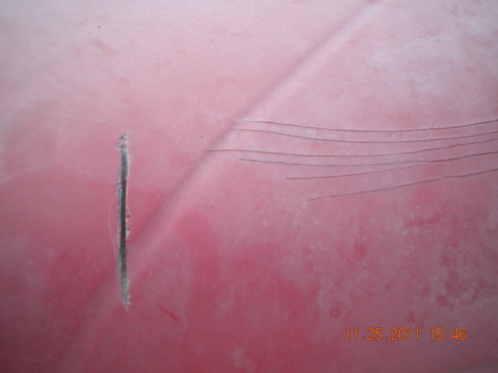

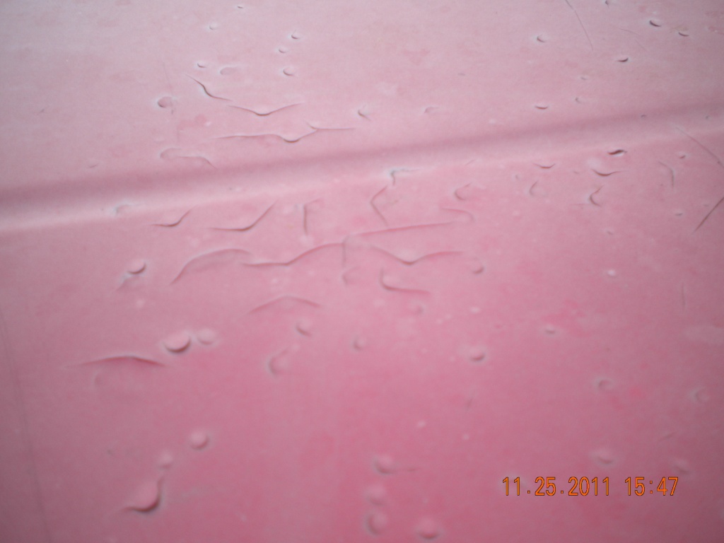

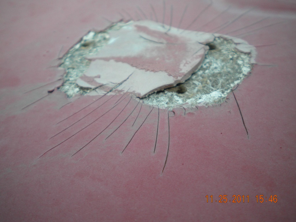

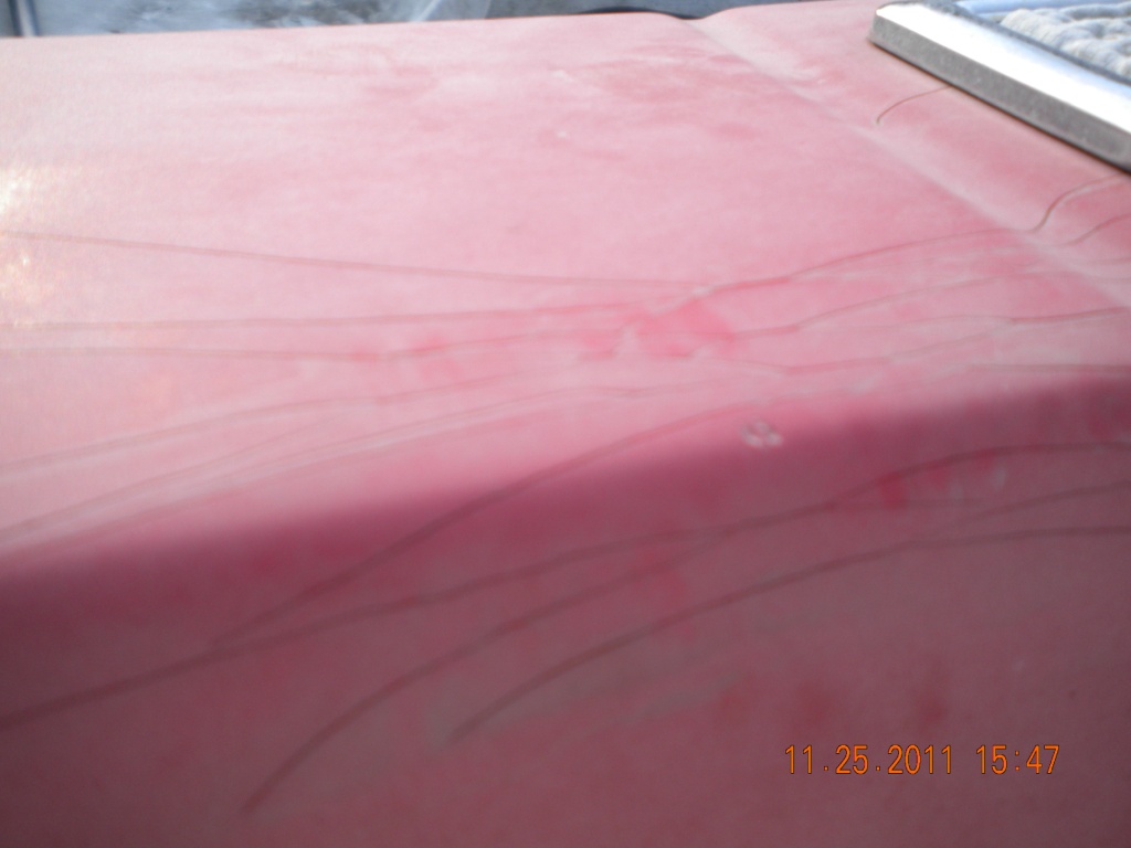

I forgot, do all the stress cracks in the gelcoat mean the whole deck needs to be glassed over w/ a layer of 1.5oz? 2 layers? Heavier? Most of the glass looks intact through the cracks, so 'just' grind & patch w/ CSM, feather, fair & primer?

The number on the transom trim is the hull number, although the M is interesting. MY theory on that is built in January 1960 (1 60) and is boat 102 of some production run. All of the numbers I have collected seem to fit into that pattern. Never seen a letter prefix, though.
I was lucky, the dash emblem on my 59 Seaflite was held on by screws.

I have a lot of cracking to take care of on the deck of my boat. I found that the cracking only extends to the first layer of fiberglass (so far) and I can get down to that with 40 or 60 grit sandpaper on an orbital sander. I would think that would be less destructive than a grinder. Easier to maintain existing shapes. Do that then fill, feather and fair.

My biggest concern is maintaining all the detailing on the deck, & fixing the cracking. 1 gunnel is cracked in so many areas there may be no way to remove cracks & maintain enough reference to recreate the decks details. I guess I'll need to work it as 3 separate areas... Outer gunnel, inner gunnel & top of gunnel, fixing the top 1st & using sides for reference. Then once the top is repaired, work the inner & outer sides, pulling the lines down from the top. I am concerned that not fixing an area for inside across the top & down the other side as a single area, that the corner may not be repaired sufficiently. For now I'm working on the floor & transom & that will be enough for now...... :S

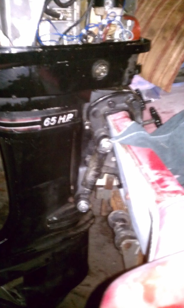

Hung the 'new' 650 Thunderbolt on her transom this week. Dang near killer me! WOW that thing is heavy! Also signed in & registered the boat in Wisconsin. Couldn't have been easier..... Should make getting registration & title easier in WV. The trailer will be easy, just want to get the boat sorted out first........

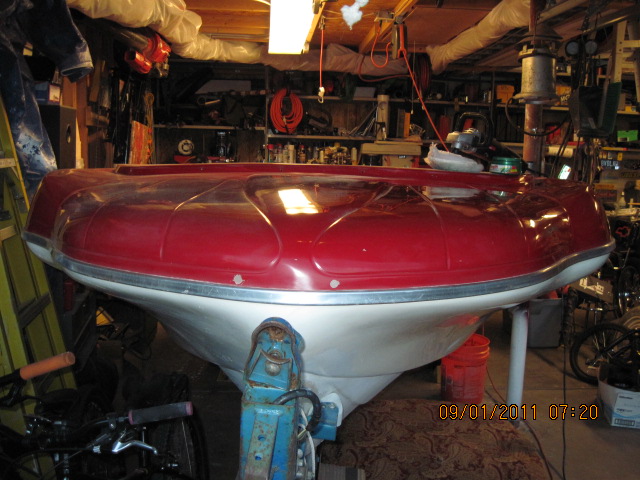

Well, not getting as much done as I hoped. Slowly getting the edge of the deck ground smooth at the edge @ the hull. Have most of the transom out, and have started uncovering the rubrail bolts. They are buried in fiberglass. Then I need to finish removing the 'glass covering the cap/hull joint.
Pix:
