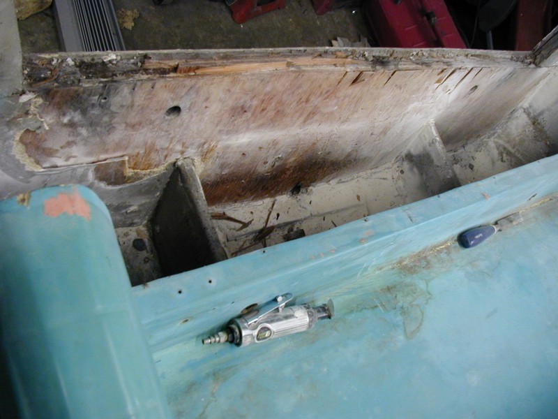

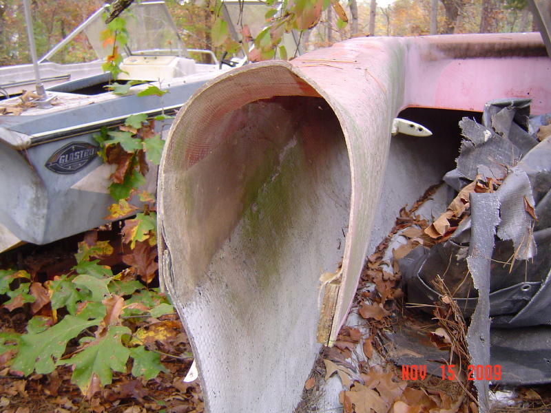

This is not something that is going to happen next week (too many other pre-cold weather projects). I'm preparing for the future. I am going to take the trailer (with boat on it) up to get registered Wednesday, so if I don't get pictures before then. I did a couple of quick ones. I tries turning the screws on the rubrail; they turned, but acted more like bolts (turned, but didn't unscrew)

its hard to tell with the rubrail track on,but it "looks" like a shoe box joint,i hhave never worked on a glastron,so thats just a guess.
it looks like you have a 2 man job taking off th track for the rubrail,one inside and one outside,after all the bolts are out and you have as much fiberglass cloth cut (try the multitool with the scraper blade 1st to get under it)then try to see if it will lift off any at all,you will probably have the steering pulleys to take off.
it has been my experiance that alot of boat makers put the pulleys were the joint is because its doubled there,im not sure about glastron,though,so keep the pics coming,so we know for sure what you are dealing with,john

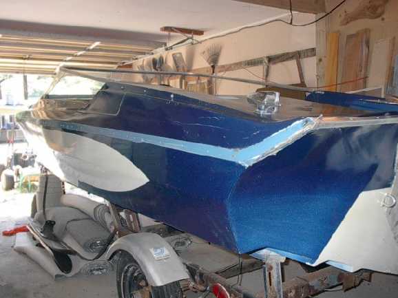

It looks like this is a shoe box joint. I think maybe some of the bolts may be covered by a stray piece of fiberglass cloth with resin. That shroud could be cut off easily. I'm just concerned that they may have used steel nuts on stainless screws, so they may need to be cut off. I'll try to crawl in there this weekend and see what is really going on.
The front steering pulleys are attached right around the seam. The rear pulleys are attached to the transom.
Newsflash!!! Just got this pic from someone on the classic Glastron site. Shows the lap perfectly

Re:Removing the deck 14 years 2 months ago #50254
  • Andgott
  • Andgott's Avatar
  • Posts: 1245
  • Karma: 72
That photo will make it a LOT easier to tell what's going on!!
Looks like you'll have to cut that area that's glassed- Something of a pain, but it COULD be worse- At least its not glassed all the way around!!
My Lake N Sea had bronze screws, with steel nuts, holding the rub rail on... And all the deck hardware was attached in the same way. Some of the nuts had rusted away years ago, but the vast majority of them had rusted and 'welded' themselves to the machine screws. I had to cut, grind, drill... It was not fun.
That cut in the fins looks like an excellent candidate for an Oscillating tool!!

OK I'm back, sorry business has been crazy lately.
Yes it is a shoe box. The rub rail is held on by bolts & nuts. They're brass & will come off easily, catch is they're behind the glass strip. I was able to pry of most of the glass, the rest I cut with a die grinder & wheel. Sorry, but it is glassed all the way around. The bow is a real challenge. Hope you a skinny guy like me!!

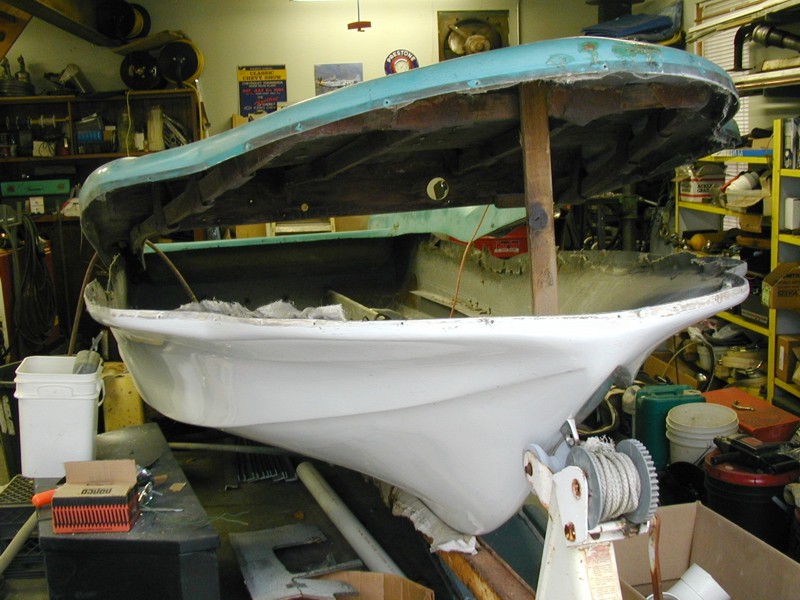

Once you have removed all the rub rail, lift the front of the deck as in the the last pic. The splash well, were the motor clamps on is glassed to the transom. With the deck raised you can chisel it free from the transom. I make it sound easy, but it's a bitch of a job. Before you remove the deck, put a straight edge on the deck, bow to center of windshield. It's probably sagged. If so, that's another topic.

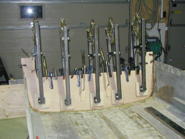

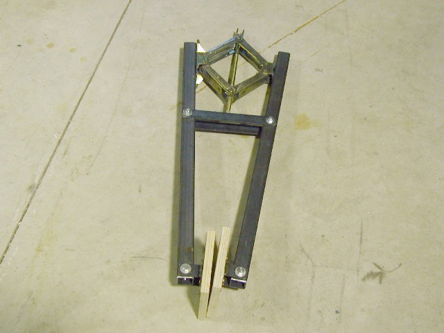

I'm real interested in the clamps you have on the transom. I have been planning to make some soon and would love to see more of them.
Are they homemade or bought? Would you have any pictures of them?
Thanks,
Gene
Re:Removing the deck 14 years 1 month ago #50733
if they are homemade,its very ingenous,very smart idea to use car/motor home jacks,impressive,john
Re:Removing the deck 14 years 1 month ago #50735
I fabricated them myself. $5 scrap yard car jacks & some square tube & flat bar Worked great
Cheers
Bill
Re:Removing the deck 14 years 1 month ago #50736
You must have been talking to my wife about those clamps. She was trying to tell me how to make some last yr and I couldn't figure out why she kept saying to use a car jack to make them. She finnaly kinda drew one out for me and tonight I showed her your post and she said that they where just the same as she was trying to tell me about. I guess I should have listened to her then, the back of my head hurts now. I think i am gonna build afew of them now. Thanks, Skip.

Nice clamps!! I need to make some like that. While 2 x 4's have done the job in the past, those would make it EASY!

Those scissors jacks are handy and cheap.I use them in pairs to pull lower units apart with some 1/2" plate that I drilled for the purpose.They should be a part of everyones tool crib.
