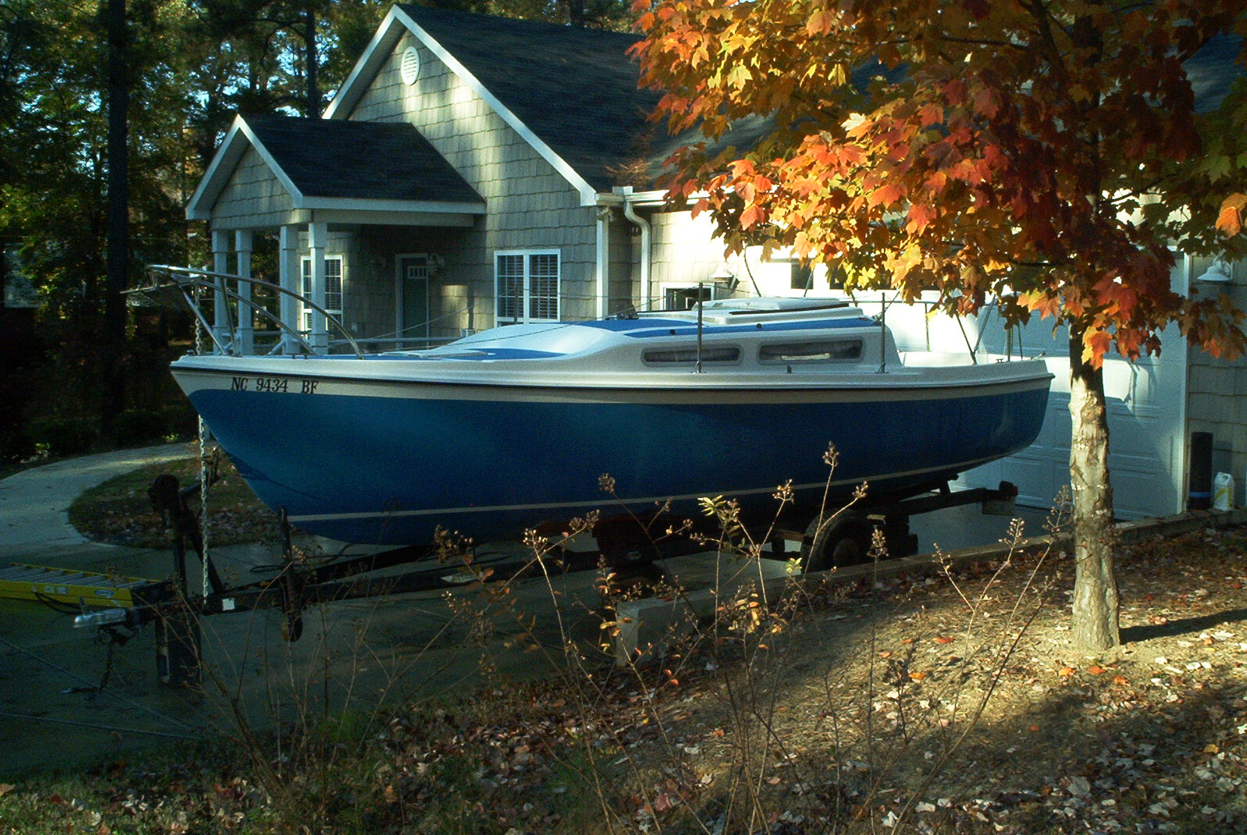

I have a project boat slowly coming along- but I'm not sure you will like it. It's not the first time it's been done, but there are not many out there.
I have a 1977 MacGregor 25' sailboat that I am converting into an economical cruiser. There is really not much work involved, the boat and trailer were very solid, but the mast was bent. I got it for $250, and after selling the mast, sails, rigging, rudder, and motor mount, it is now free. I found a 2001 Evinrude 8 HP 4 stroke that was only used for one weekend and put away, bought it for $350. Sometimes my little Craigslist habit pays off.
This boat has a 600 lb swing keel that I will fix in the up position, as such it only draws 16". So far I have built a motor well for the outboard and begun to reinforce the cabin roof where the original plywood core was weak. The rest of the work involves mostly minor repairs, cleaning, and painting. (I'll be rolling and tipping as I learned here.) One neat feature is the 4' x 4' "pop top" on the cabin roof that allows standing headroom.
So, I will have a 25' econo-cruiser that sips maybe a half-gallon per hour, sleeps 5, has a potty for the wife, and a rudimentary galley- for under $1000 total. The most expensive component will be a 6' wide x 8' long bimini over the cockpit.
I know this is not a classic in any sense, and I'll post in the disco section if that is desired, or not at all if folks think this is stupid. I got a lot of info from the MacGregor forums, but made the mistake of mentioning what I was doing- that was dropping a turd in the punchbowl, believe me! But it is a cheap way for my and the family to get on the lake, a river or two, and periodically the ICW. Besides, it's not rare or anything, it would take thousands to get it in sailing condition... and sailing is way too much like work!!
This pic is soon after I got it home and powerwashed it.

Re:I'm back, have a new el cheapo project- PHOTOS 14 years 10 months ago #50203
sat: I love that fuel economy projection!! The motor only came with a 3-gallon tank, but that's a lot of cruising.
OOPS- My pics are too big... I set up a Photobucket album: s1124.photobucket.com/albums/l572/chrisinraleigh/
Here are some pics I took today, some older. Several show my outdoor workshop with the tarp roof. I'm fixing to rework the "roof" to lower it some, since with the leaves falling it is more visible. But the fence keeps the boat from looking sketchy to the neighbors. I think the boat has nice lines, and will not look too strange as a powerboat.
Several pics of the motor well. The old motor mount would have me reaching way over the edge to steer (originally you would use the rudder), my motor was too heavy, plus I couldn't tilt the motor up. This arrangement is very comfortable to tiller-steer the motor, and the low cabin is easy to see over sitting down. And yes, once the skillsaw comes out, it's the point of no return!
Pic of the cabin roof reinforcement. The mast post stays, since the wall dividing the dinette from the head attaches to it. I fitted the boards to the roof and epoxied them in, and will have a layer of 1/4" plywood epoxied between them. You'll be able to dance up there.
The trailer bunks were shot, several pics of that project.
One shot of the day it came home, all nasty. Some interior pics.
Finally a shot of the keel- you see it is almost 12" deep, and 5 feet long, but kind of blunt, not streamlined at all.
Other pics as well...
