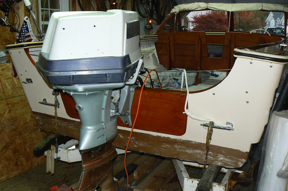

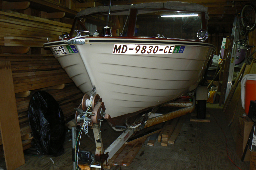

Ok, so I needed to winterize the boat finally and make a stand for the Merc and a hoist to get the new Rudes out of the truck.
Here's the Clipper in her winter storage.
Still have to drain the lower unit and refill. Hoping there's no water in there! :dry:

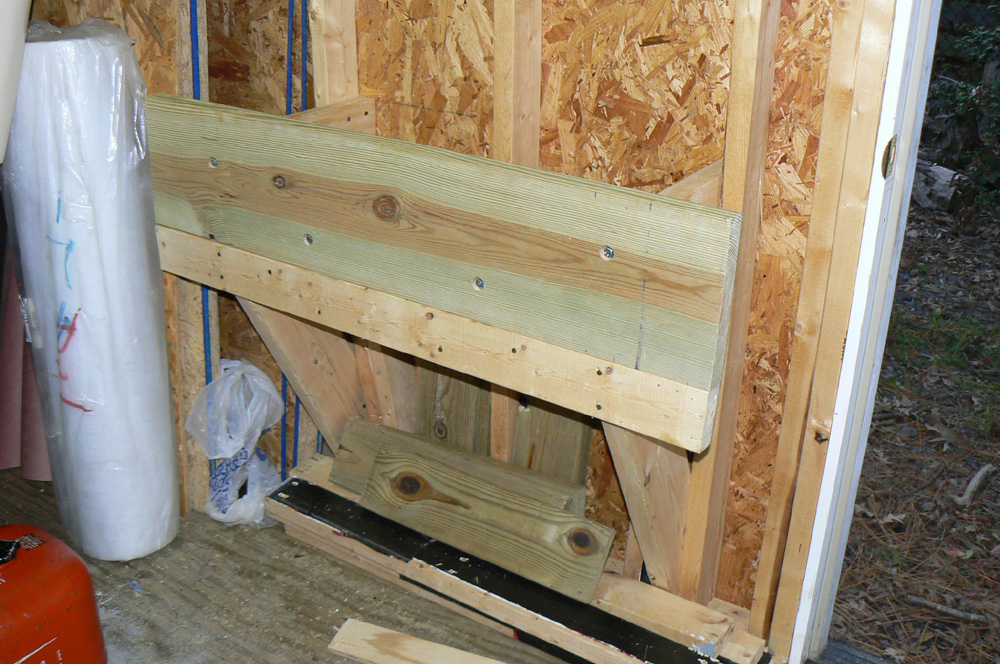

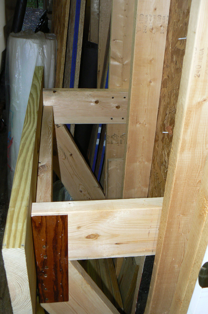

So I needed to finally get those Rudes out of the truck bed, after sitting in there for two weeks! I needed a stand and had one but the MErc was sitting on it, so I built one in the shed to hold motors waiting for overhaul.
Made it out of 2"x6"'s and a 2"x12" I had laying around. Used Gorilla Glue, biscuits and some nails.
New home for the Merc

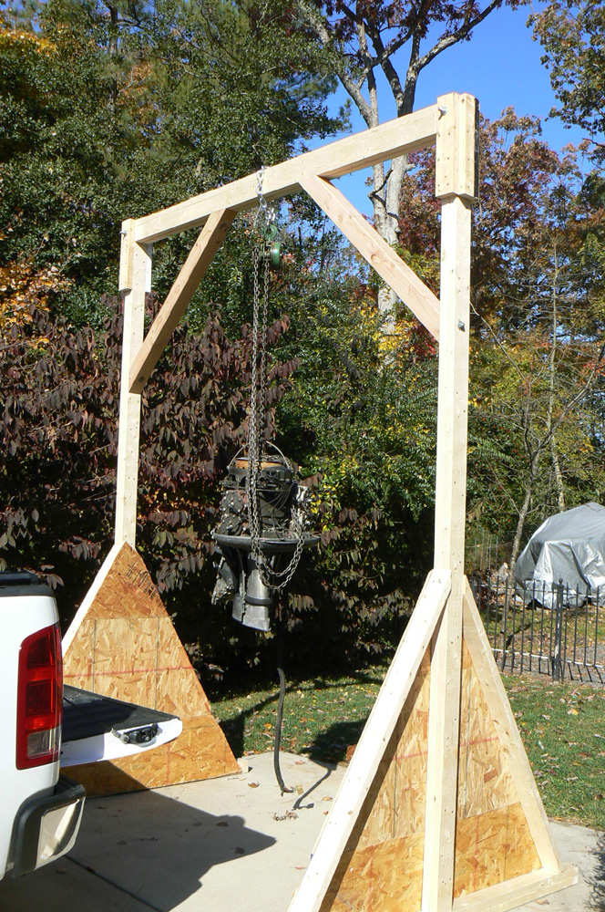

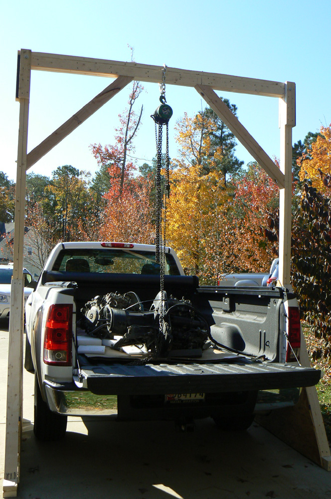

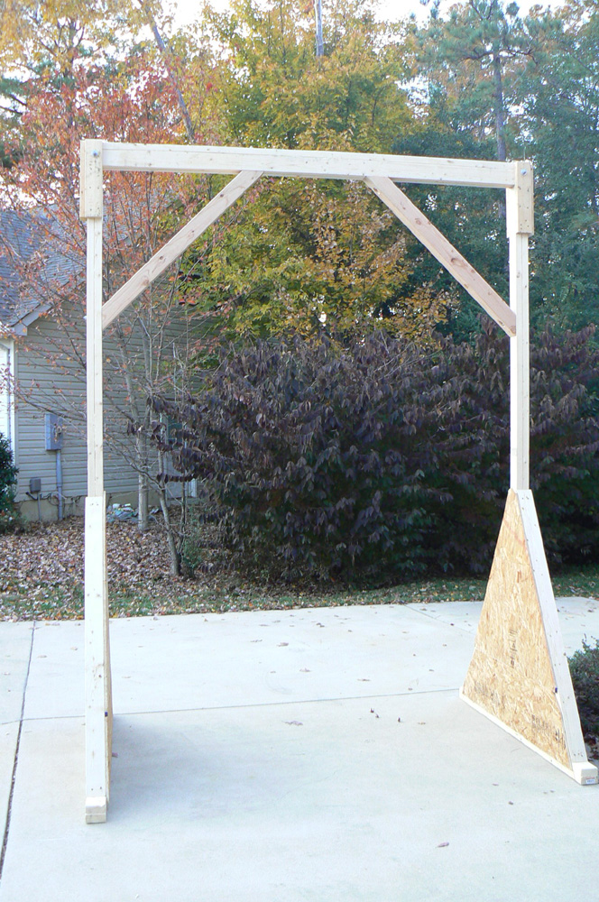

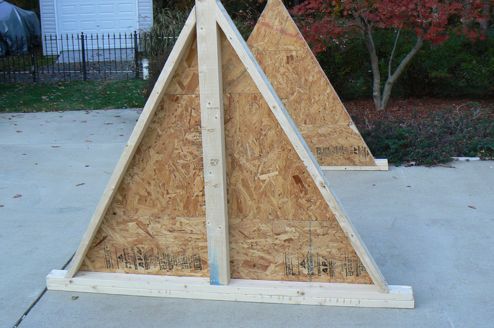

Ok, so mobile engine stand is open so now I need a hoist to get the motors out of the truck bed. Also need one that woould pull the 283 V8 out of the Century Resorter when it was time. The $99 1 ton engine hoist at Harbor freight wasn't going to be long enough and I didn't want to spend the $150 for the 2 ton when on sale. I already had a 1/2 ton chain fall that my dad had so I built one out of 2"x4"'s. Cost me about $70 including the galvanized bolts, washers and nuts. Here are the pics

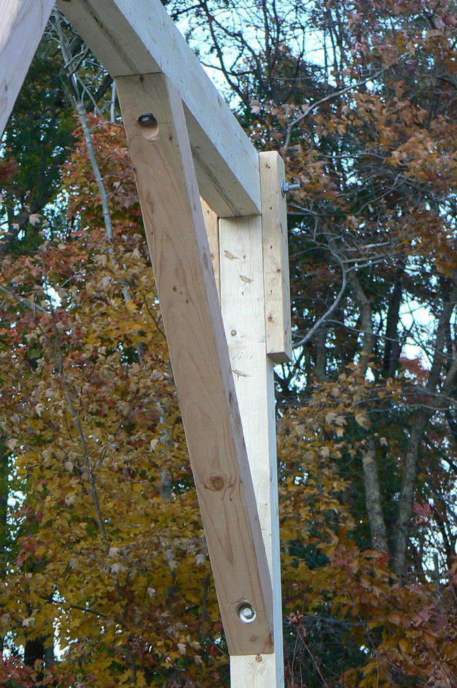

Nailed 2"x4" 10' long together for the uprights. Nailed 2"x4" 8'together with 1/2" thick plywood between the 2"x4"'s and then a 2"x4" acorss the top to make a 2"x6". All glued and nailed, much stronger than a 4"x4" or 4"x6", the way it's setup and cheaper. Did use 4"x4"'s for the braces as you can see. Didn't want to drill through 2 2"x4"'s nailed together across the 45 degree angles, so strength there. 4"x4" works best for that. The wafer board was glued and nailed to the support 2"x4"'s for lateral stability on the uprights.

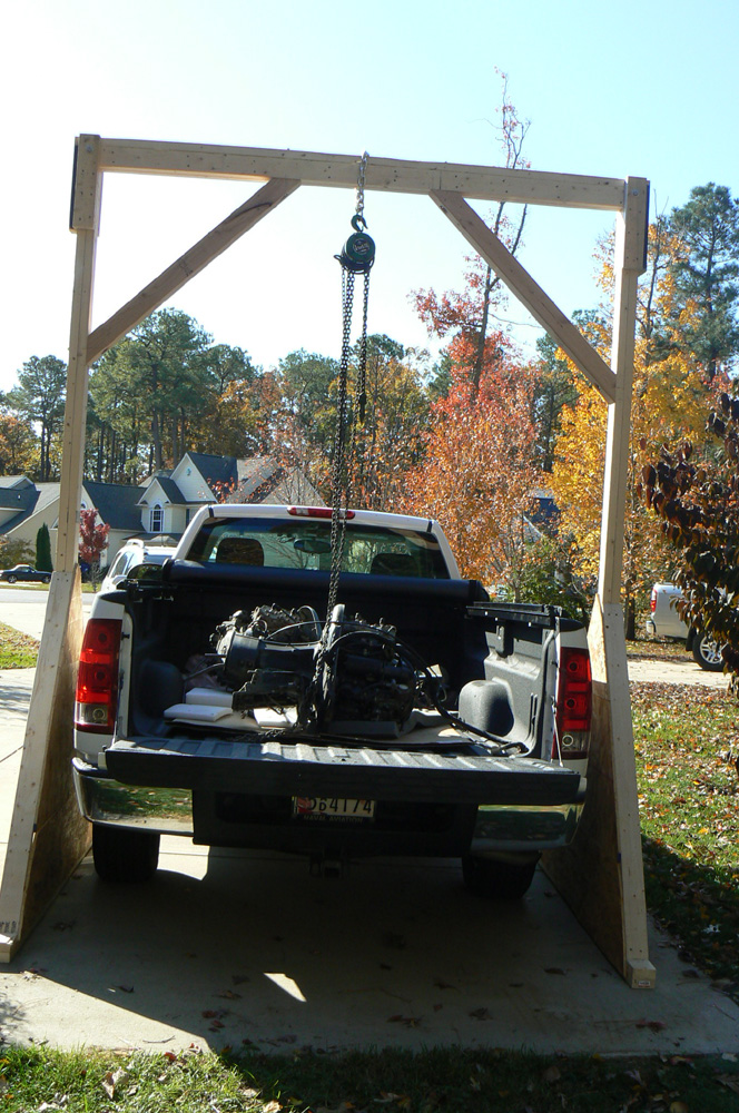

Here's a shot of the chainfall connected up top.
Here's the 75hp Rude coming off

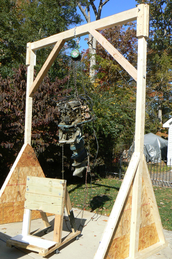

The 80hp coming off
The hoist works real well, never even budged with the 80hp on there. Don't think it will with the 283 rither, time will tell. As you can see, I can back the truck right under it and I'll be able to put the Century under it with ease since it only has a 5' beam. Plenty of room vertically to lift the 283 high enough to pull the trailer right out from under it and attach it to an engine stand. I'm thinking of buying the 1 ton wheel around model at Harbor Freight. I think it will hold the engin with the velvet drive on the front of it. Worse case I can extend the lower beam so it reaches far enough for the motor and transmission to not tilt forward. The 1 ton stand is better than the 750lb model since it has a short beam across the main beam so it has two wheels and it won't tip easy when you push it around.
The stand goes together in about 10 minutes and breaks down just as fast. Unfortunately I can't use it inside since my garage ceiling is too low and so is the shed. Hence the reason for being able to break it down and not hear the wife complain about havinf some monstrosity sitting in the yard. Plus neighbors can't complain either. ;)

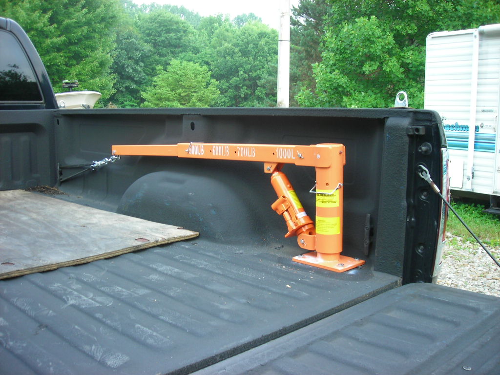

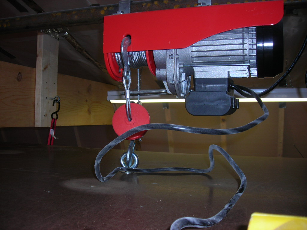

i have a harbor frieght 1100 lb.electric hoist in the garage and another hoist in my truck bed,hb of course,lol,it works well for motors,i just have to take off the tailgate,lol,. i plan on putting a boat winch and pully on it. the hoist holding up my foldable table.

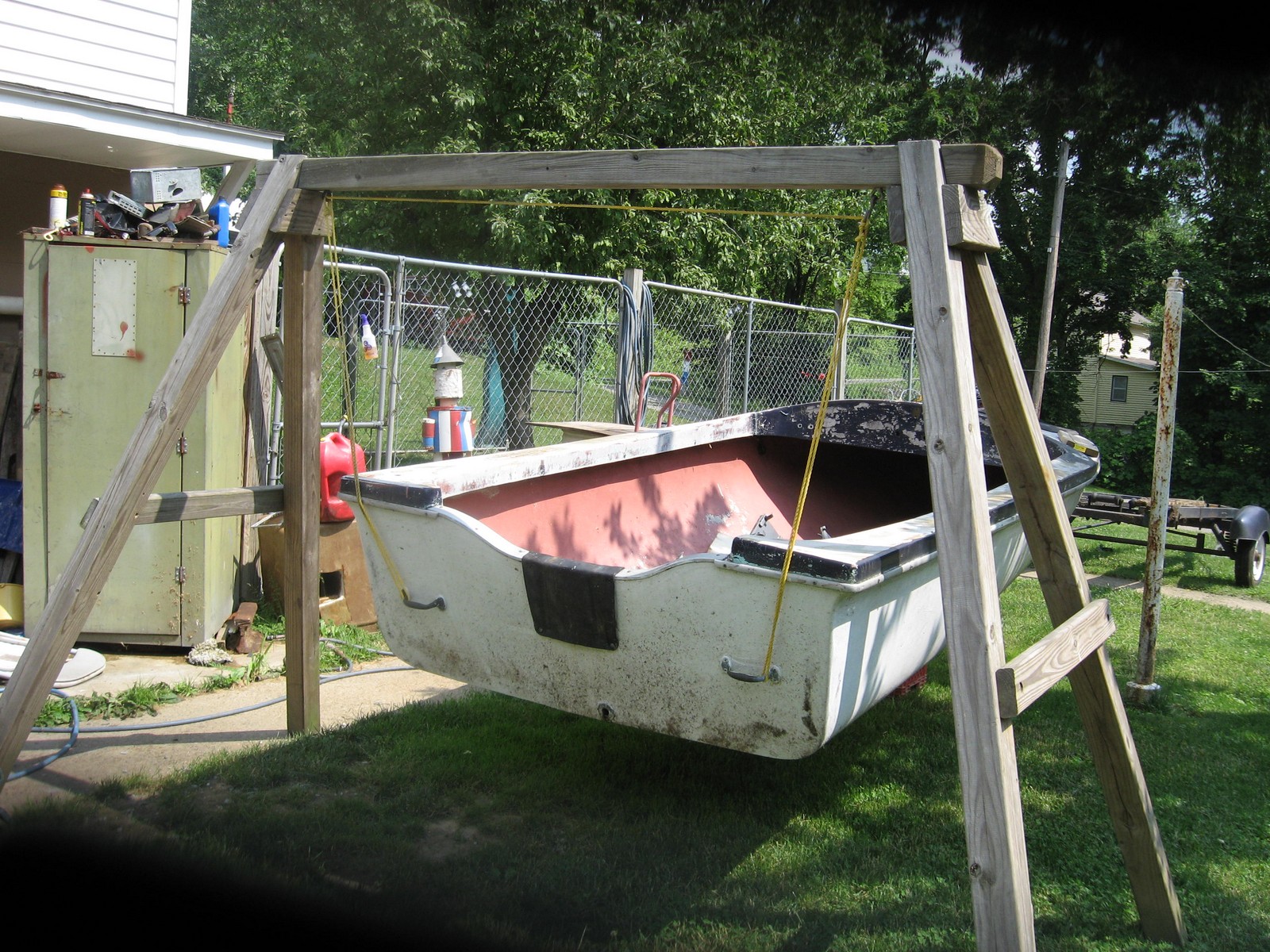

This swing A frame comes in handy too. But my fold up engine crane is great for the same reason. I have moved 460 big block Ford engines around on this thing. Keep the load low and it will push right along.
I never realized I didn't have a pic of my crane. You can see the end of the arm in this one. LOL

Bob, Great setup. Don't let the Merc pull the 2x4's off the wall. I usually put some old 4x4 blocking under the skeg to help with weight. That is if you have a motor with a skeg...

Cal, yeah I made sure the angle on the slanted 2"x6" was pushing on the bottom 2"x4" of the wall vice just pushing against the nails and waferboard of the wall. That thing isn't moving unless the whole wall comes down!
