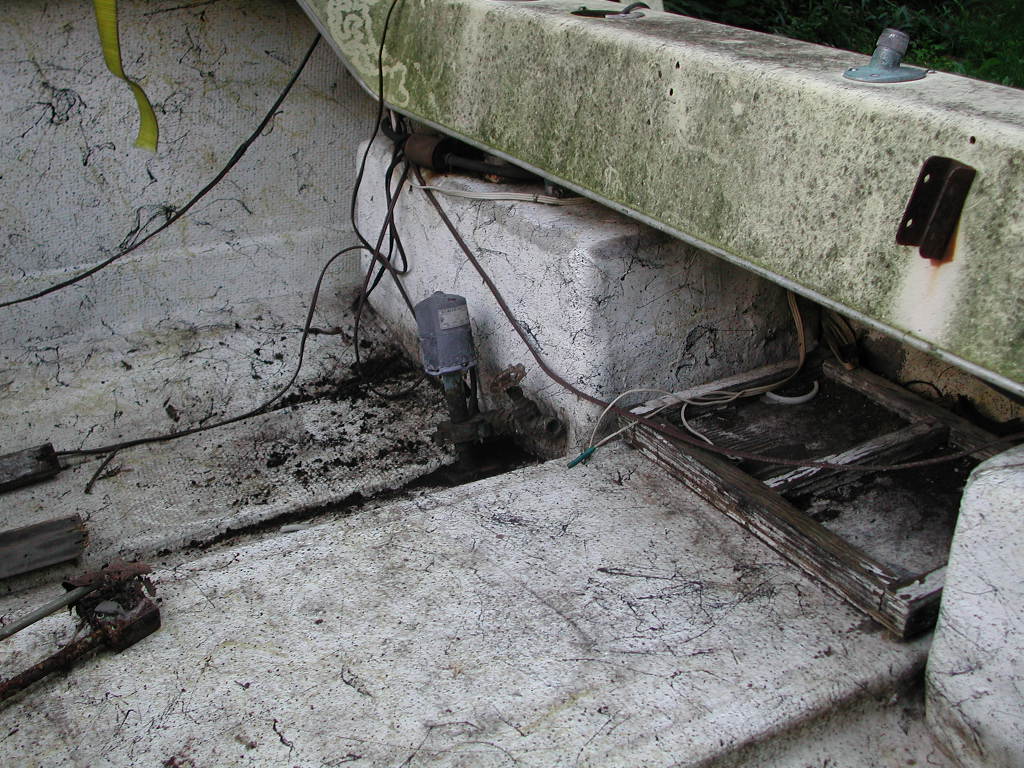

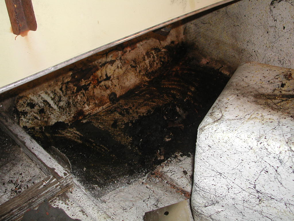

My newly acquired Power Cat 23T has two molded fuel tanks, to fit on each side just in front of the MERC i/o drive doghouse. The question is, has anyone had any experience with this style tank? I'm wondering if with age they may not be safe or may break down inside. The boat is a 1968 model. They look sound but just thought I would pass it through the vast knowledge forum. Thanks - Rich :unsure:

Being a 1968 the fuel system in the boat is not capable of dealing with the ethanol in today's fuels. The ethanol can dissolve the resin leading to leaks in the tank. Also all rubber components of the fuel system (including the carb kits in the engine) will need to be updated to alcohol resistant components. IF, and it's a big IF, you have ethanol free fuel available everywhere you boat you can most likely use the existing fuel system without any trouble but is it really worth the risk.

There is no problem with fiberglass and ethanol. FIber glass tanks are what fuel is stored in under ground,have been use to store ethanol for years. Glass (FRP) tanks are better then metal in so many ways
Now the problem is the fuel line. You will need to change them to a newer type of hosing (fun)

My 1961 Powercat 18DC had molded glass fuel tanks. They were wretched smelling. Danny Ledger, son of Ray Ledger the founder of Powercat, said they were a dismal failure. I removed mine from the boat and got rid of them. Going with standard metal tanks. Danny said the fuel ate them up. Big difference between epoxy resin and polyester or vinylester resin.

:laugh: Thanks for all the great input on the fuel tanks that came in my boat from the factory. The age and material used in these tanks and the alcohol fuels of today, will start me shopping for a set of tanks to replace them. A new fuel filter/separator will go in at the same time.
(right after this 5 inches of snow predicted tomorrow and a few months pass by) The forum wins again!!!! - Rich

RE the tanks - listen to the posts about Ethanol, as they are 100% correct. The tanks WILL slowly dissolve. Then you will have tiny bits of fiberglass being sucked into the fuel system. Naturally, when you least expect, your motor will get a bit of glass stuck in the carburator jet. Then you are dead in the water. Not fun, not worth the risk.
Just ask the folks with vintage skagits that had the built in tanks.... they all take them out.

It would be a disaster waiting to happen to keep your glass tanks. REPLACE THEM!!! Read the acticle so kindly attached in a previous post. It's pretty clear if you read the whole article that Polyester and gas with etahnol is a big NO-NO. I don't theink the person who posted the link and said it would be fine actually read the article. Underground tanks for gas are probably not made with polyester resins. It's too permiable. Epoxy is probably used, it has much lower permiability.
At any rate, stories abound of the gummy residue produced in older polyester tanks using new blended fuels rendering fuel systems and valve trains useless. even if you cna get ethanol free gas now, long term it'll be gone. Replace the tanks now while you are restoring rather than have to rip it apart later.

3hulls, to answer your immediate question about why the caps get so hard to remove. Its because the tank expands when you put fuel in it. Those plastic tanks are made of cross-linked polyethylene (PE). PE is slightly permeable, that means a little bit of fluid (not enough to create a danger) permeates into the tank wall and then the tank expands by about three percent. Just enough to make the damn caps difficult to get off.
As for fiberglass tanks, it is not advisable to use FRP tanks for gasoline. Boat tanks are a little different. We let them sit for long periods full of fuel which allows the fuel to over time attack the tank. Yes there have been problems with those underground tanks. Especially when MTBE was put in gasoline. MTBE was leaking all over the country.
Any way, your tanks are so old they should be replaced. Buy some good quality Plastic tanks or aluminum tanks and they should last another 20 years.

By the way, integral tanks are no longer permitted for gasoline powered boats. Haven't been allowed since 1977
33 CFR
Sec. 183.550 Fuel tanks: Installation.
(a) Each fuel tank must not be integral with any boat structure or mounted on an engine.
So they should be replaced anyway.

The Power Cat tanks were not actually integral. They were molded and then simply tabbed in place. Piece of cake to remove. Again, I refer you to the son of the manufacturer of Power Cat boats who reported they were a dismal failure and should be removed.
