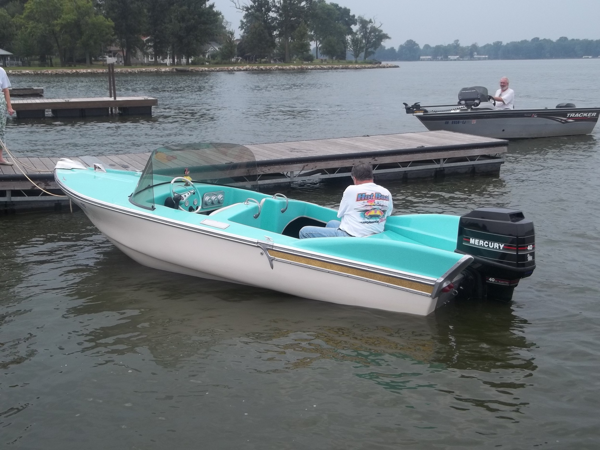

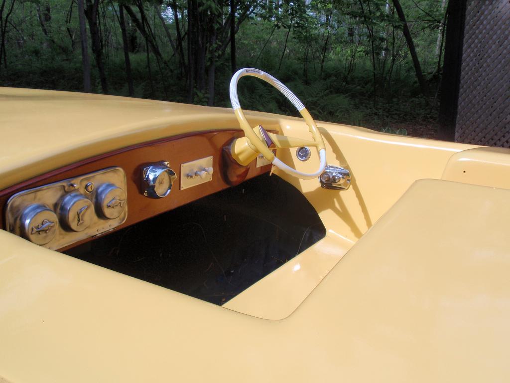

Here is a picture of are 1959 Herters I am just trying to post picture.

Success, and great looking boat by the way.
Re:1959 Herters 14 years 9 months ago #49754

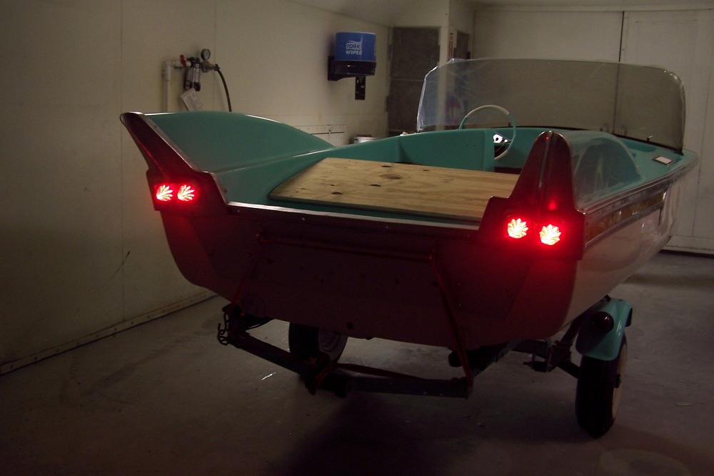

Now you're making me jealous. Must have been some subtle changes during the course of the year. I see different hand holds than I have for mine, wheel on the port side vs starboard. What lights are in the back?

boy it looks great,mines a port steering too,and my handles and bow handle are a bit different,but like cal says im jelous,i have to wait till spring and i hope it looks half as nice,john

I do not know about the hand holds. the lights i got at a truck stop they are leed.
I havea 1959 Howie Craft and the weel is on the port also.

I guess great minds run in the same truck stop.
There are some pretty significant differences in the interiors. Your dashboard is larger (deeper)than mine, the back of the front seats is narrower(?), the rear seating area is much larger but the back of the rear seat is lower and it appears that the stearn is enclosed? Must be different orders or mid season changes.
curious, what did you do with your transom?

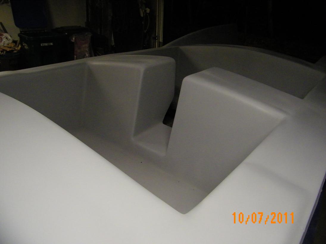

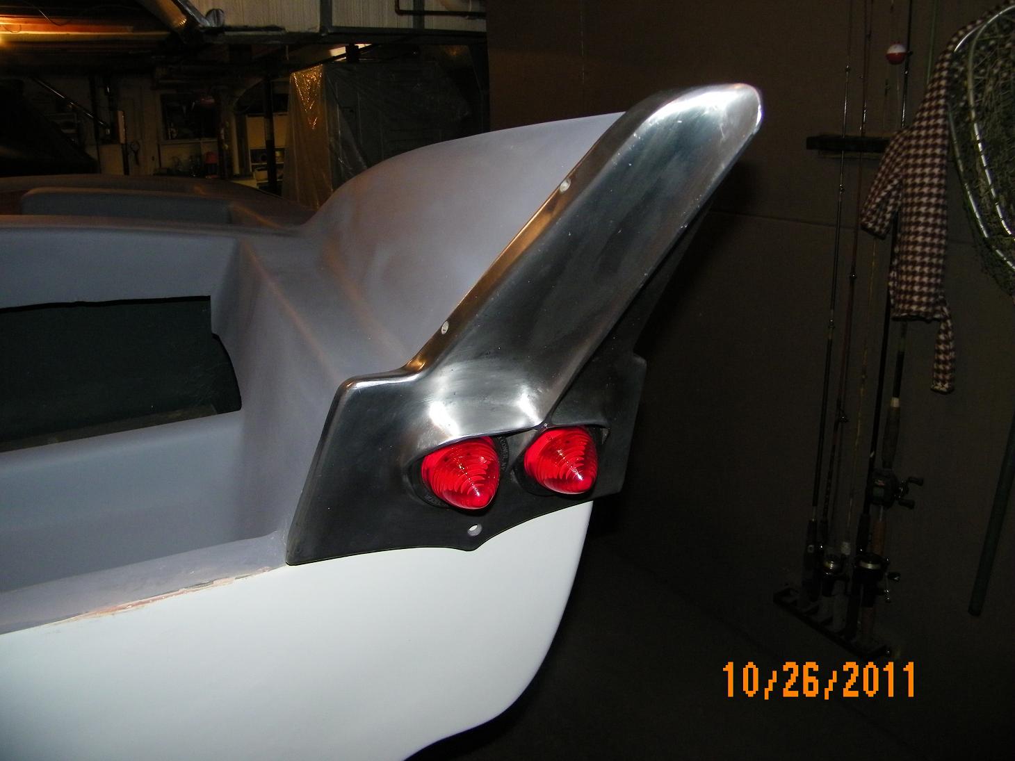

Mine had the innovative reversing rear seat it was in real bad shape so i made a seat. and my drain was in the center of the floor a couple of inches in from the transom but i put mine out the back of the transom .
Here is a photo of the rear seat when i was working on it.

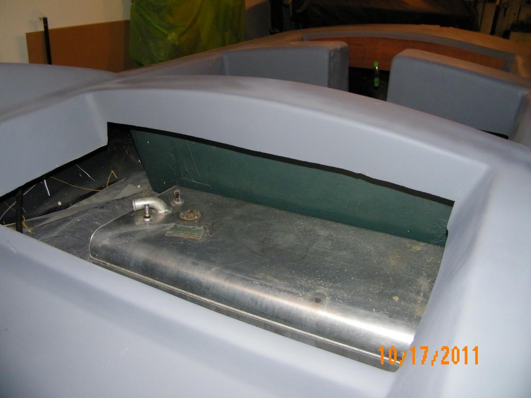

Is this the location where you are going to mount your gas tank? I don't know if your motor weighs a lot less than my 40-hp Mercury, but if you look in a past issue (about a year ago) of Rudder Magazine, you can see my '59 Herters that sunk. Since then we have installed the gaskets around the hoses to keep water from going into the boat, but still, no one can ride in the back seat.
These boats sit very low in the water, so you may think about re-positioning your gas tank elsewhere (towards the front, maybe?). Hate to see you have a problem.

Sorry to hear about the unfortunate sinking. Glad everything turned out ok. When I googled the Herters after I purchased it I came up on lots of pictures of some of you guys at the meets and in the water, they do ride low. I'm no lightweight myself'
Thought about the weight problem when I stuffed the tank there. How does your boat ride or get on plane. If I put the tank in the bow would it still be stable in the water without "plowing". I plan on putting the original engine on it a Mark 58AE, 1959. Battery in the back along with an extra person or so. That's an 18 gallon tank.

I would mount the motor you are going to use and take the boat to the lake and see how it sits (maybe with people in it) before mounting the gas tank.
We do have a splashwell with a drain, but our drain sits about 1/2" above the water, and takes more water IN than it lets OUT. But I believe we have solved the problems with ours, by installing the rubber cups around the hose inlets in the motor well and after we mount the '59 Evinrude Lark it should be okay. And a storm was brewing that day and the water started getting really rough. But they still sit VERY low in the water. My wife said she was glad we took the maiden voyage at Dale Hollow Kentucky instead of waiting until we went to Mt. Dora in Florida. She said she can swim, but can't outswim alligators!
You should be able to mount the gas tank in the front if you wish I have a 12 ft. Micro Boat with the gas tank on the front and it planes out (but we did put a doel fin on the back.

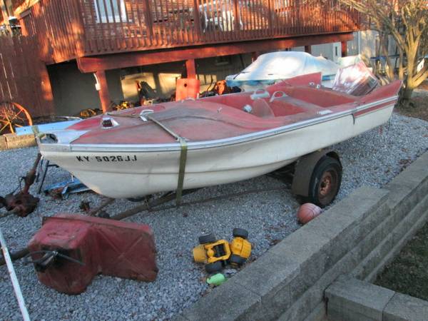

Glad I found this thread. From what I have read it looks as though I have a Deluxe 59/60.

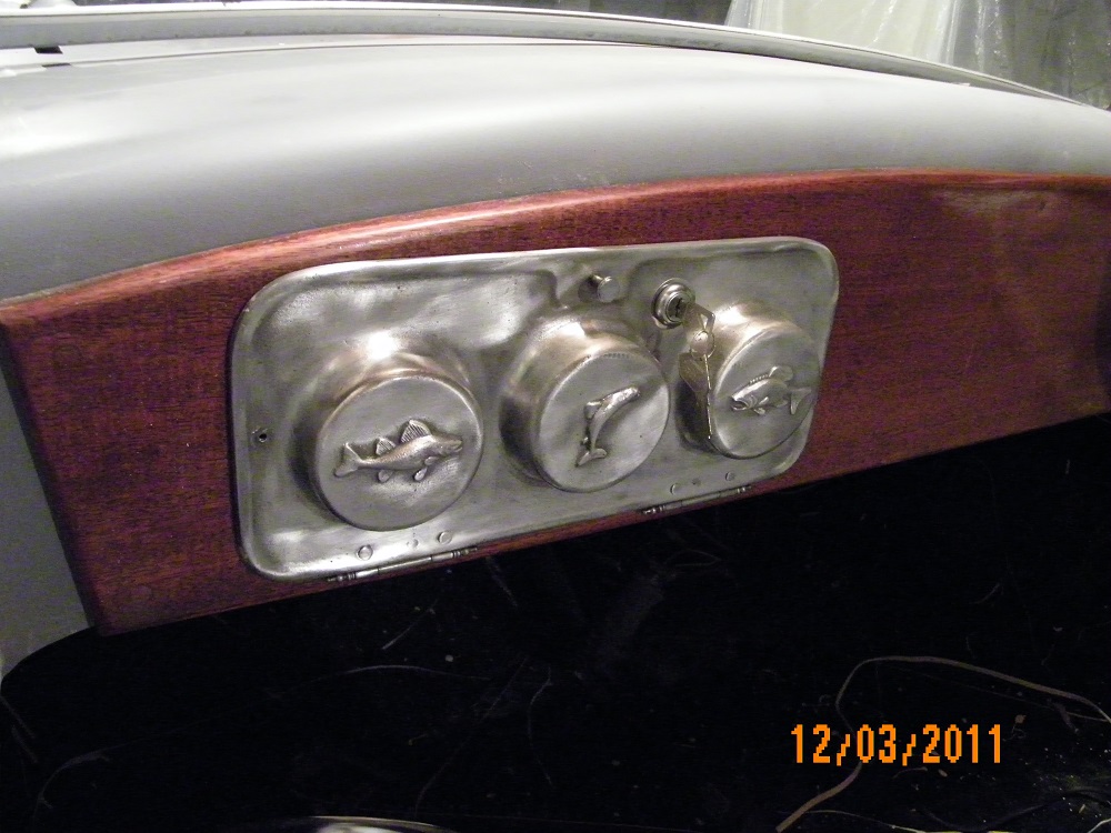

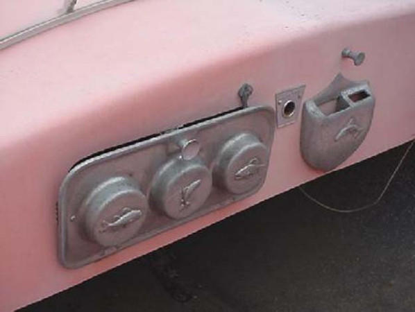

Anyone have one of these laying around?
Re:1959 Herters 10 years 7 months ago #119088
Cosmic, glad you found it also. Forgot about that thread :S
Lots of luck finding the glove box lid.
You will find that the heavy aluminum parts like the glove box cover, the tail fin covers and bow trim are all heavy cast aluminum, sorta rough in finish and it takes a lot of elbow grease, fine sanding and rubbing to bring them up to a shine but it can be done. Had to modify the cover with new hinges and a key lock. There was if I recall a cigarette pack holder. They show up once and awhile on ebay.
Re:1959 Herters 10 years 7 months ago #119089
Check with Larry Macay at Vintage BoatWorks in the past he has the glove box lid and I think the cigarette holder too.
If he does not have the cigarette holder I have one I could give up.

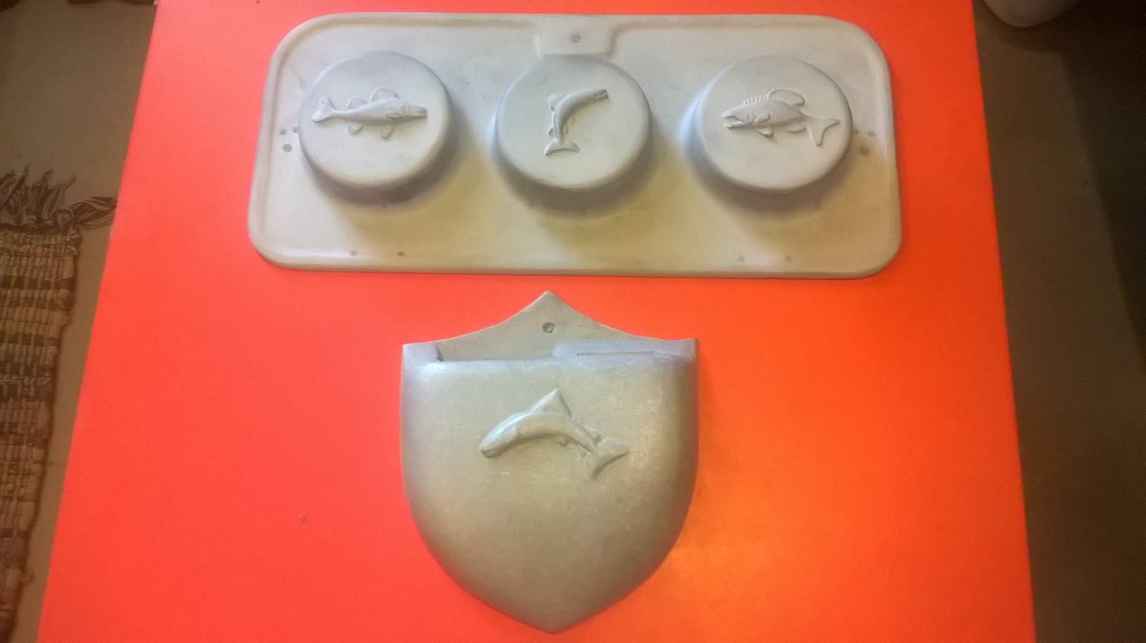

Yes, we reproduce the Herters glovebox doors and cigarette holders in sand cast aluminum. We also reproduce the fin caps for the 57' and 59' - 61' Herters, as well as the Herters Rocket. We also reproduce the Herters emblems in brass or aluminum.
