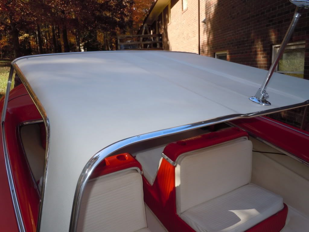

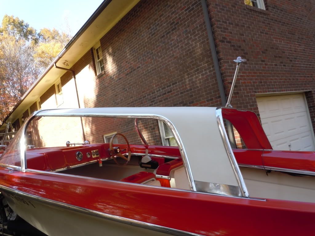

Years ago,I found this top on an Aristo in the woods. The boat had been shot numerous times in an attempt to rid it of mosquitoes and was about to be crushed and buried so I rescued the top ,but the texture on the top was toast. So this was my solution(to put vinyl top material over the texture).Just thought I'd post this if anyone else had this problem.Turned out pretty good IMHO..

Thanks guys, I used 3M contact adhesive spray. Andrew,I recovered a padded dash on a 66 ford pu a long time ago. It's not too bad cause you have those trim pieces and end caps on most of the edges to cover the vinyl, but those sharp turns on the corners are a little woolly. :laugh: When I found the hardtop,it had one bullet hole. I guess the next hole would have been made by a track loader bucket tooth :angry: !

jepstr67 wrote:
That sounds and looks like a great idea. Did you use a spray mount adhesive or what. I've tried to do stuff like that with contact cement, but it is hard to keep wrinkles out as you press the vinyl down onto the surface.
I used the spray, started in the center and worked my way to the outside. The only problem I had was some slight shrinkage of the material over the edges of the recessed area in the center where it steps down, but I figure when I had of gotten to those areas,got it bonded and let it set up a while longer, then proceeded, I might not of had that issue.

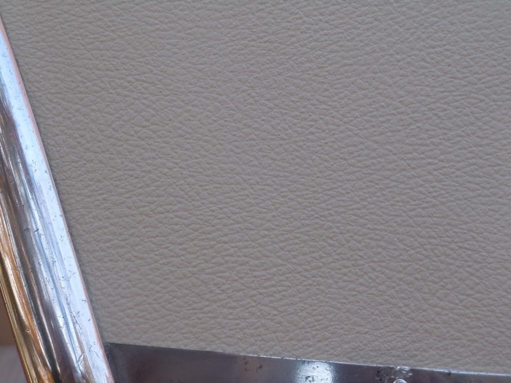

One of the things I like about the vinyl verses the original texture is the vinyl has a soft touch to it.
Re:One way to fix a hard top with damaged texture 14 years 10 months ago #49558
Probably transfers less heat to the underside area too, I would imagine?
