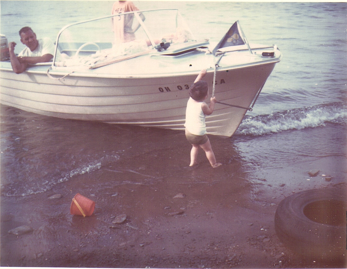

Hi! I am trying to identify my late Grandfather's FG boat. I thought it was an MFG from the 60's but based on the research I have done it does not appear to be (see attached photo). Any help would be greatly appreciated. Thank you!

I am not sure on the make and year, but I think you might be able to research it by the registration # on the side of the boat?
Re:Trying to identify my Grandfather's old FG Boat 14 years 10 months ago #49203
Welcome aboard JM. Have you had a look thru the FG Library yet? I'm sure one of the other members will chime in with suggestions, I'm lousy at this "game" myself. Got a bad case of "CRS"! If I had to guess, I'd say '60-'62 range though?
Re:Trying to identify my Grandfather's old FG Boat 14 years 10 months ago #49209
It looks a lot like MFG's Lap strake hull but I see a split windshield. I would say early sixties also.

Re:Trying to identify my Grandfather's old FG Boat 14 years 10 months ago #49255
I agree with Mark also, definitely looks like '60 to '62. Looks like a nice Fatty v4 on the back too!
Re:Trying to identify my Grandfather's old FG Boat 14 years 10 months ago #49259
I gotta agree. The reverse lap on the hull is definitely a MFG characteristic :)

I contacted the Ohio DNR and they said it was a 1961 MFG based on the OH #. As of now I am disputing that based on the pictures I saw online for several reasons. One, at the end of the stern (forgive my novice nomenclature) there is a distinct curve pattern not consistent with MFG boats and two, the windshield is in two pieces. I will continue my research. I was able to find the last person the boat was titled to so I may try to contact him.
Re:Trying to identify my Grandfather's old FG Boat 14 years 9 months ago #49695
hi jmc,as for the windshield ,it could have gotten cracked or was bowing,and someone added the center piece for strength,the same had happened to my cruser by the po,so it might be an add on,just a thought,john

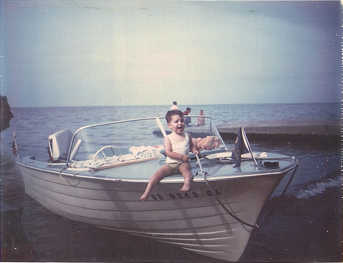

It has been a few years because I gave up but according to the ODNR the "MFG serial number" is N601173. I just do not see this boat being made by MFG but am desperate to find the manufacturer. A couple of other photos are attached. And yeah that was me 45 years ago in Conneaut, OH...

It's clearly an MFG Edinboro, probably a 1960. No other boats of that era had that exact hull shape with reversed lapstrake. The Fiberglassics Library clearly shows a split windshield on the 1960 brochure picture. The Westfield was not introduced until 1961 and the Niagara not until 1962, and the Seaway is bigger yet.
The transom curve was on all of the second generation hulls: Corry (1958-1963), Edinboro (1959-1970), Seaway (1960-1967), Westfield (1961-1972), Niagara (1962-1973) and Erie (1965-1966).plus the Sea Cruiser.
Also, MFG was (and still is) based in Ashtabula, OH, and the boat division was in Union City, PA, and most of those early dealers were in PA and OH. You saw those boats everywhere in those areas when I was a kid in the 60's. The picture was taken in Conneaut. Anywhere else than NE Ohio or Western PA, then maybe, but Conneaut is right in the heart of old MFG territory.
Those early ones also had wood floors with aluminum keelsons, along with little fiberglass ribs bonded to the inside of the hull. If you've got those ribs, it's a dead giveaway for an MFG. The ribs were phased out by 1962, except for the Corry. Most of the MFG dealers in those areas sold Johnsons or Evinrudes and the most common motor sold would have been an OMC 75hp V4 on the 1960-1965 Edinboro. Also, measure it. If 16' 6" long, it's an Edinboro.
My brother has our family's last MFG, a 1965 Edinboro with 75hp Evinrude, so I know them well. We've had it in the family for 46 years now. My 1966 Niagara was purchased from a seller in St. Mary's, PA two years ago.
So, definitely an MFG Edinboro. If you have the boat and are anywhere near Cleveland, OH, I'd love to drive out and take a look at it. I have yet to see a 1960 Edinboro; only from pictures.

First welcome aboard. It must be a good feeling to have Granddad's boat. I agree with Dave it appears to be a 60 Edinboro. Ohio like most states back in the early days registered the boat the year it was sold. So it is likely that a 60 was sold and registered as a 61.
I remember the MFG's and have a MFG Sea Cruiser. I am an old Lake county boy myself and at one time you would have thought MFG owned Fairport Harbor with all the MFG's running around. You and Dave ought to get together. It would be cool seeing two MFG's on the lake together.

Forgot to mention I love the picture of you on the deck of the boat. I have a new granddaughter, and when she's bigger, I'd love to get a similar shot of her on the bow of our Niagara.
