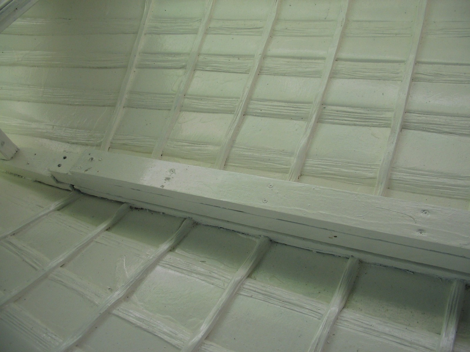

What I did when I replaced some wood inside the boat was I roughed the fiberglass up with a jitterbug with 40 grit and made a keyway in the wood keel I was replacing. I mixed a nice glob of fiberglass tigerhair up and spread it in the area under where the wood was to be and pressed it in to fit and put the brass screws in. I put weight on it for a spell too. It has never moved. In this pic it was the piece to the extreme left with a 2x4 going verticle for seat support.
