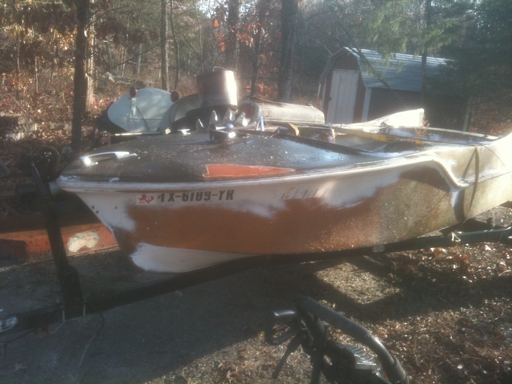

The gel coat was gone on the decks when I bought it from Ole Red a few - maybe 4 or 5 - years ago. It was just cloth showing and I knew I needed a bit of work on the tops.

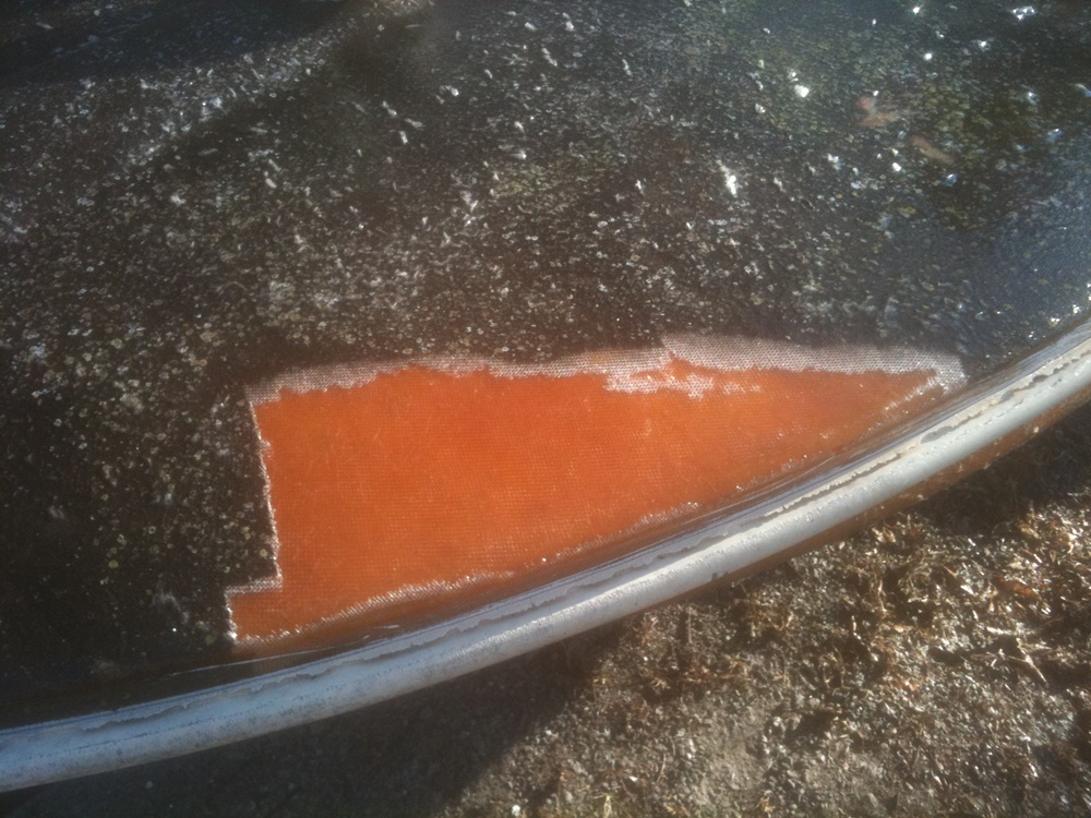

Today I pulled it over, got out the pressure washer expecting to take off the moss and crud down in the cloth showing. I didn't expect to be able to wash off the top layer of cloth!
The good news is I think I can just fair it out and gel coat it. I'll probably add a layer on the inside to replace the strength that it's lost.

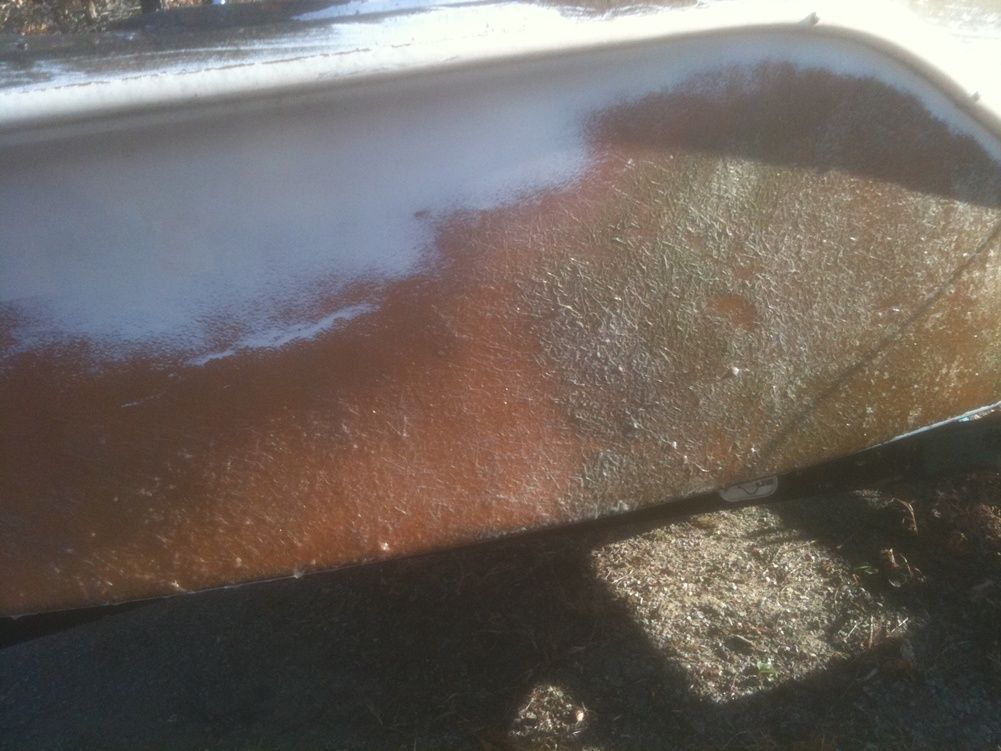

The sides still have some gelcoat on them. Where it doesn't, the washer is taking off a bit of fuzz, leaving some strands hanging in the breeze. But I think a sanding and gelcoat will fix that.

The picture with the wedge shaped area is where I pressure washed off the moss, and the top layer of cloth came along. Took a little longer to get the cloth than the moss, but if the pressure washer can take it off, it must go.
The side view has the washed area to the left, the right wasn't touched yet.

That must be some pressure washer, Austin! "We don't need no stinking stripper". (PAINT stripper) :laugh:

The black is mildew/moss. The white is the first layer of cloth. Gelcoat was gone long before I bought it.

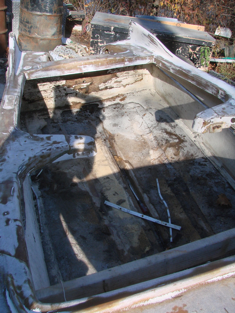

Got a little more done today. 75 degrees the first of November is hard to pass up.

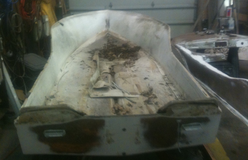

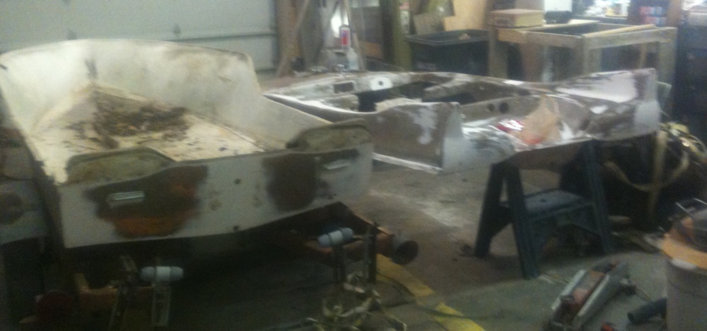

Cut out most of the old floor skin, seat mounts and separated the hull and deck. Since it was glassed over on the inside it was a lot of fun.
It'll probably stay this way until mid winter. Heated shop will make for a winter project. I'll probably roll it outside to have extreme pot life, then when I'm happy, roll it in and turn up the heat.

It's been a bit, but it's floated to the top for a bit. Cut out some of the junk, got a little more grinding of old stuff to clean it up.
Got enough 1" end core balsa to do the floor, plenty of cloth, and today ordered a 55 gallon drum of laminating resin. That should get me through several projects.
