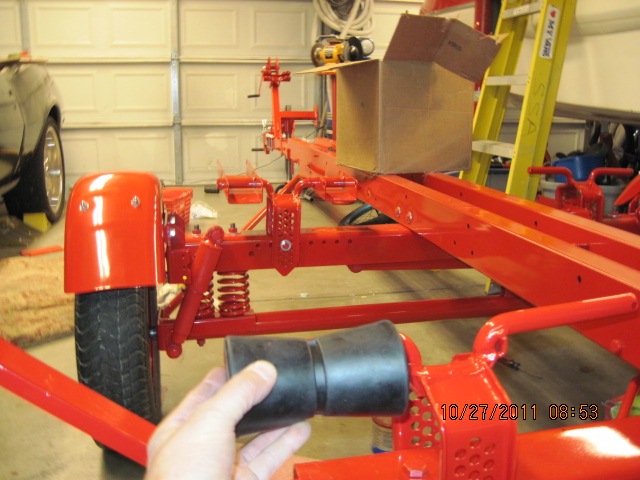

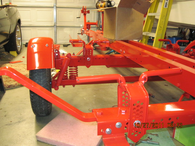

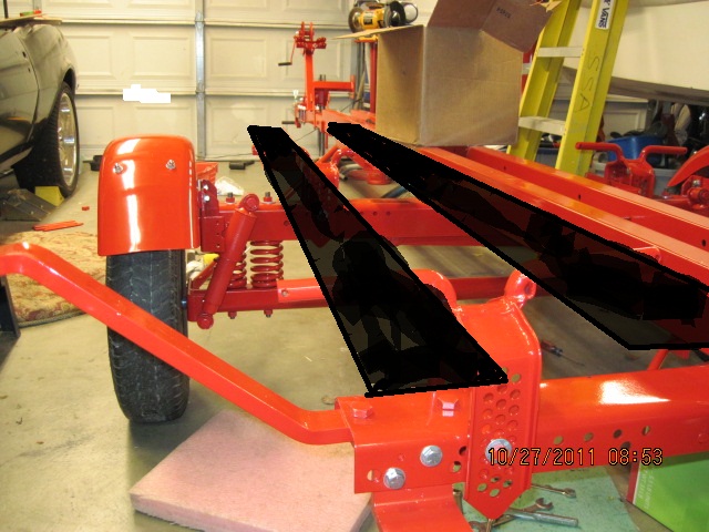

I am reassembling my 1960 Holsclaw,I bought all new rollers,whitch requier a bit of modification !!.After reading this thread, I am considering ditching the side roller system and installing,2 boards on eachh side connecting the existing roller supports.Is this a good plan ?
I am showing the existing roller supports
and 1 that shows the replacement roller for the rear
and another showing what I am considering ?
Thanks in advance for your opinions !!!

For anything other than a steel hull, roller bunks are a horrible choice. The hull construction is far too thin to support the total weight of the boat on the roller crowns. Rollers on the keel are a different thing - as they are not designed nor intended to support the entire boat.
Bunks should be as long as possible, and placed directly under stringers, not between them. Usually, the farther apart the bunks are - the better. People who like roller bunks argue that the boat launches and loads easier. Unless you are afraid to get your tootsies wet, a boat should be FLOATED on and off a trailer. I constantly see people crank on the trailer winch hard enough to tear out even the strongest of bow eyes. With practice, the trailer can be backed in the water just enough that the boat will float up on the trailer - just enough to hook up the winch strap. If the boat pulls a bit back from the bow cradle when you pull up the ramp, no problem. Get your rig on to flat ground in a straight line - up to about 5 mph and stab the brakes hard. The boat will slide right up to where it needs to be. You can then put on the transom tiedowns to secure the boat. Speaking of transom tie downs - those vintage "swing set chain" tie-downs should ONLY be used for show. Everyone should use modern HEAVY DUTY self-locking web straps on their boat, hooked to the frame of the trailer, or strong tie points welded or bolted to the trailer. "Eye bolts" purchesed at the local hardware store (the type that you might hang a porch swing, or sign from) are not even close to being strong enough.
Re:Roller bunks vs. carpet bunks 14 years 10 months ago #48734
I like your "proposed" idea, Fantm! I'm scheming on changing over my Holsclaw as well, since the boat is off it right now. My bunk mounts are a little different that yours, but where there's a will there's a way, right!? I'd like to keep the adjust-ability, but do away with the roller bunk part on the sides. I'll keep the keel rollers in the center, I think I can come up with some non-marring replacements that may work. Possibly a good thread for the trailer forum?
Edit: Just saw that you updated your Holsclaw thread, I've got to get on the stick here, sorry.
