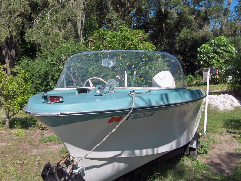

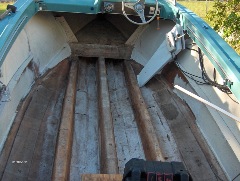

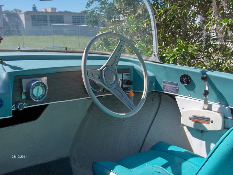

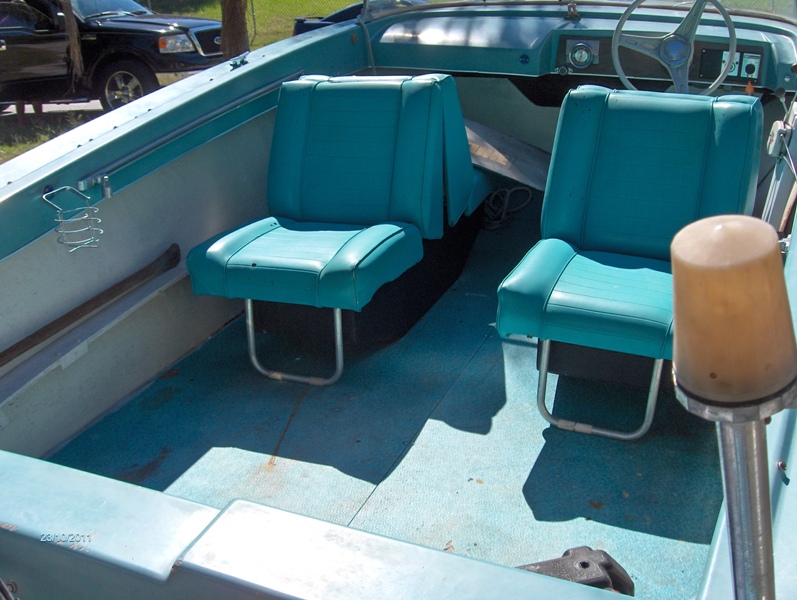

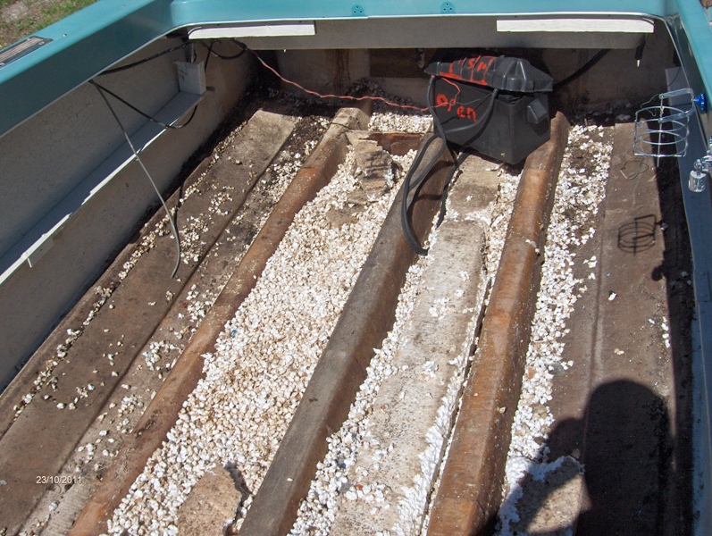

Finally have pics from 1967 Crestliner Del Rio, had to take the floor out chasing the rat, finally got him and now cleaning up the foam he tore up and ready for pourable foam this weekend. Also have new marine vinyl flooring to go down since the panels are out. Under the floor was dry and the original floor will be put back in as there was no damage. Will be putting it all back together this weekend and maybe get out on the water, love to get some action shots on the water..

Are those all fiberglass stringers? If so, LUCKY YOU!
I'd have left the rat. It would add character :)
-Andrew
Re:Crestliner Del Rio 14 years 10 months ago #49128
What I found was original and dry, no damage to anything but the foam(styrofoam in sheets) that I will be replacing this weekend. I have been reading about repairs to stringers anticipating reworking them and was surprised on what was under the floor.
Re:Crestliner Del Rio 14 years 10 months ago #49130
Have you core sampled the stringers? I would just to make sure.
Re:Crestliner Del Rio 14 years 10 months ago #49199
Your stringers should be hollow on your boat. They put alum plates in along the top in places for secure mounting of seats. All the Crestliners I have worked on have been the same. Just make sure the drain holes between them are clear of any junk. Skip.
