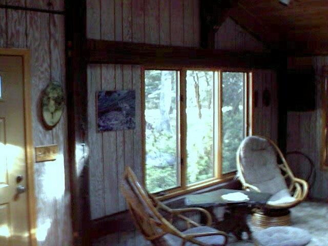

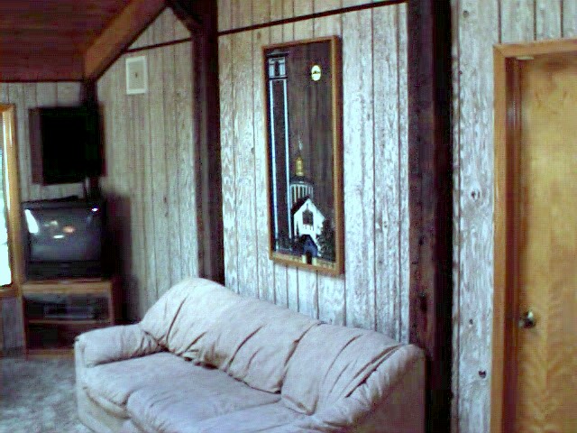

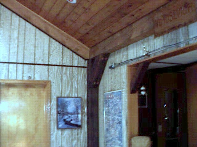

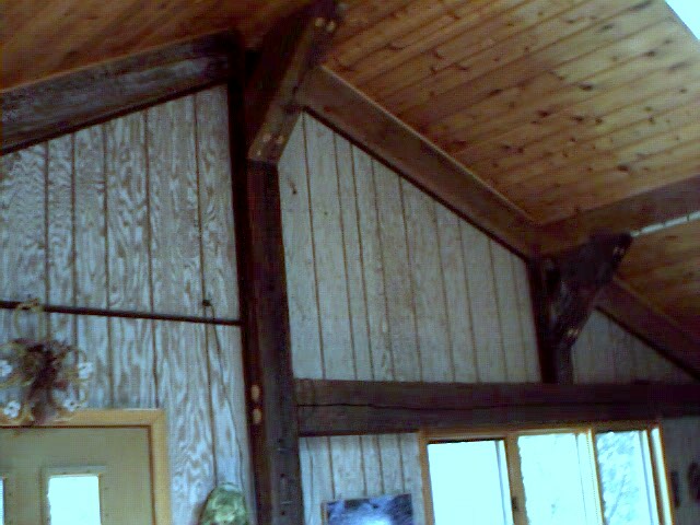

these timbers were out of a 110 year old hotel. i purchased them from a junk collector for $2 a foot, white pine and hemlock. i bought every one he had to construct my post and beam living room in the poconos. still needed more and had some milled. : :
