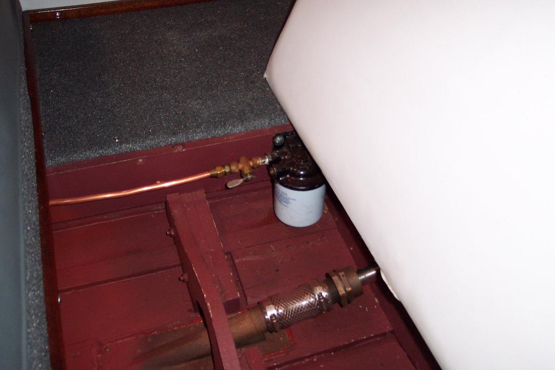

The water/fuel separator is something I would not be without on my Sabre and now I'm thinking of adding it when I install my fuel tank on the Herters. Any form of insurance would help.
Those are the ones that look like a screw on type oil filter. EBay is loaded with them.

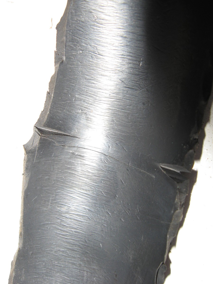

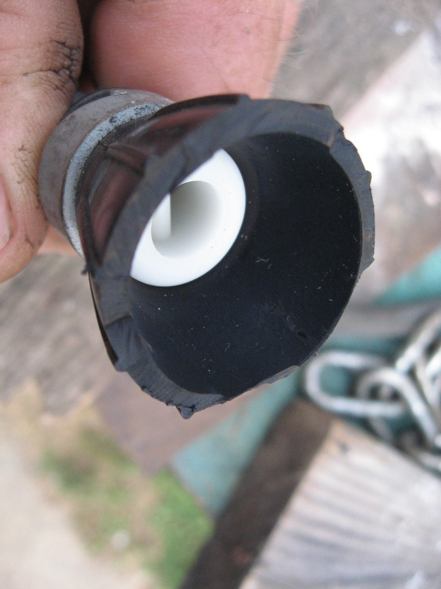

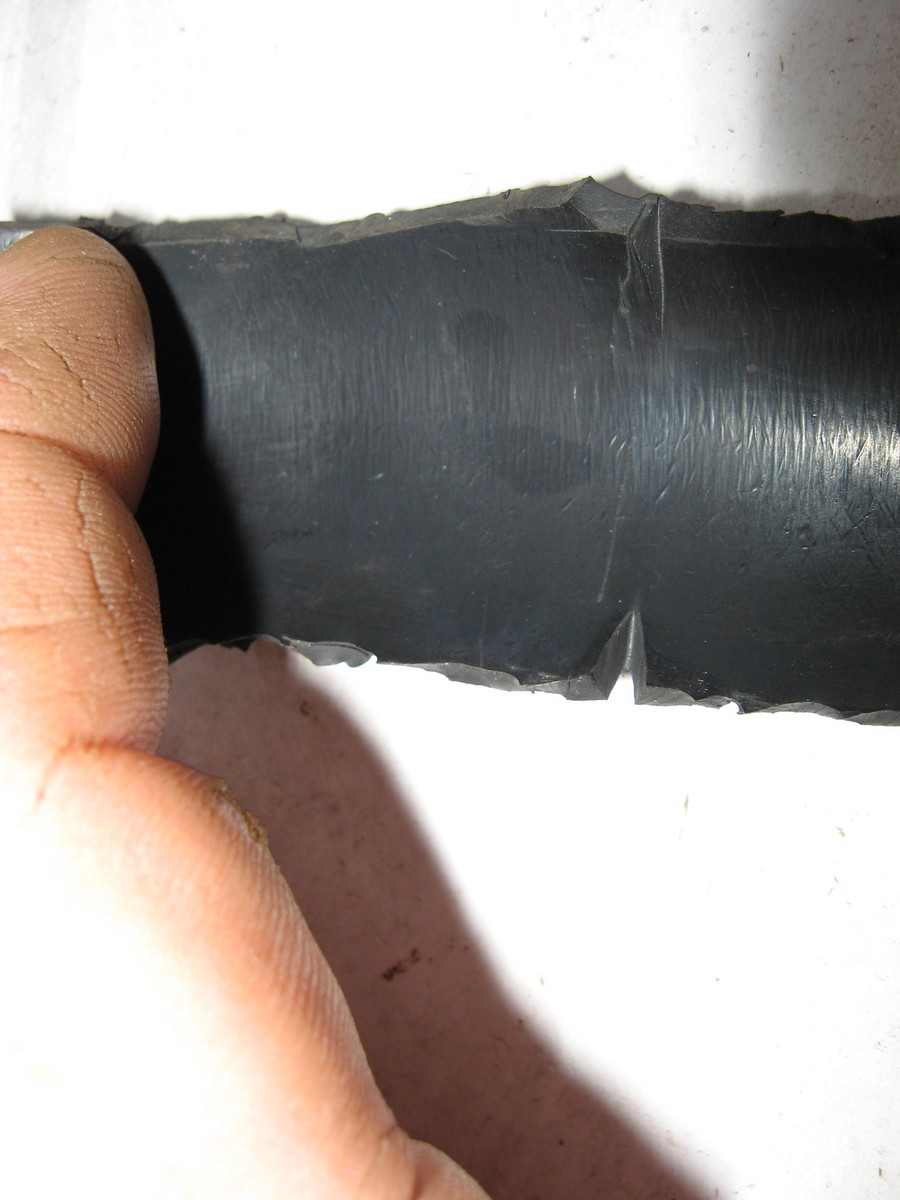

Inside of a fuel bulb. Case closed.

First of all ethanol absorbs moisture and eats rubber parts. The primer bulb was supposed to be ethanol proof but was not. My carb was getting plugged every few trips out. The bulb also when you rubbed your finger on the inside surface left black residue on your finger. It does not give the same mileage as regular no ethanol gas. I wish I had a station that sold it around here. The nearest one was in Clarion last time I checked. I also run a stabilizer year round now for all my small engines. If you look in the bottom of your gas tank and see a brownish glob you can thank ethanol for it. Clean your tank before it get sucked into the carb.

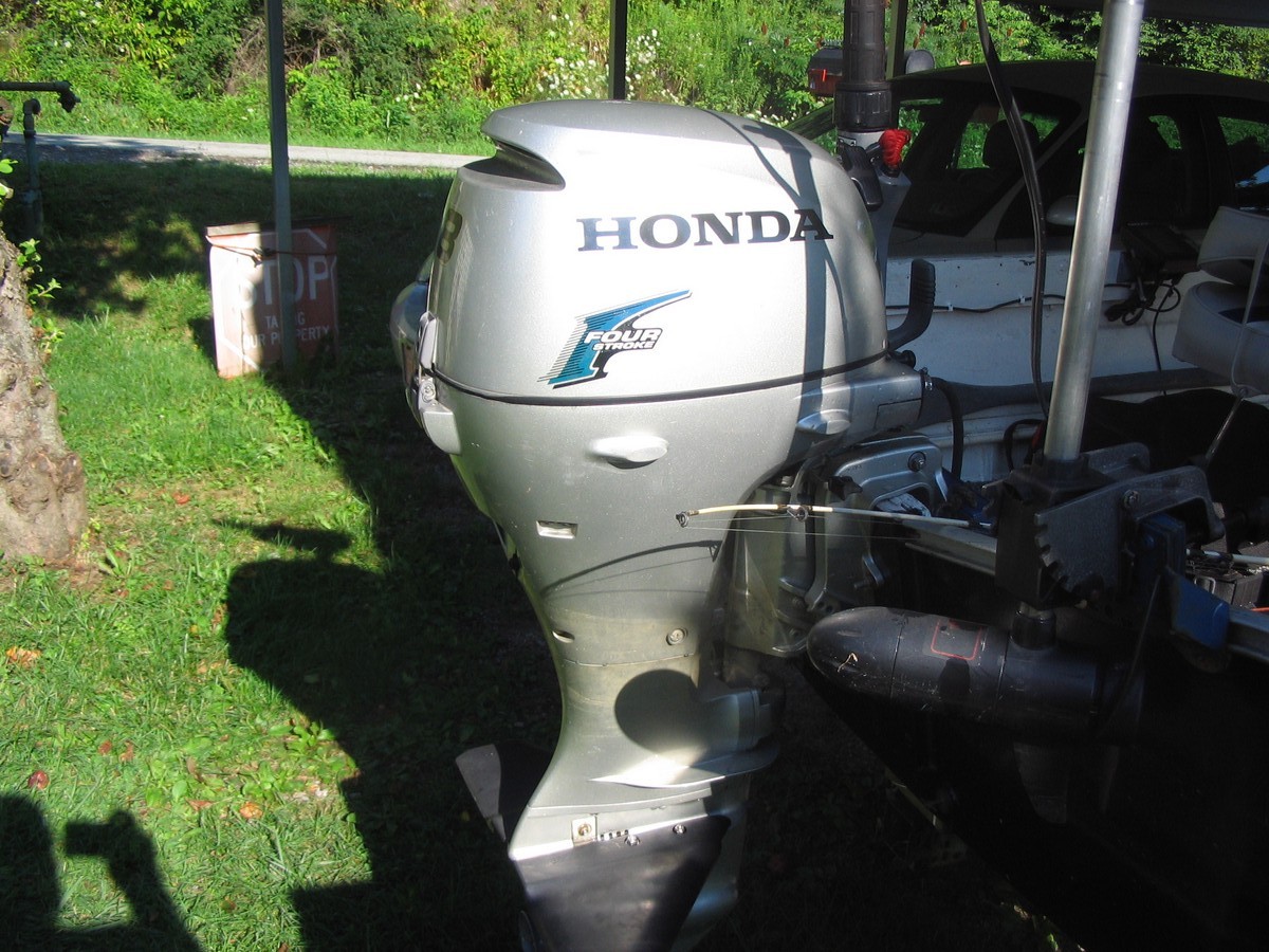

I forgot to mention I run a 4 stroke 2003 outboard.
