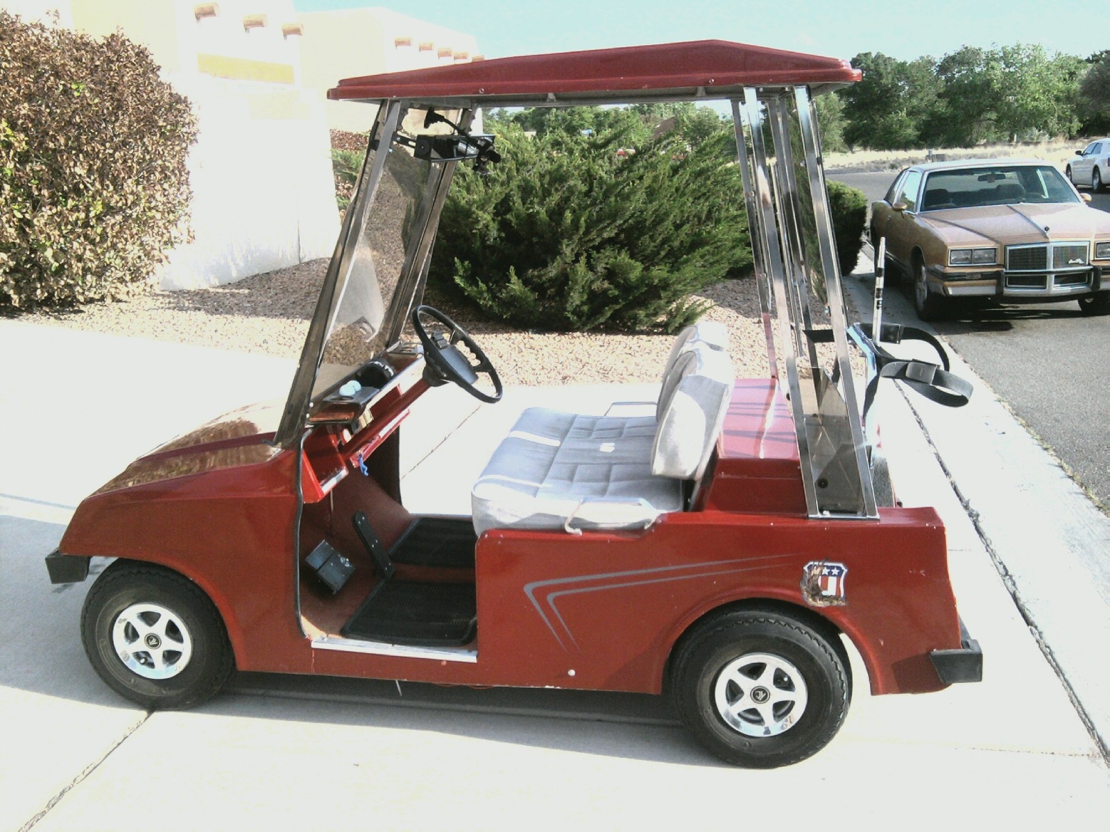

On my golf cart batteries,(golfing is my #1 hobby, but doing this boat is coming in pretty close) I have a ring on one of the positive battery terminals. It allows me to hook all the accessories to it, it has like four to six tabs sticking out of it. I can't find one from the golf cart suppliers or boat suppliers. Anyone know where you can get these? (pic of cart)
