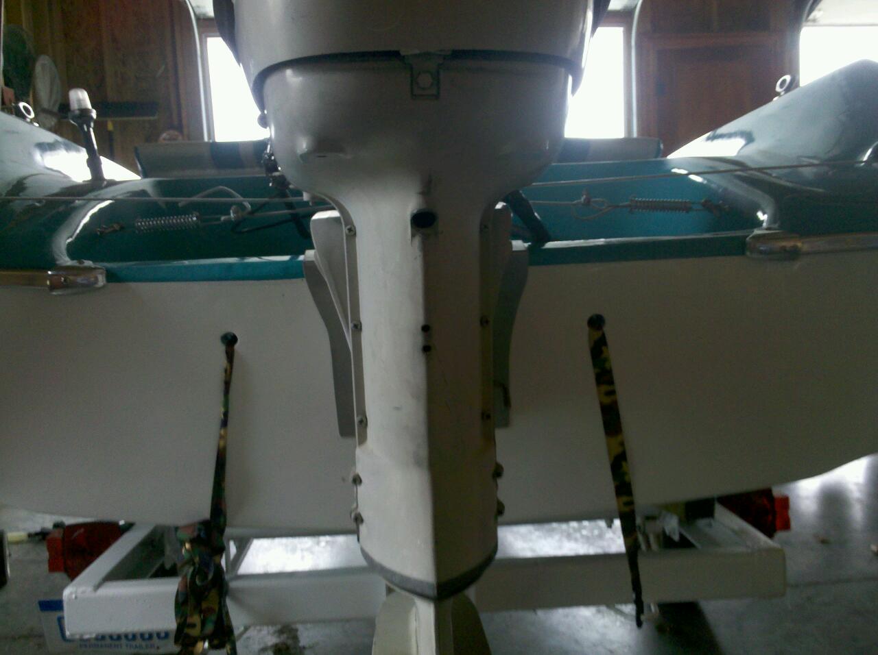

Mine come out of teh hull at the transom, to the motor with pullys then to springs attached to the hull sides. Works good. I think you can see it in this pic a little bit.
www.fiberglassics.com/media/kunena/attachments/legacy/images/rps20110905_140443.jpg

Take a closer look at the pics of my set up I posted on your other thread. That should explain what you need. One thing to remember with cable steering is your going to get "Torque Steer" with this system. That is if your motor is very strong and has a lot of torque, like my '59 Evinrude Fat Fifty, it will pull to the right and you will have to counter steer it to the left while your up at speed. Shouldn't really do it while at very low speed. There isn't much you can do about torque steer without changing your steering set up from cable steering. Hope this helps in answering your questions.
