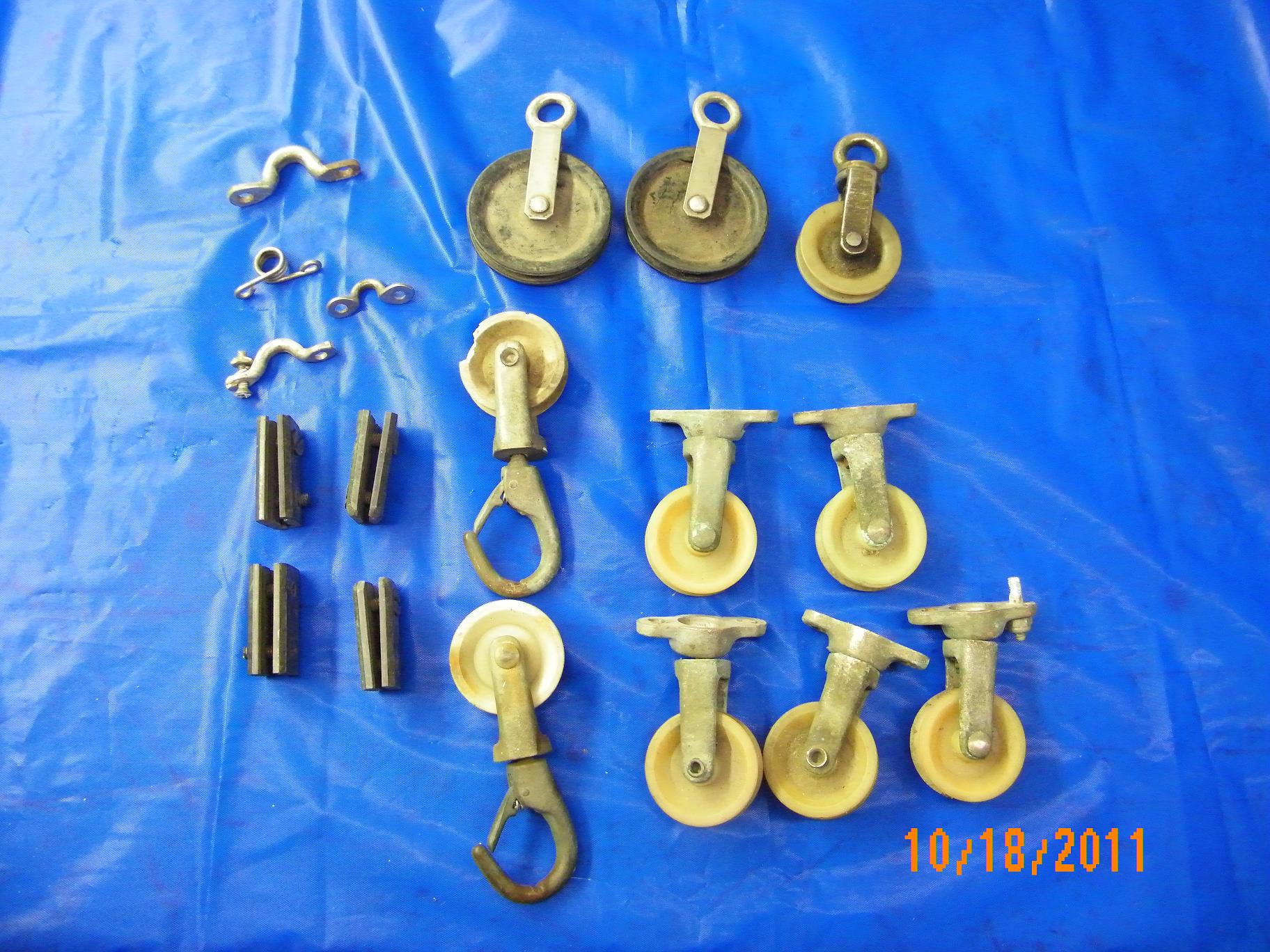

What exactly do you need for pulleys. I have some used ones in a box that were removed from various boats. If I snap a picture and post it you can choose and pick for free, just pay for the usps priority mailer.

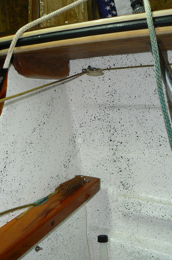

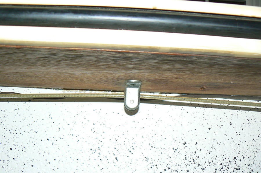

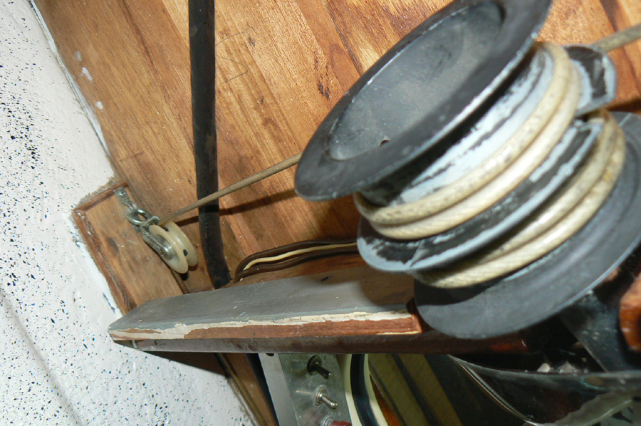

Sounds great! I have been told that I want now swiveling pulleys at the motor. Currently I have been told my steering is set up wrong. I have the typical drum on the back of the steering wheel. Then at both ends of the dash there are swivel pulleys, that send the cable to the transom. At the corners of the transom are swivel pulleys that send the cable to the motor. At the motor is a spring on each cable that then attaches to the motor steering bracket. I am told to use just one spring and also have a non-swiveling pulley on each side of the motor steering bracket, sending the cable back to the corners of the transom. Here one cable will be secured and the other cable will be attached to a spring and that is secured. Does that make sense? This is on a 14' boat with a 35hp motor. This is the way I bought the 1958 boat from the original family. So it has been wrong all these years. While I was at it, I was going to replace the old cable with new stainless/vinyl coated cable. Not having any luck with that cable either. Galvanized vinyl covered cable though is easy to find. Maybe I am looking at over kill. Hopefully by looking closely, you can see the one cable that is coming in from each side of the boat to the motor or motor bracket.

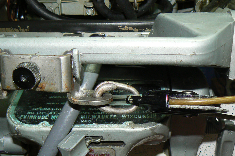

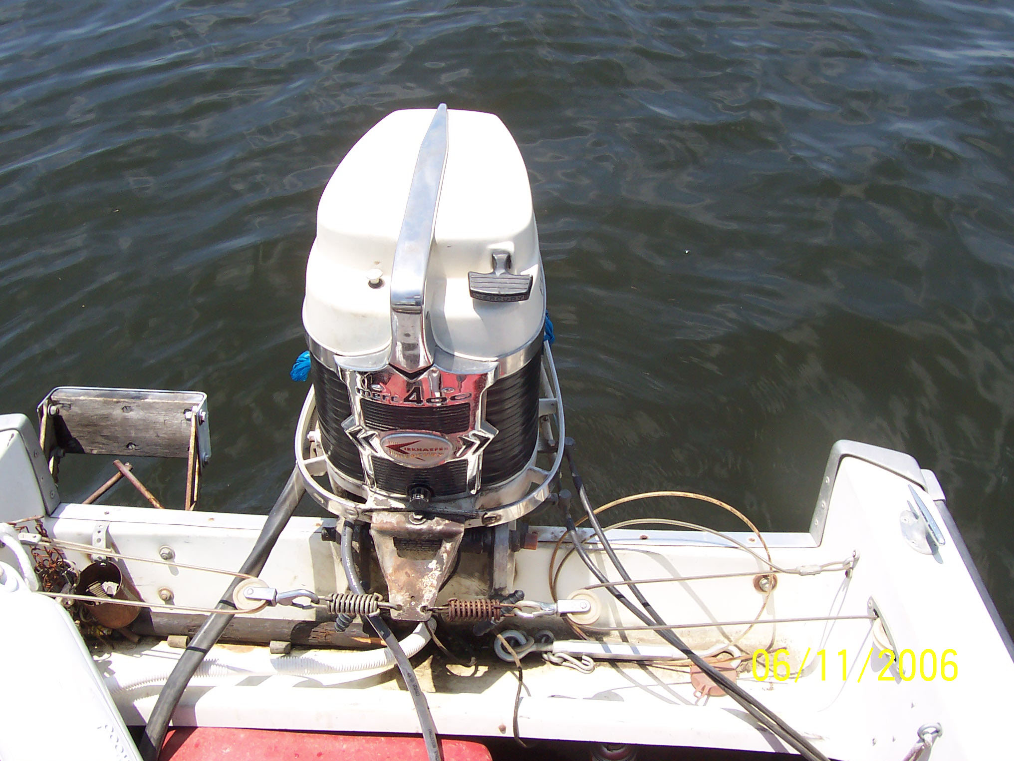

Re:Where to find parts? 14 years 2 months ago #47782
Dave,
Here is how mine is set up and this is the original configuration from when my grandfather bought the boat brand new.
Under the dash
Along the gunnels
At the transom
At the motor. There are two of these, one for each side. It's attached to an Evinrude.
By the way, this is still the original hardware also. As you can see the brackish water/air here has rusted the srpings finally so I have to replace those but everthing else is still in good working order. Of course it's been in a garage 99.5% of it's life. Hope this helps.

You are correct.... looking for stainless vinyl covered cables is not only overkill but maybe impossible. They have been making clothes lines for decades and that is all you need. Now getting particular on color might continue to make your search harder.
As for swivel vs not....shouldn't matter as long as things are tight. One spring is recommended at the dead end(corner transom or back corner on the return from your engine.

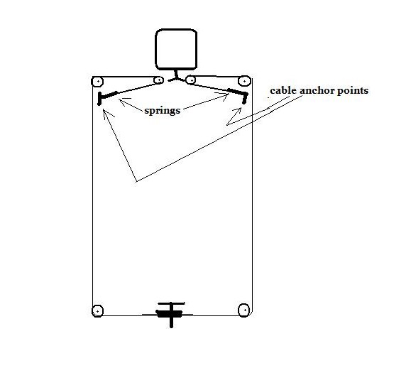

Dave. Here is what I have and also a primative paint drawing of the pulley run.
The five pulleys on the lower right are solid brass with plastic rounds. The two on the left with the brass hooks are what hook to the motor. The one plastic round is chipped. The other pulleys are plastic/aluminum. The cable connectors are brass. I got rid of most of my "supply" a few years back when I thought I was finished with boats. Sold them all to a used parts dealer in Sweden.
Don't have any springs left that I can find at the moment.
Here is the drawing of the cable run as I used on my boats. The springs take up any slack that is caused during turning. Adjust them so there is just enough tension to keep the cable taught so the springs can do their work.
This is a basic setup, same as waterwings' pictures show.
Pick the parts you need and I will send them to you. Shoot me an email with your address.
Cal
Re:Where to find parts? 14 years 2 months ago #47788
Cal,
Good drawing, that's exactly how mine is set up also.

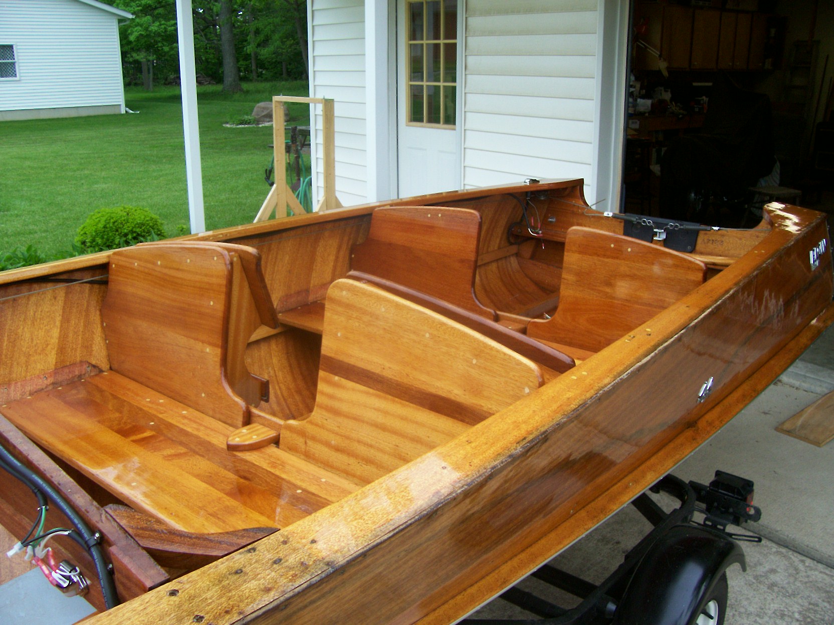

i have NO cables/pulleys to send you BUT that's a DOGGONE PURTY BOAT, anyhow!

So is this wrong?
Re:Where to find parts? 14 years 2 months ago #47806

Re:Where to find parts? 14 years 2 months ago #47813
Springs should be at the last connection. If they are at the motor it allows potential slop in the steering. the purpose of the springs is to keep system tight. You want a direct response from the steering to the motor.

thanks makes sense

  • Posts: 4776
Dave, got your mail, the pulleys will be sent out Thursday, no $$ please.

a 50 foot K9 tie out cable is equivalent, put the tension springs AT THE GUNNEL ends. right now with the springs at the pulley's @ the motor the motor is jibing left and right on the springs.
