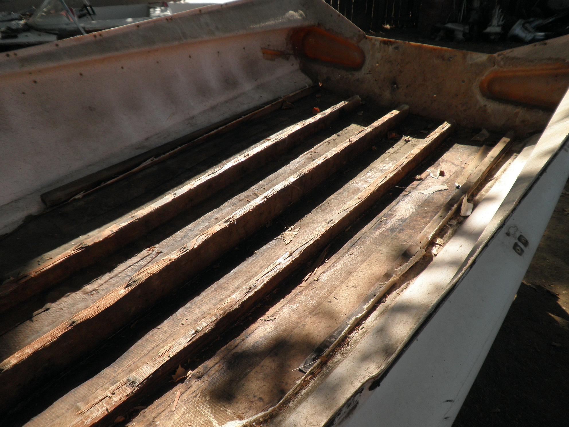

Looking for anyone who has any experience glassing with
Vinylester. Would like to know how it behaved compared to polyester. I'm leaning toward using it on my Reinell - but still undecided. I need to use a lot of mat on the transom layup, so Epoxy is out. I also want to gelcoat the inside of the boat when done, so poly or vinyl is needed.

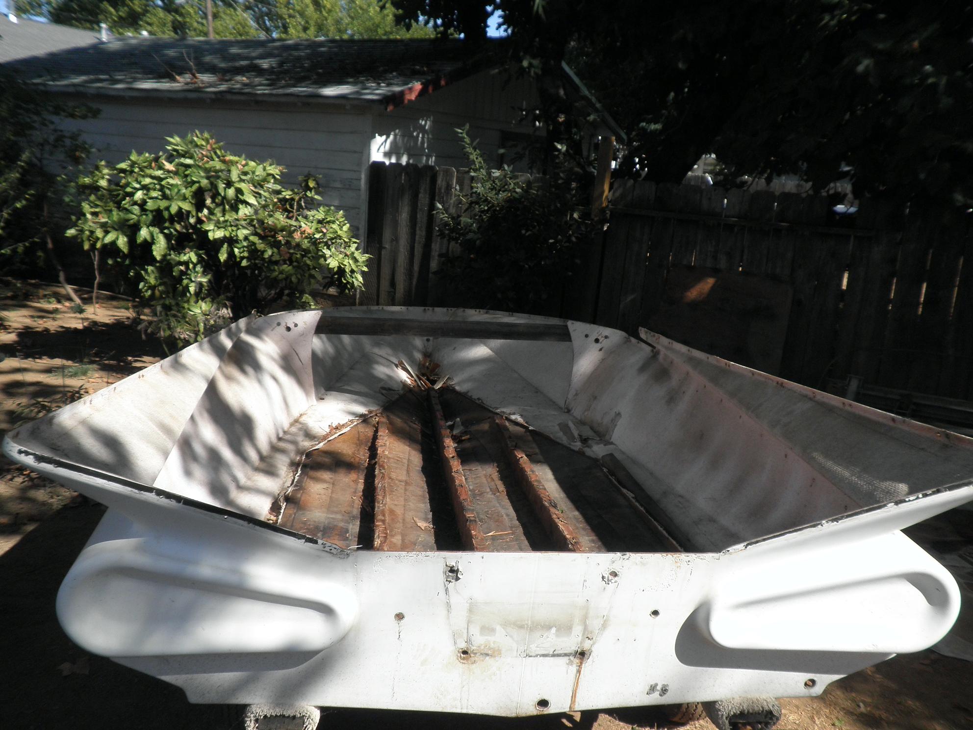

Just an observation here- since that transom is largely decorative, there isn't much "beef" to it, I would consider building up the strength inside- reinforce it a bit, as I did on my lake m sea, but then add more 'glass to the inside of the transom once it's in place, essentially making the inner skin of the transom the strengthening portion, rather than the outer.
I've seen it done on other boats, with similar, odd transoms, and am kind of doing that on the lake n sea, too... With a strange transom like that, it kind of makes sense!
Re:Vinylester Resin - ANYONE? 14 years 10 months ago #47460

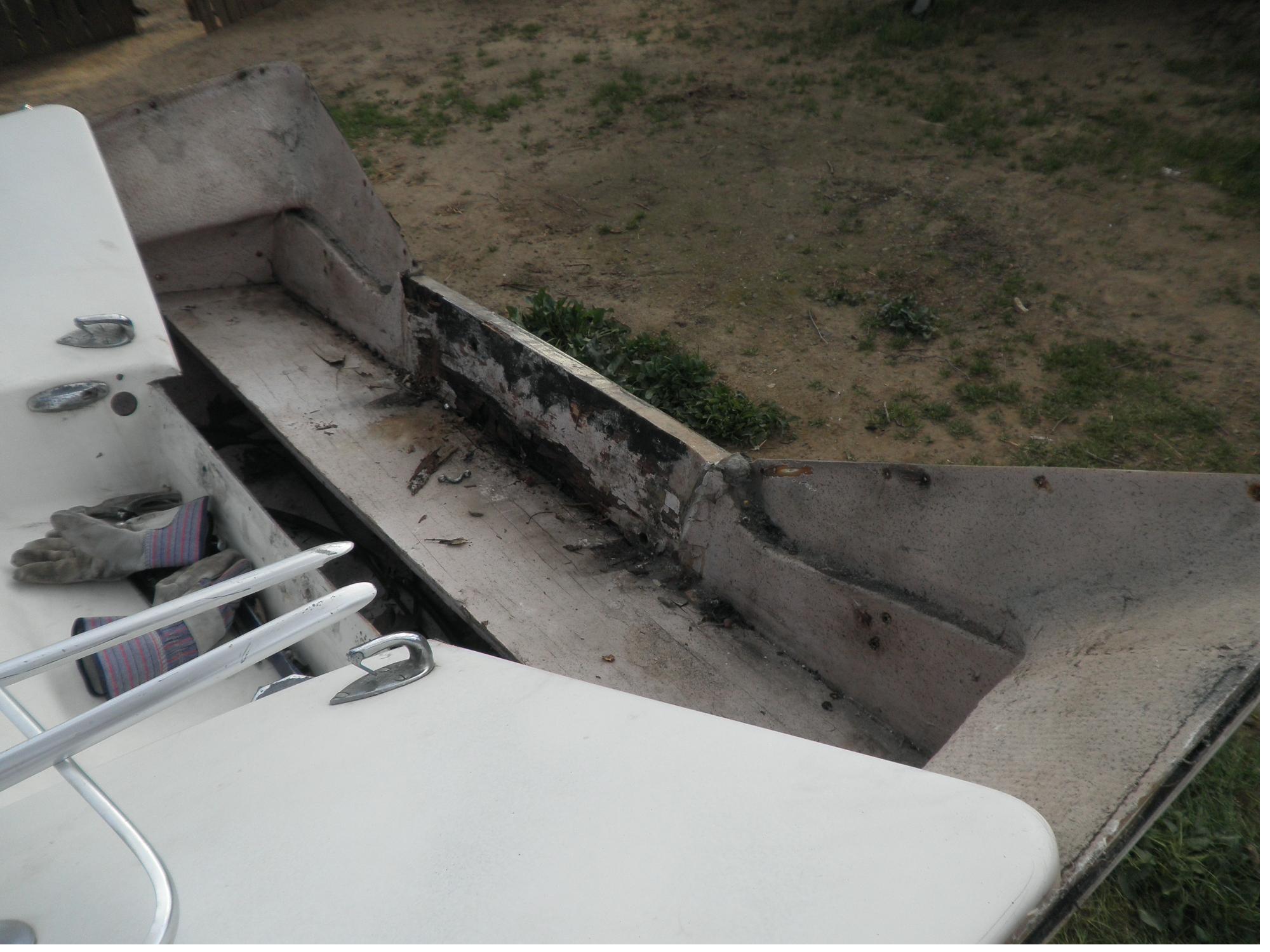

I see what your saying about the stern, he could make a pattern out cardboard then cut the plywood for it would fit the curves and in cuttings, build it for it would just "set-in-place" out of the boat with some good thickness to it as a whole semi-finished, set it in and add some back braces to the forward face, which the inside face of the stern and the plywood it self could be also "mated" together and finish with some resin and connecting layer(s) of fiberglass and some clamps and a finish layer(s) to the edges saving the out side molded fiberglass of the stern.
The one thing that getting my attention are the 'tail light' pockets, which I think it would be a bonus to fill those in prior to the above to make the stern even and flush, this also would help to protect the out side if something was to strike the out side of the stern.
Re:Vinylester Resin - ANYONE? 14 years 10 months ago #47464
The transom will be very strong, the rear skin is 3/16" glass the front skin on the splashwell is 1/8" glass, 2 layers of 3/4 Douglas Fir MDO plywood sandwiched together with heavy chop mat & resin. Back side laminated to the transom with 2 layers of stiched mat-biax fiberglass. Then it has a strongback girder glassed to the transom face, just below the splashwell. This is tabbed to the hull at the edges & fuly glassed over. It will be 3/8" thicker than the original & will be plenty for this boat.
