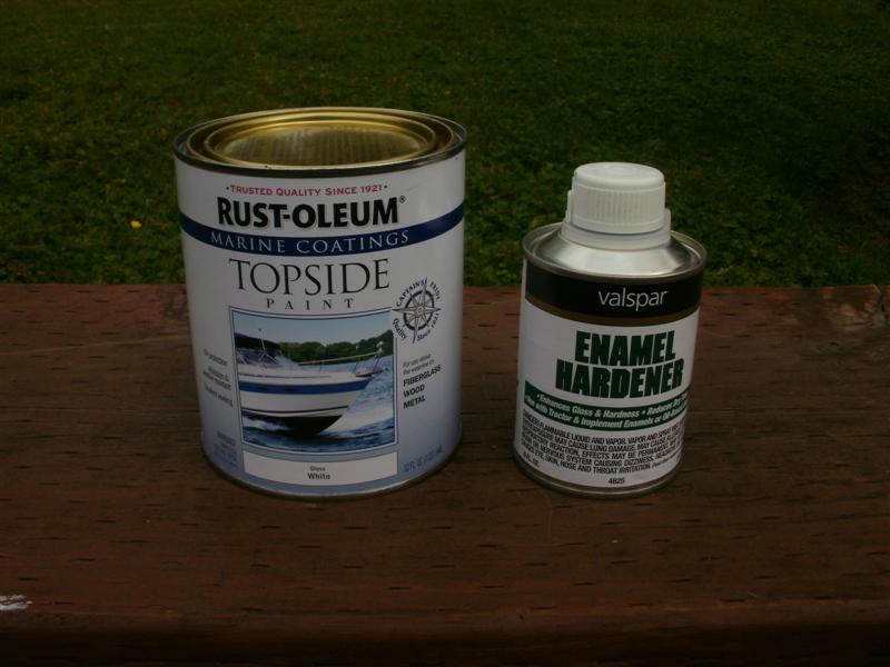

I'd recommend usning the regular Rustoleum Oil Based pant and add some acrylic enamel hardener. You can get the hardener at Tractor supply made by Valspar or At Advanced Auto Acme Finish One. Either one works great 2oz per quart. You can mix some white in with the grey to lighten it up a come close to matching what you want.

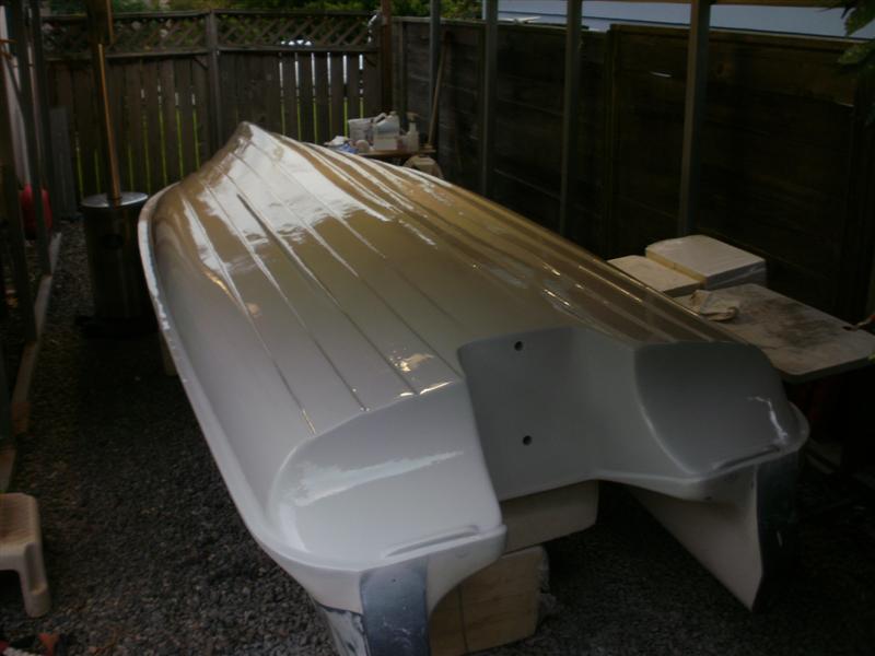

I looked everywhere local for the "Valspar " hardener and found it at Amazon.com I'm sold on the Rustolium - Took the advice of the Rustolium thread and thinned with Acetone and Hardener and my hull came out great.

Bham-Rick wrote;

It was a spray job Mark and I helped ( said in my best little girl "hamburger helper" voice).

Helped ?? You sprayed it, And did a great job - all I did was was the grunt work, Our mix was 1QT.High Gloss white , 8 Oz. Acetone and 4 Oz. hardner Melanie is Multi talented did the electrical on my trailer and sprayed that also Props and Kudo's to Melanie

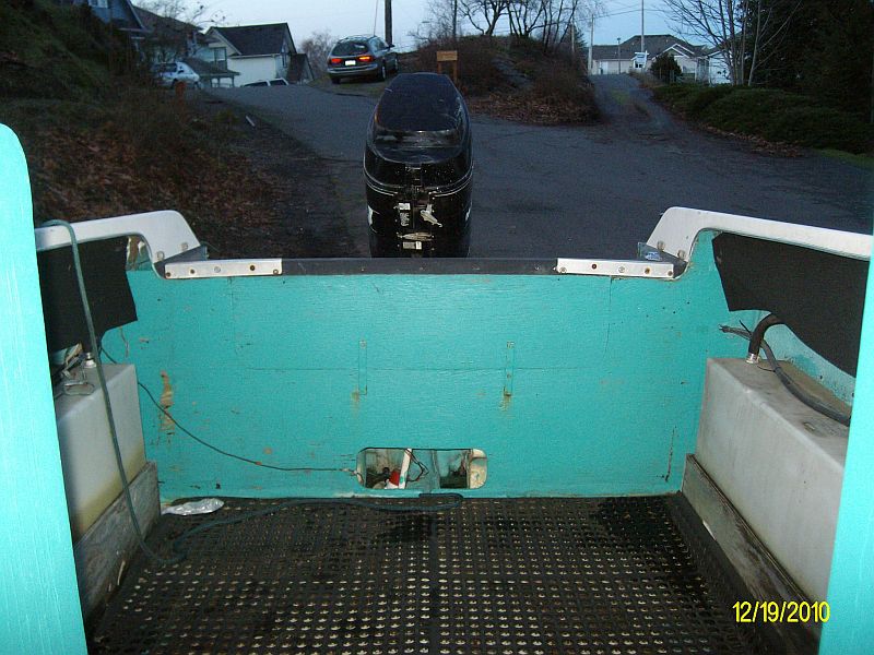

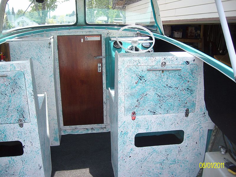

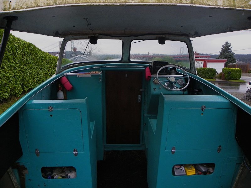

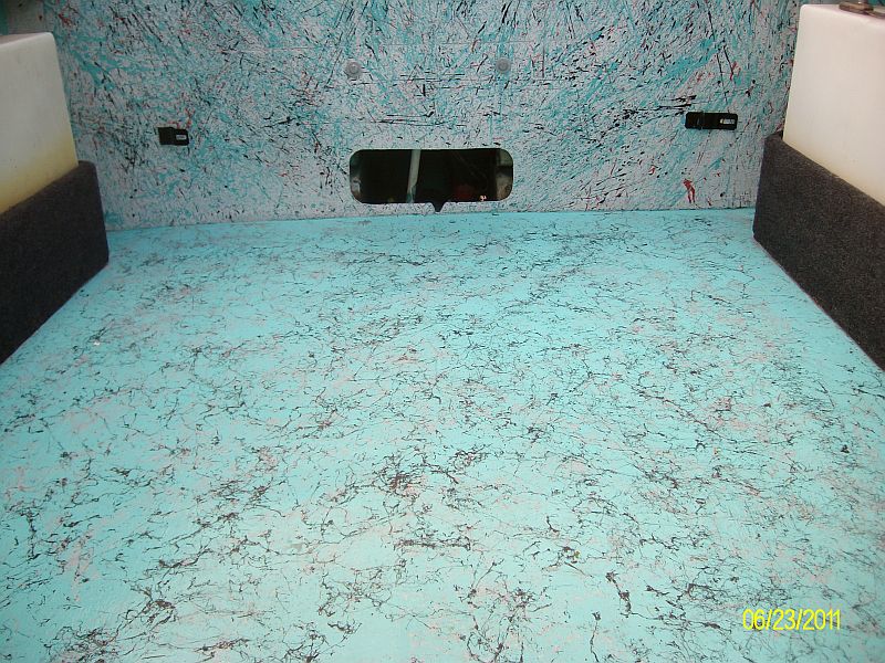

With the thought of "it's only paint" this is what I did to the Skagit to freshen it up for this past season. The deck is the same aqua color that I used in my creative splatter paint concoction on the seats and bulkhead. I used web paint available from Krylon, comes in black,silver,gold, and white.Small cans but does cover a large area. So far it's held up and hides a lot of defects.
www.krylon.com/products/webbing_spray

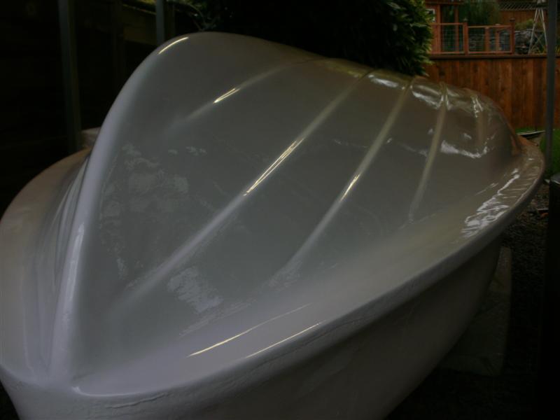

My latest work has been wet sanding/polishing the gel coat and painting the step pad frames. Next is painting the inside of the hull, rub rail insert and new seats.

Sorry I forgot about your project Paul, I remember it now that you posted the thread. (I'm worried about my memory loss here lately!) Dave (CC1000) has some NOS windshields he'll sell, may be an option for you. Not sure what size would fit your boat, you may need to throw a tape measure across the gunnels to see if his will fit.
Very cool effect on the splatter/webbing paint Melanie, I like the way it turned out! Most recently Cal did something similar on the interior of his Herters, I think the first one I saw was Brian (Crosbyboat) and the DC Powercat. I'll need something that hides imperfections, for sure. I was thinking about loading up a paint brush with the contrast color and doing my best Joe Cocker imitation, but this looks much better! :P

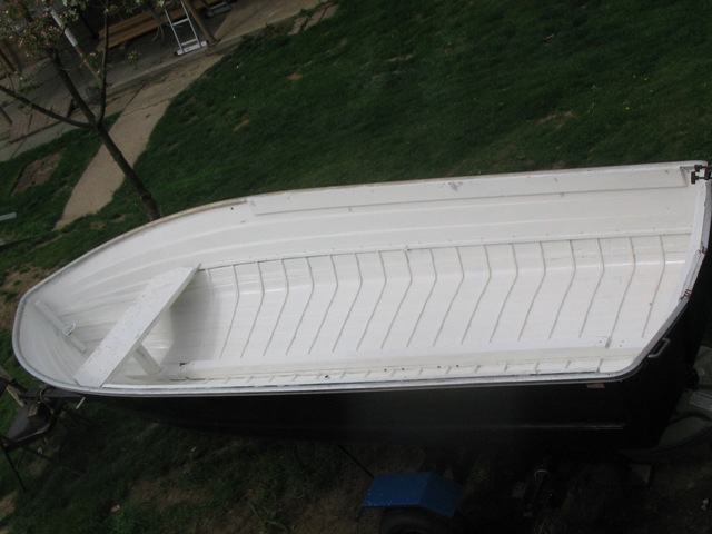

Ok Here's my recommended formula for Rustoleum Paint for Roll n' Roll and for Spraying.
This Should yield one THIN coat on a 14-16 foot FIBERGLASS boat hull.
For aluminum boats, Acid wash the boat (lots of guys just use 50/50 mix of white vinegar and water) then use a Self Etching Primer. I like SEM's Self Etching Primer, and apply it on ALL bare aluminum spots and then coat the entire boat with Rustoleum's' Bare Metal Primer.
If you have Deep sides you may need to adjust the amount of Paint you buy. I recommend Rustoleum's Topside Primer. IF your boat is NOT left in the water for MORE than 3-4 days at a time, this will work fine. This is NOT for boats left in the marina for the season.
This is for Roll n' Roll Application
Final sand with 180 grit and wipe down with acetone.
Two coats of Primer. Roll n' Roll technique is the same. Thin coats!!!
2 cups Paint
1/4 cup of ACETONE or if the temp is over 80 degrees use Mineral Spirits
1 oz of Hardener (1/8 cup/2Tablespoons)(Sold @ Tractor Supply Stores) Or you can use the Acme Finish One Medium Hardener sold at Advanced Auto.
Wet roller with paint an roll out about 4-6 sqare feet. If you can HEAR the paint (Sticky Sound)you are rolling too long. Put the first roller in a Plastic bag and use another roller. wet it out but wring out almost all of the paint and then Re-roll the area you just painted. Use a very LIGHT stroke and the paint should lay down with NO Bubbles!. Put this roller in the bag and use the other roller again. Repeat this process untill the boat is painted. Always do the re-roll with a damp roller with very little paint in it and LISTEN. You will hear the sound that lets you know when it's time to stop. It's kind of a sticky sound. Very LIGHT rolling on the "Re-Roll"
For Spraying.
Final sand and wipe down with acetone.
Two coats of Primer. Use HVLP spray gun with 1.2mm Tip. Thin coats!!!
1 qt Rustoleum Professional Oil Based paint
1 1/2 cups of Acetone 1/4 cup of Mineral Spirits (In High Temps use ONLY 1 1/2 cups of Mineral Spirits or substitute Acrylic Enamel High Temp Reducer sold at some Auto Supply stores. I used Acme Finish 1.)
2oz of Hardener (1/4 cup/4Tablespoons) (NOTE: Only add Hardener to the amount of Paint that you will use in an 8hr period.) DO NOT use after this 8hr period.
This yields two coats of Paint.
Shoot first coat in the morning.
Wait 4-5 hours.
Wet sand with ScotchBrite Pad LIGHTLY to knock down any nubs or bugs.
Dry.
Tack cloth off with Mineral Spirits.
Dry.
Shoot second Coat.
Let dry over night
Repeat wet sand and Tack cloth
Shoot 3rd and 4th coat if needed.
HINT: If you want a COLOR that you cannot find, then you can use Acrylic Artists OIL paint from any Art supply store that you buy in tubes. Google "How to mix paint for (color you want) paint. You can get ANY Color in the Rainbow and it works GREAT!!!!
