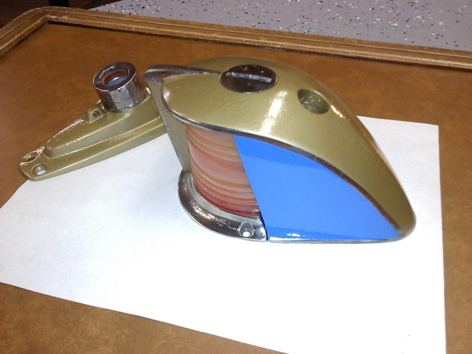

Hello boaters here is some thing you may want to try when restoring your old boat if your like me & funds are short . my bow light was terribal it was pitted & the plating was real bad so first sand or wire wheel it clean then mask of the area of your chose & use the paint you use on your boat & Hammerd paint by rut-oleum it coes in lots of collars & hides imperfections on the surface it looks great & well last a long time if you have ? just call me my name is Darrel Shannon my # is 785-643-8609 take care Darrel

looks very nice, great info. frog

Looks real nice Darrel ! What kind of boat do you have that on ? Good advice with the price of Chrome plating anymore .
