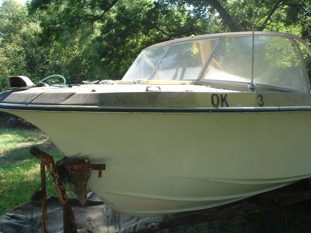

Hi everyone,
By luck I found this site. I'm new here,to my surprise there are so many like minded individuals into classic boats like myself. I can't afford a new boat but I can sure fix one up myself. I have a 22' sterncraft and a 15' something. I just bought it a couple days ago AS-IS.

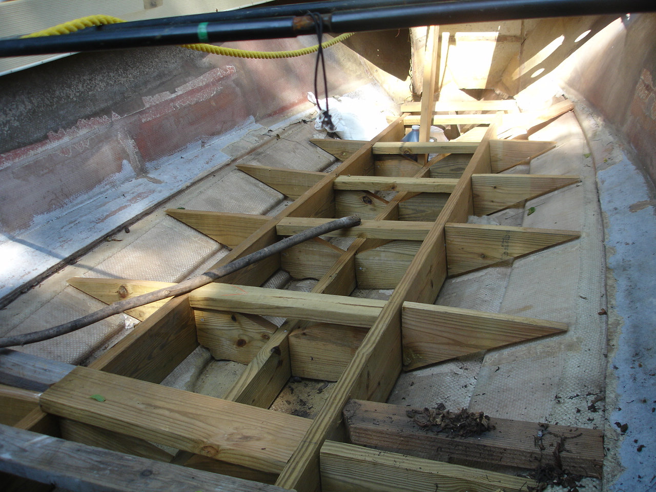

  • Karma: 1

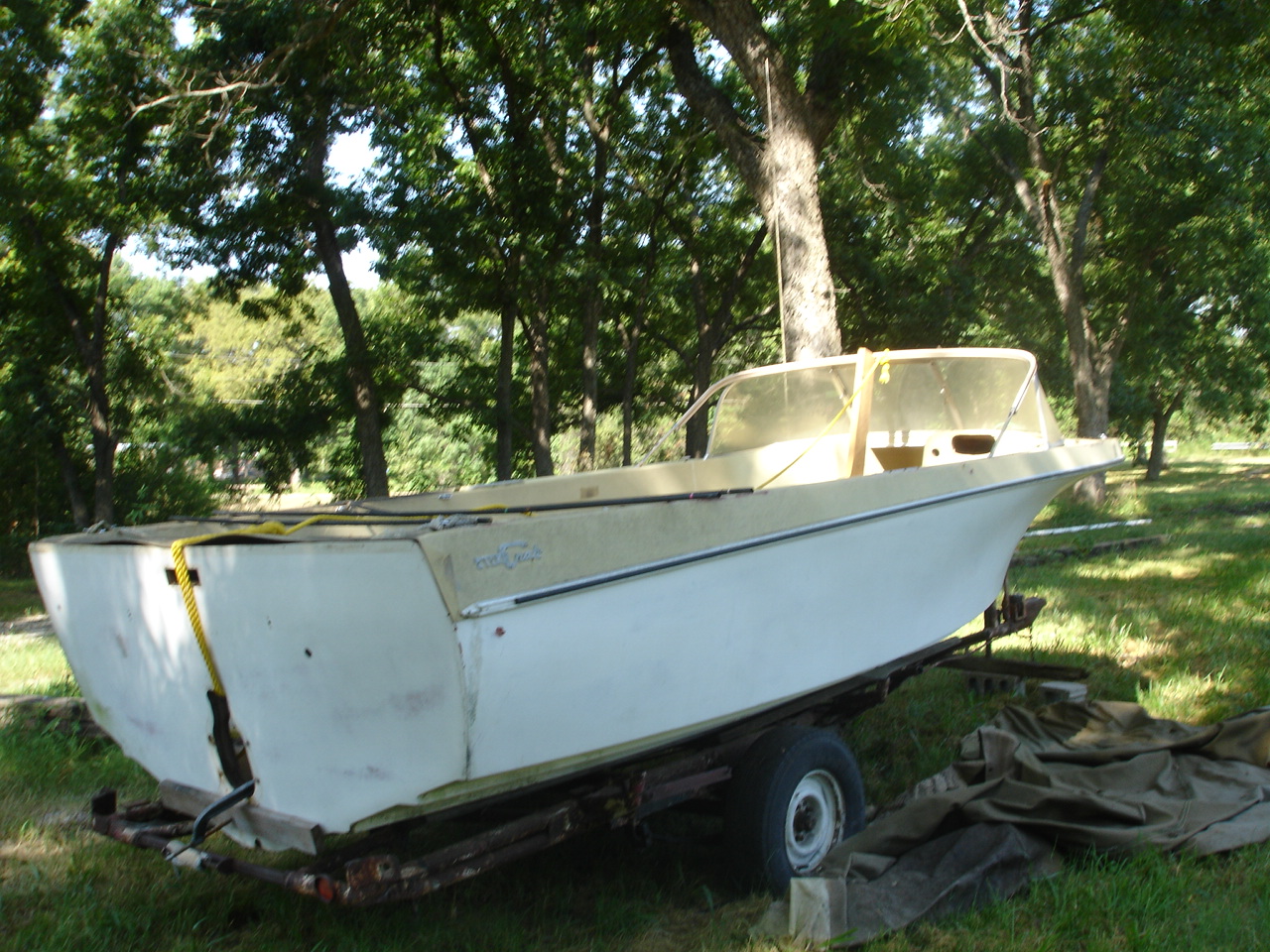

outside shot

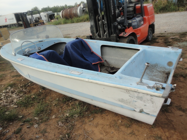

This is my other unidentified boat.

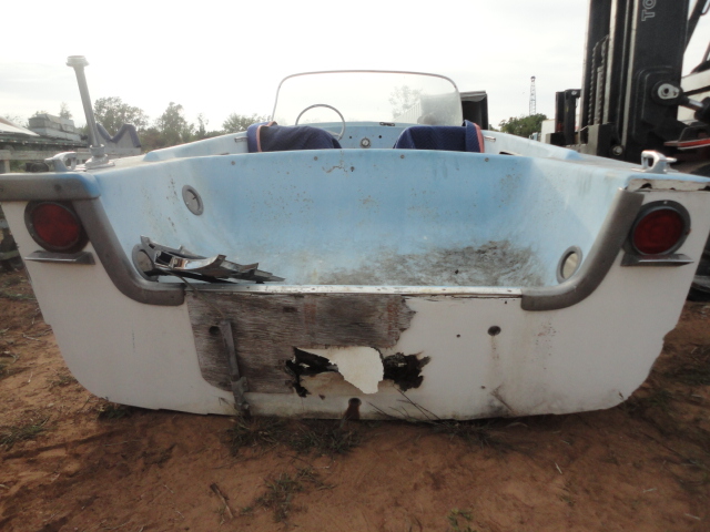

Second project

Hey guy , structurally that is awsome, and talk about the beef ( wood )but........ my first concern is....... does it come apart , and the reason being is ........doing a layup on something like that can , and will be a bitch , and from the looks of things .from what i can see at this point there are no rounded edges on any part of the stringer system which can lead to a poor lay up because fiberglass does not want to roll over sharp edges very well thus....... causing air in the layup .

Well I haven't thought of that I'll start laying the fiberglass next weekend and I'll round the edges. This is the first time hearing this.

Yeah it comes apart I just have a few tack nails holding it all together. I just didn't like what the guys in my area had to offer as far as quality. They said it was over done but I could do this kind of work no sweat. Plus I saved like 2000 dollars.

Well the blue and white one with the stripe on the side looks like a Larson as that was there trademark design.Check out the library.

Hey guy , first off .....have you decided on what resin you are going to use, fabric ext ,ext ,and have you ever done anything thing like this before....... because trying to tackle a job that size can sometimes be very overwhelming considering that stringer system over all is pretty elaborate which can ,and will be a real pain when doing your layup as is.......................

Mr. 88 You are correct, early 60s Larson All-American(note the shape of the seats under the blanket) Anyone else catch the green treated wood? :ohmy: Green treated wood makes a great deck, not so much for stringers.

in my experience, green treated lumber and polyester resin is not a good combo. My first retore/floor I used it, about the 3rd ride and it came unlaminated.
Re:Identifying Classics 14 years 3 months ago #46854
Unless you've had your green lumber around awhile it will still be a high moisture content. I used it but mine is open to the air. It does circulate under my floors. It was also dried over a long period, sealed and painted with multiple coats after it was cut. It is not glassed in and never will be. I set it up for easy deck removal for wooden keel inspection on a yearly basis. I just take two lag screws out and two people can lift the whole deck out with pedestal seats and all.
