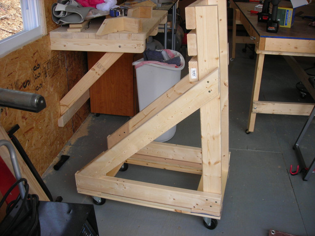

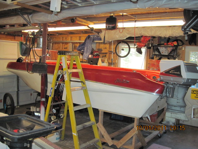

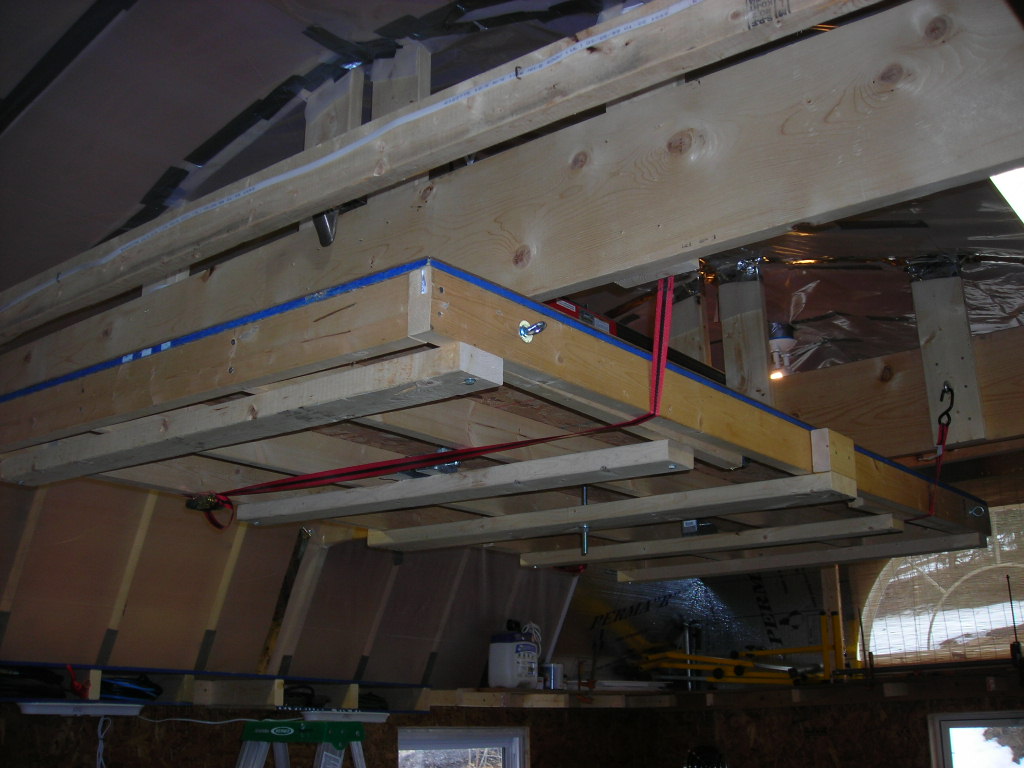

if you need tables that fold away i came up with these, because i can work on them ,then when i need room to move around a boat to spray it ,they fold up into the walls. sorry todd the pics of the tables didnt post,but you can see one of them in the background,they are hindged to the wall,and the legs lay into a 2x6 ripped at 45 degrees,when not in use the .
also since this pics is up,the motor stand was built on..you guessed it a harbor frieght moving dolly,it now has a huge satrflight v 75 hp on it.
the big table in the middle also folds up and i have a hoist in the ceiling that after its folded up,it pulls it up into the rafters,i then put rachet straps on it to make sure it stays there,lol.sorry its a little off topic but since you are getting a garage ready i thought these might come in handy they did for me,john p.s. i put almost everything i could on castors,so i can move stuff wherever i want,lol.
