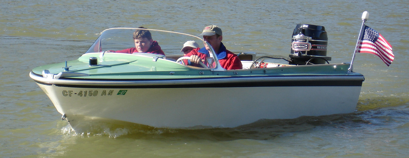

Hello, Satx:
I've got a 1958 Trident. She's in terrific shape, and as far as I can tell she's original not restored. The exception here is the motor. It's a 1971 Merc 800 making it 13 years younger than the boat.
Let me know what you need and I'll be happy to help. I've got the boat itself (probably most helpful) plus an original 1958 magazine ad and sales brochure (interesting, but nothing you can't find images of online).
Scott

Re:1958 Glasspar 15' Trident on period Dilly trailer 14 years 2 months ago #49349
Hi Satx:
I believe mine is original/correct, though I can't be 100% sure. She sure looks it, and she matches all the brochure photos, etc. that I've been able to find. I've heard that the windshield is an old Chevy Corvette one, though I can't prove that either. :) It's a real shame that yours got tossed! I think the windshield is part of what gives the Tridents such beautiful lines. And to answer your questions, yes, they're on the rare side!
If you get desperate enough to make your own windshield out of plexiglass, let me know. I made detailed drawings of mine some time back for someone else who planned to do the same. I've still got them. Can you email me through this forum? If so I'm sure I could get back to you in a more timely manner. Regardless, I can take photos if there's something specific you want to see.
Scott
