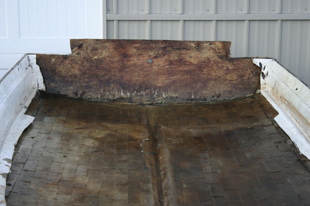

Today the RFSC went under the knife. I seperated the deck from the hull in order to start the restoration. Guys and Girls - this ain't pretty so please get all small children out of the room and have a seat.
These are the two blades I used on my multi-tool from your friend and mine - Harbor Freight. The half-moon blade was used to just go around between te deck and hull to cut through whatever buffalo slime they sealed the two together with at the factory. The straight one helped greatly at the stern, where I had to plunge into the REALLY bad full width transom.
And here's the end result.
Nw I'm not an expert, but I do believe this transom is WAY beyond shooting epoxy into it to make it strong again. The wood flaked off like thin sheets of paper.
The RFSC did have a pretty substantial transom cap on it that was probablyh there to take up some of the strength of the rotting transom. I don't believe its stock, but I may be wrong. It did have some sort of 4 digit serial number stamped into it.
[img] [img]http://fiberglassics.com/media/kunena/attachments/legacy/images/th_Transomcap21.jpg

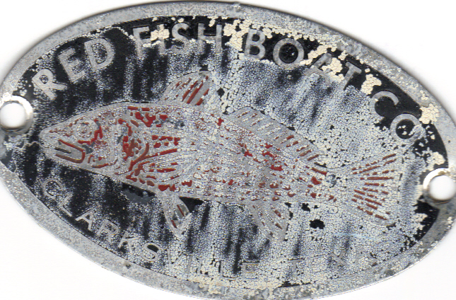

The real find of the day was the original Redfish badge. It was painted over but should clean up ok. If someone can tell me exactly where it does, I guaranteee it will return to its place on the new transom. [img] One of the primary reasons I seperated the deck from the hull was to replace the hull with another RF hull. I will be picking that hull, which is in much better shape, up the middle of the month. The original had a mysterious fire that never was explained and resulted in the damage as depicted below. [img]http://fiberglassics.com/media/kunena/attachments/legacy/images/th_Portsideburn1.jpg

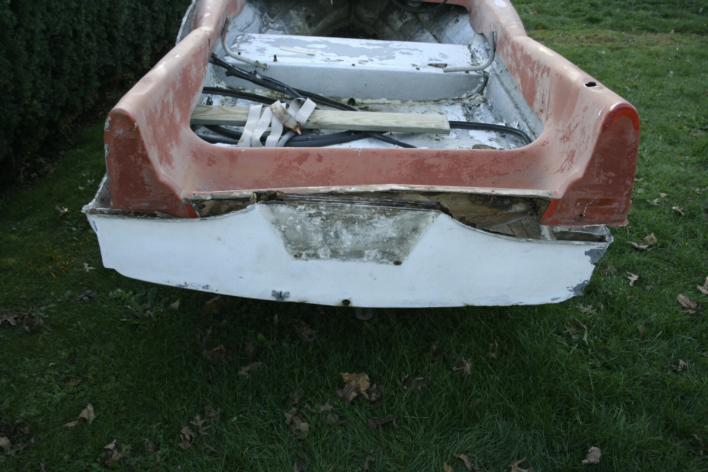

I have sliced through the connecting seam of the deck and hull and will be moving the hull inside, hopefully this weekend. The hull is in great shape. The previous owner had cut out the floor and removed the balsa wood.
The plan is to relay a new floor and refinish the hull. Simultaneously, I hope to refinish the deck from the RFSC and mate the two together so it resembles a boat.
The old hull has that bad burn issue and Donor Fish's deck is a plain Jane Shark that I don't need, but really don't want to see go in the dump. Its got issues, but its fixable.

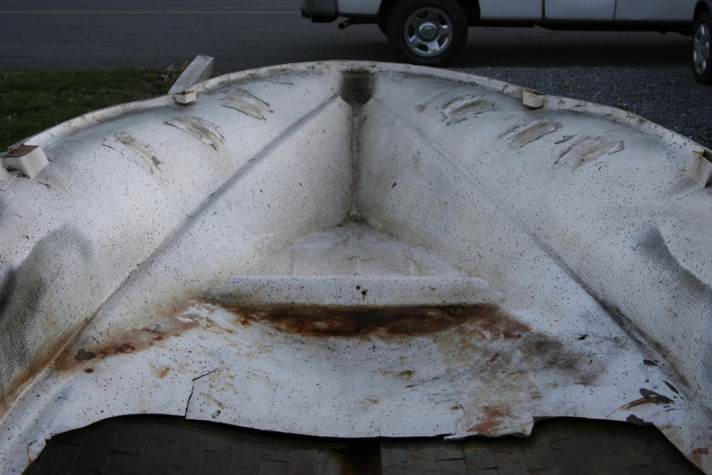

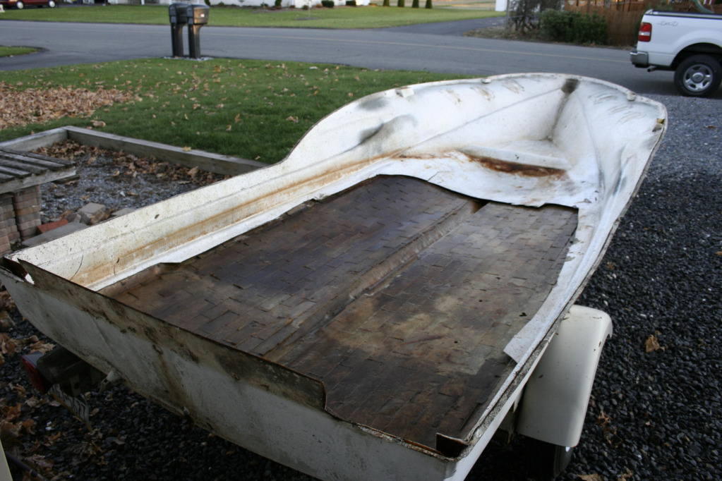

Today I finished splitting Donor Fish's deck and hull. The hull is in really good shape considering the top looks prettyy humble in places, fixable but humble.
It was a family affair scooping all the dirt and crap out of the hull. A previous owner had cut out the deck and removed the balsa wood. I cut out a bit more today to facilitate taking out the totally rotten transom. At first I thought I was in deep cotton as our southern brethern would say. The outer hull at the transom is still in great shape and strong. Then it hit me...
The spae of the hull of a Shark Capri has swooping lines leading up to the transom where the engine mounts. (The last pic is the Shark deck sitting on the original Shark Capri hull) The standard Shark has a squared off transom at the top. I believe I have enough material on the Shark hull that I can trace the Shark Capri hull design on it and cut it to that shape. If not, I guess it will mean major surgery to rebuild the outer skin.
Of course there are a few pics of the hull and two illustrating the differences in the transom shapes.
Now if the sow will hold off until I can get the mounting frames built in the shop on which the deck and hull will rest while being redone.

And what do you mean by "original RedFish Badge"?
Can you elaborate. Your photo is sooooo small.

The tag I found is just a Redfish Boat Company oval tag. I scanned it and have included it here. Its nothing more than a manufacturer's tag but I think it will be a cool original addition to my redone fish.

That RedFish tag is awesome. Mine was either previously removed or did not come with one. It is the first time I have seen one. Where was it affixed?

I found the tag on the starboard side of the transom, inboard of course. I believe it was a couple inches from the top of the transom, but the transom was noithing but flaking wood when I got to it and just fell apart all over the place.
