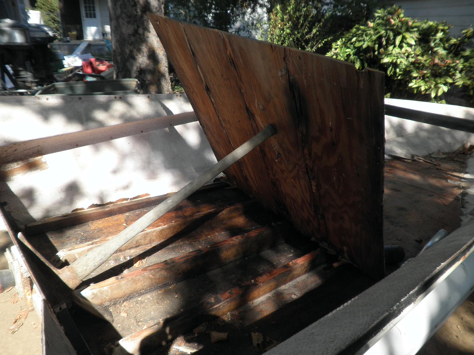

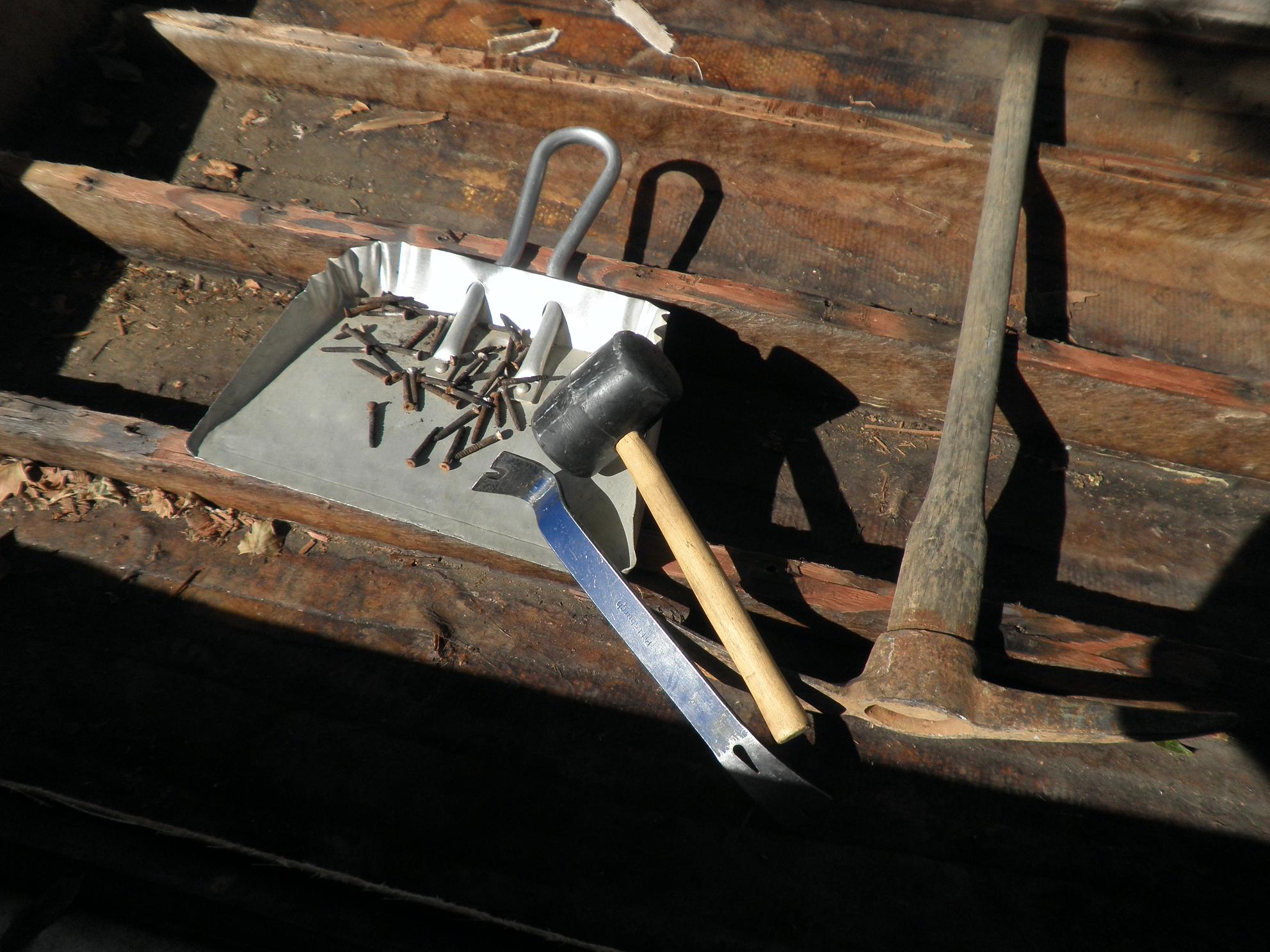

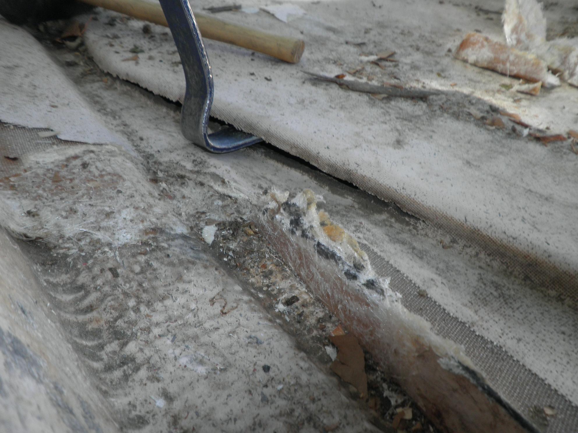

All of these ways will work just fine. As the old saying goes, there is more than one way to skin a cat. Just for clarification, the method I suggest does not involve any excessive prying at any hull to floor joint. I've taken enough boats apart to figure out what method works best for me. The use of power cutters is fine, but it creats ugly dust, especially if you use a grinder. As John and others mentioned, the use of a power tool requires that you are very careful to prevent the tool from penetrating the hull. In some places on certain boats, a power tool is the best / only option. You have to use your judgement on that.
Most people would be surprized how easy it is to break and tear tabbing and roving away from a joint. You just have to practice it a little to see. The object is to find a weak spot in a lamination, and then get a wonder bar under the glass & start working the glass away from the wood. Ginger is correct, if you use a lot of force with the shoe of a crowbar against the boat, it can cause spider cracks. Just do small sections of tabbing / glass with the wonder bar and rubber mallet. If the tabbing can be bent 45 to 90 degrees from it's original position, it will crack & can be torn away. Leaving very little dust & allowing the wood to be removed. If the glasss was new, this would be pretty tough to do, but it's usually old and brittle.
Take a close look at these 2 photos of my Reinell - the skin & tabbing were completely and cleanly torn away from the floor. Plywood left completely intact, good for pattern making. No damage to hull, very littl clean up.
Just wanted to share this, because it works great & makes less mess - less risk.
In the end - as long as you can get her apart, how you do it is completely up to you. Good luck & please post progress PIX

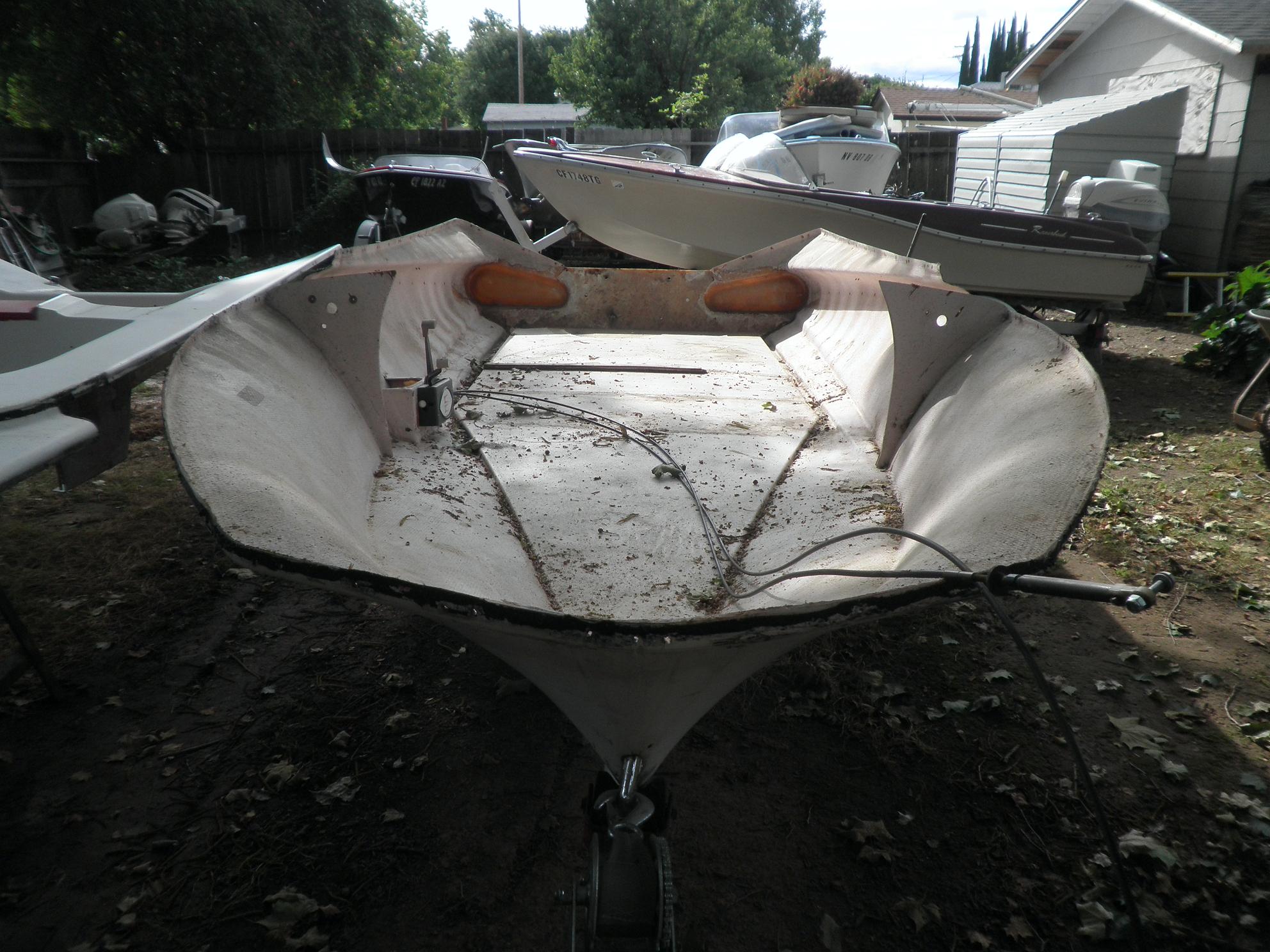

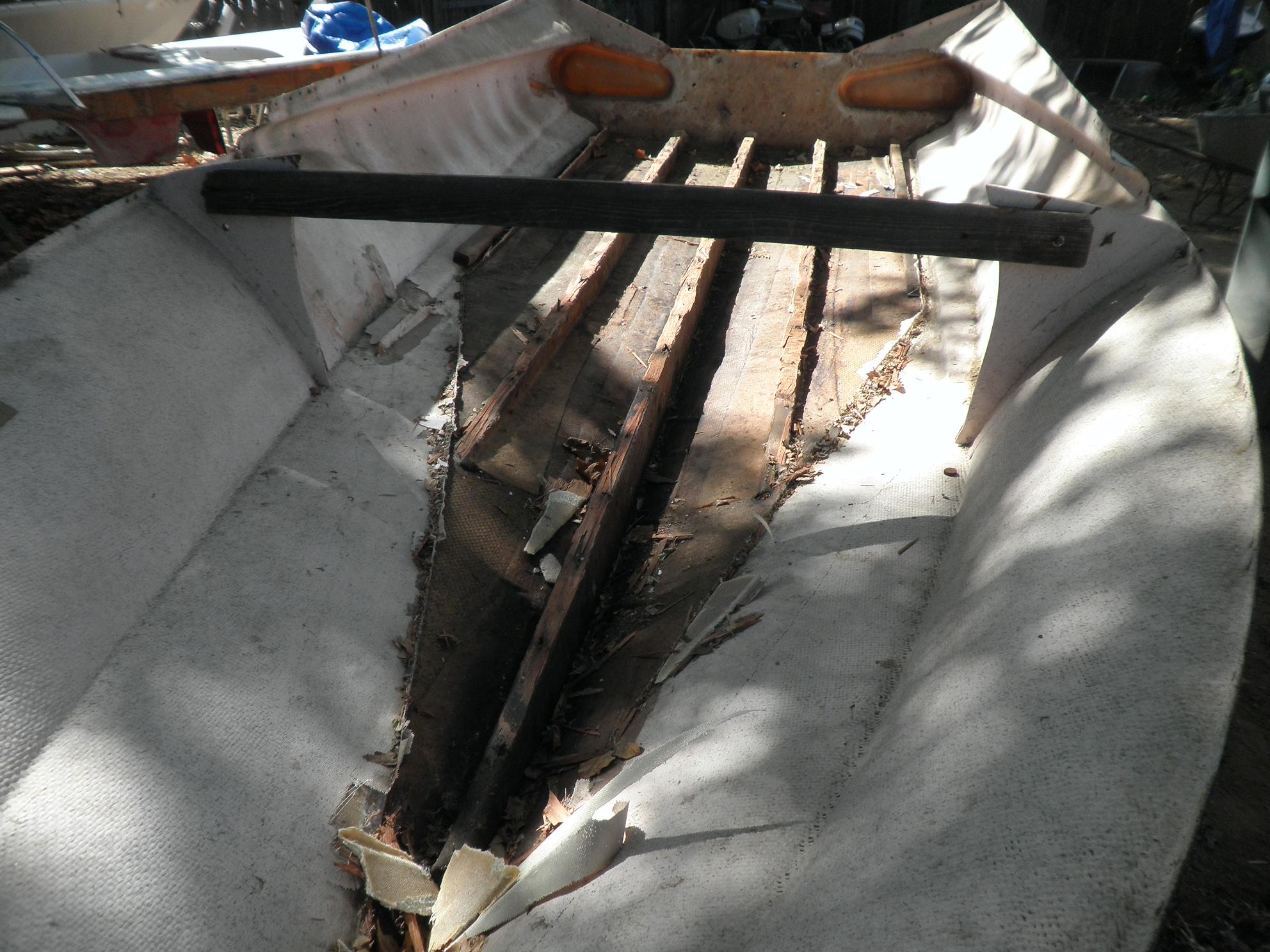

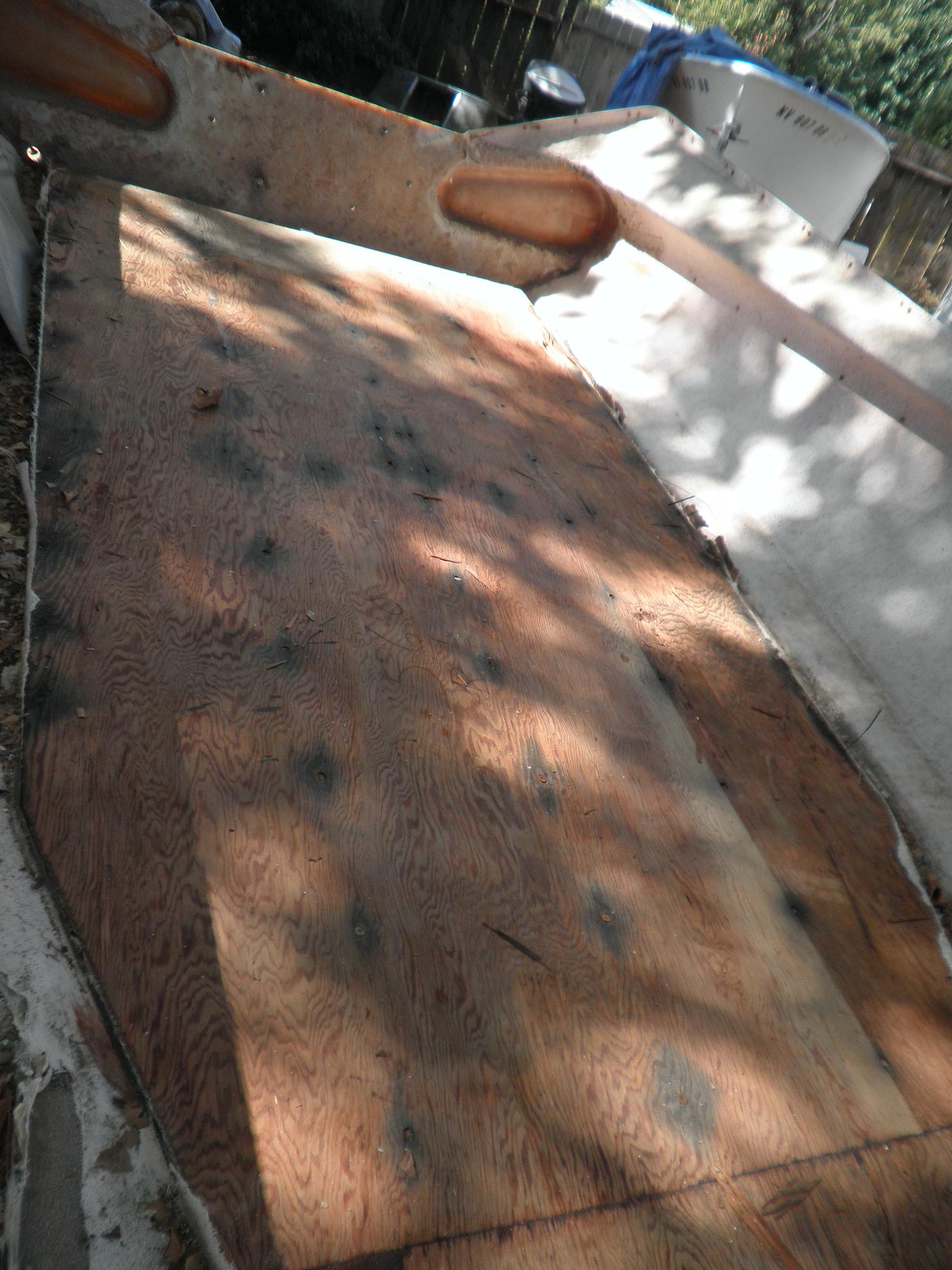

Thanks for all the suggestions! i really am glad i found this website, what a great resource to get tips from all of yall. heres some pics of the boat when i got her...i post more of the progress later. thanks again!...sorry can't get pics to upload...
Re:dorsett catalina floor removal 13 years 8 months ago #46557
bhben,your pics are probably too big go to the support forum,it should tell you how to post your pics,john
