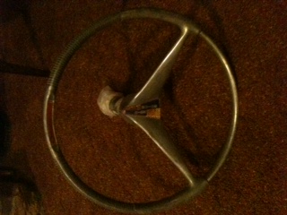

Hi All, I'm trying to paint my wheel with poor success so far. I was told by the paint supplier that I could prep the bare aluminum wheel with acetone and paint polyuethane straight away. Didn't work. Poor adhesion. I'm back to bare aluminum and was then told by the paint supplier that I should prime with epoxy primer and then paint with polyurethane straight away. MadProps I believe you and I have the same wheel and you have recently painted yours. I don't want to use the same epoxy primer that I used on my trailer on my wheel because of the "gap filling qualities" of the primer. I don't want to lose the definition and clarity of the ribs on the top of the wheel. Is there an alternative primer and paint that will honor the ribs on the wheel? Sorry about the crummy picture. Thanks in advance.

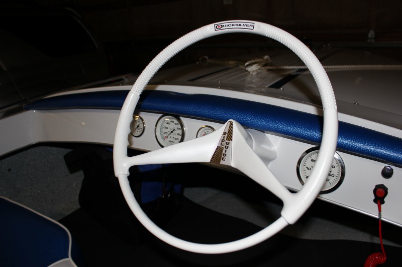

I used a textured white powder coating on the wheel and mount, becuase of long-term durability, but the problem was that there was a minimum batch charge of $100 which made it kind of expensive.
One word of advice if you go this route, be sure that they dont get powder coating inside the mount where the plastic bushings seat... happened to me and the bushings didnt fit. It was a real bitch to scrape out.

Hi Bruce... Mine was all busted up... I found that Joe Poole has access to NOS emblems... so that is a brand new one in the photo. (I bought a spare too). He is on FG but can also be contacted through his website www.fergusonpoolemarine.com/

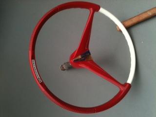

Well I think I'm finally done but not without incedent. I now have a whole new respect for you guys that paint these wheels all the time. Overspray, runs, scratches, you name it. It seems like a hundred different things that you have to look out for in order to do it right. The last thing that went wrong for me was I hung the wheel up face down to dry and some of the paint welled up around the emblem. When I went to pull the tape off it pulled up a tiny bit of the red with it. But like I say I think I'm finally done. Thanks for everyone's help.

Wow! Nice job!
Frank
Re:A call out to MadProps and John G and whoever else 14 years 2 months ago #48476
shipster we all have some type of problem doing this stuff,especally the steering wheels when they need filler,everything is round,lol,so its almost all hand sanding,it looks great,you did very well.
