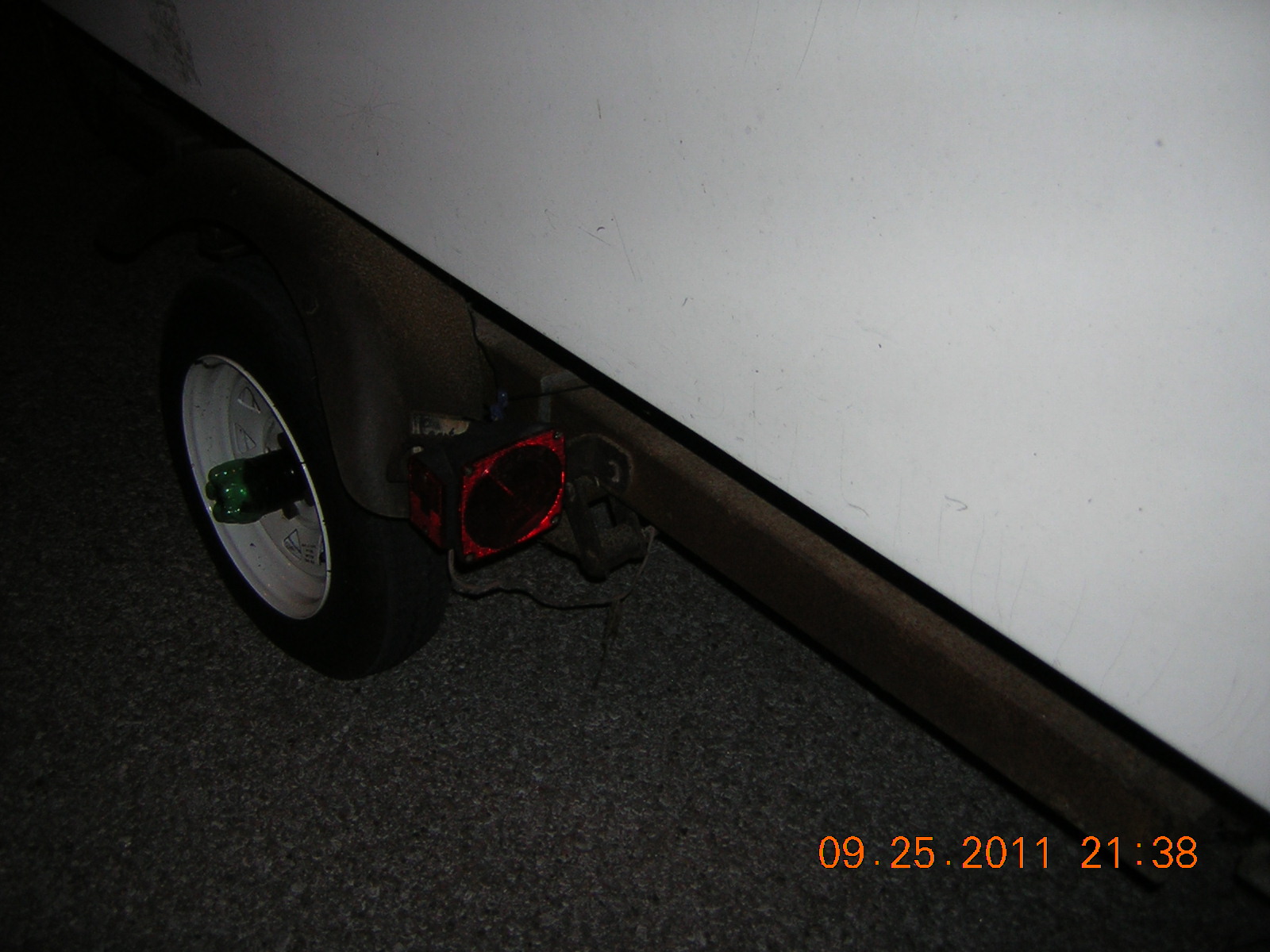

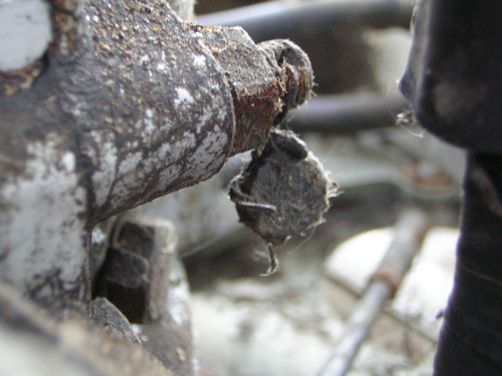

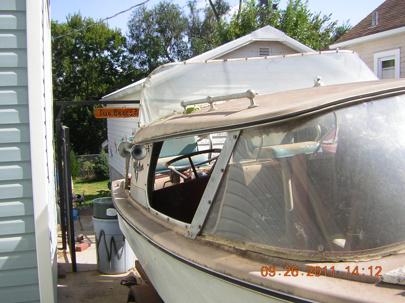

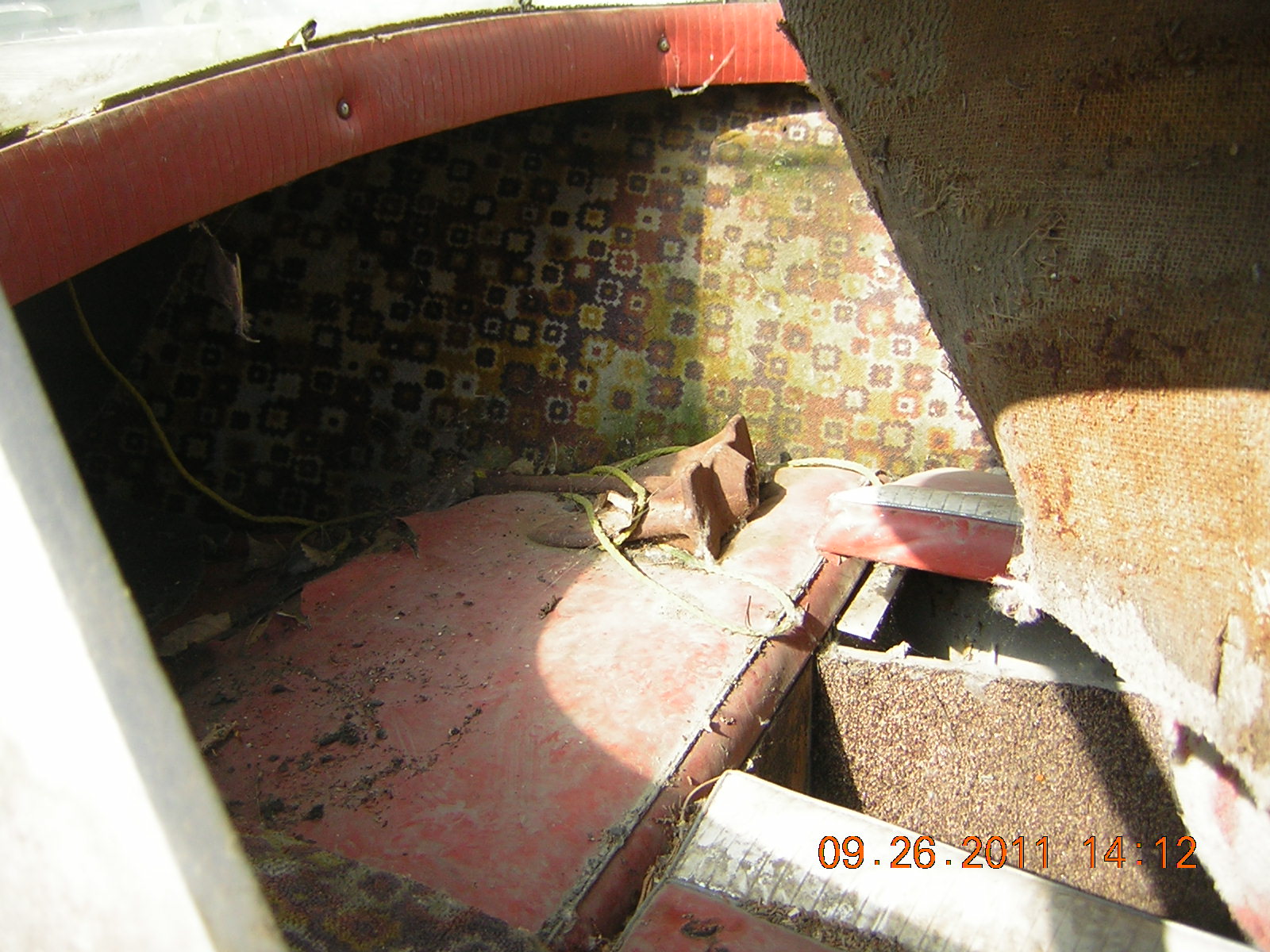

Picked up this little gem on sunday. only had to spend 8 hrs on the road. I had a small problem with a bearing but managed to fix it. I think the boat shall be called "U Will". And the best part is it is a 800 merc Dockbuster. Some idiot painted it black.
Re:U WILL 15 years 1 day ago #45657
#8 down is the emergency bearing dust cap...a SODA POP Bottle and some electric tape.

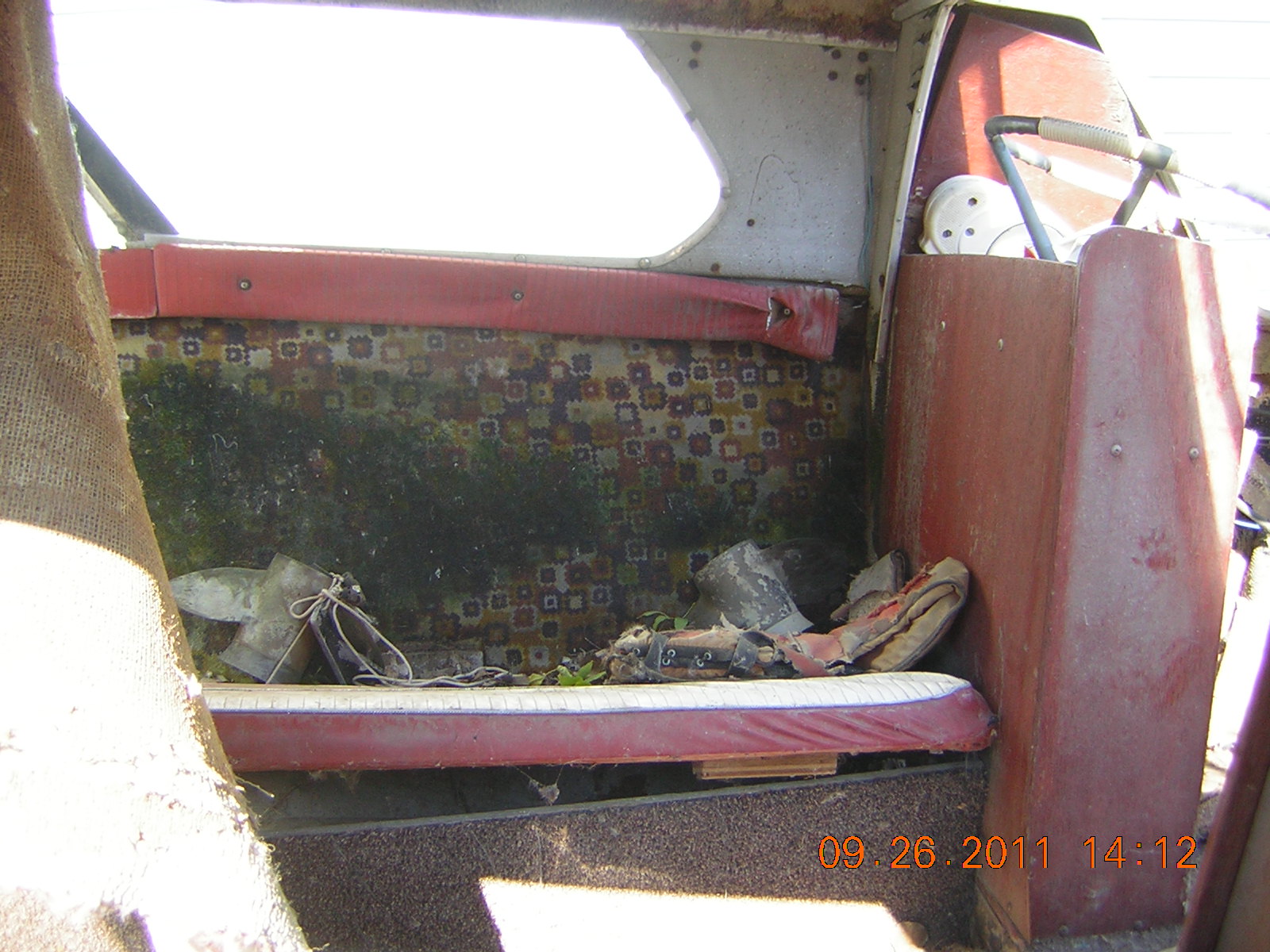

These are just afew pics I took of the boat. It is a 67 Crestliner Explorer. Picked it up for 200.00 . The driver side bearing cap was gone so I just shot abunch of grease in it, cut a pop bottle top off and taped the hell out of it to the hub. Stayed on all the way home, over 100 miles. Found out today after i took out all the mouse nests that it is a 800 dockbuster. 60/61 vintage. even found an old registration card and the key for the controls.

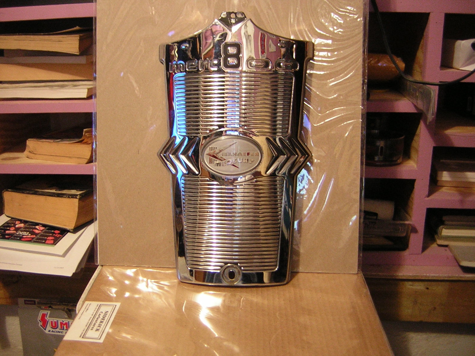

Unless I missed it in the pics, did you get the faceplate for the 800? Was it painted also?

I think skipy missed your question, but the face plate is fine and still looks OEM.

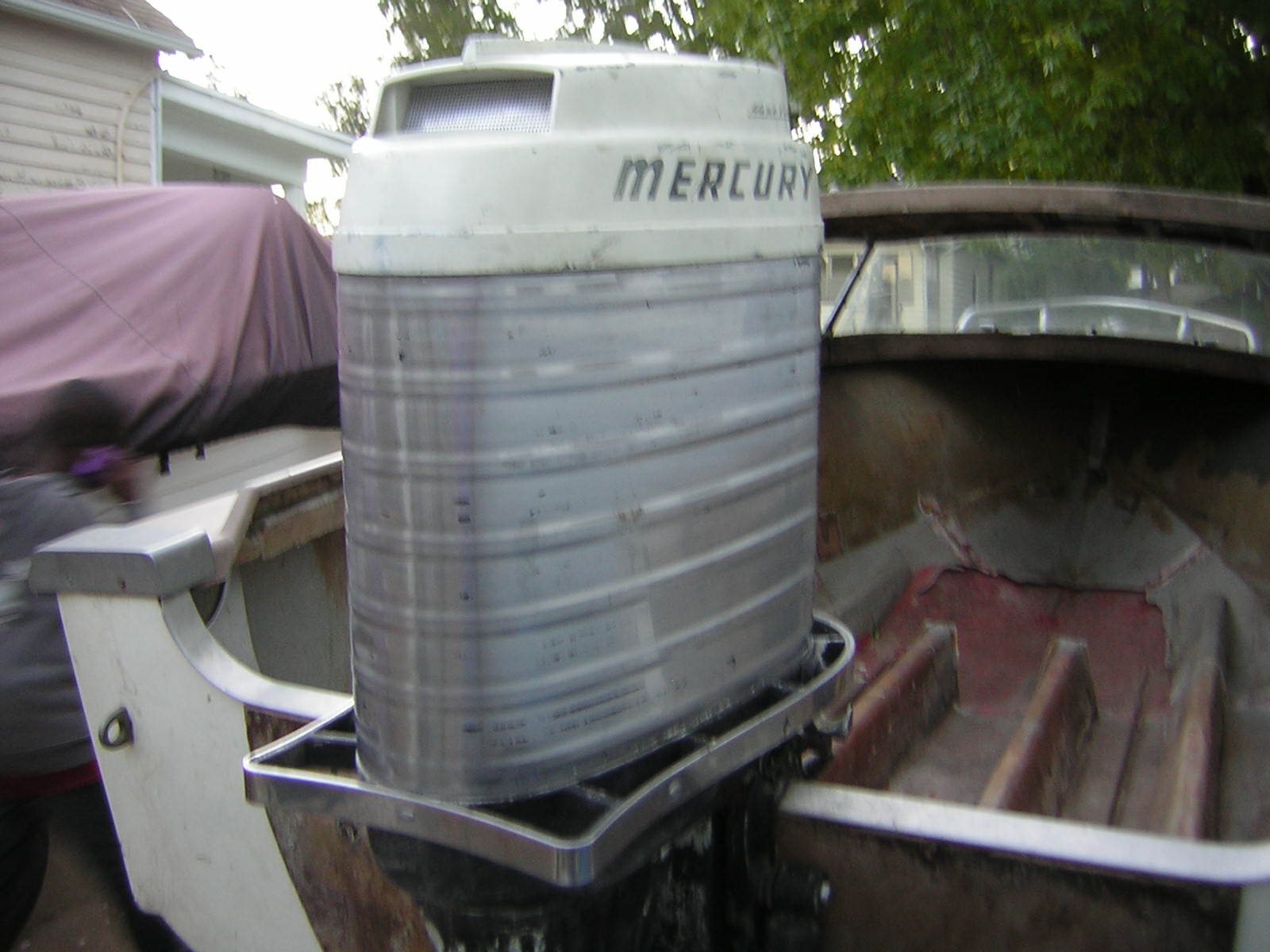

Re:U WILL 2 15 years 6 hours ago #45794
Here is a pic of the 800 merc faceplate that you were inquireing about.
Re:U WILL 2 15 years 5 hours ago #45797

The face plate looks good, one less thing to fix, right?

Hey Skip,
That faceplate is a work of art in its own right. Heck, I'd have to debate hanging that on my office wall it so nice. Seriously. You hit the lottery with that one.

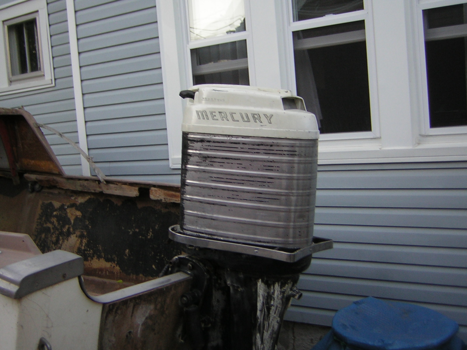

Yea, I kinda lucked out with the face plate. It was just laying in the motor well, face up and all shiny. Gonna rebuild this boat,its kinda rough right now but it should be a good project. I do have one question, has anyone ever tryed to pull start a dockbuster? Just think about that one. :unsure:
Re:U WILL 2 14 years 11 months ago #45915
Well after a little reserch on the motor tonight I have found out that it is a 700 dockbuster not an 800. Soooo now I have a little problem. I need a 700 face plate to replace the nice shiny 800 faceplate. Any takers out there?

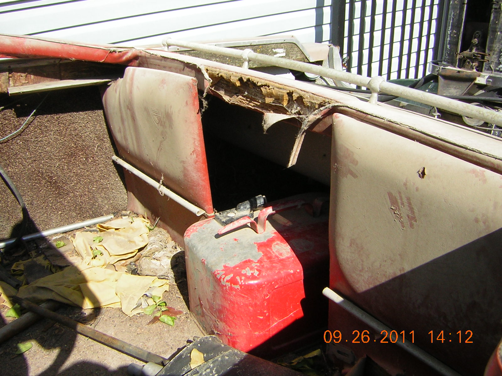

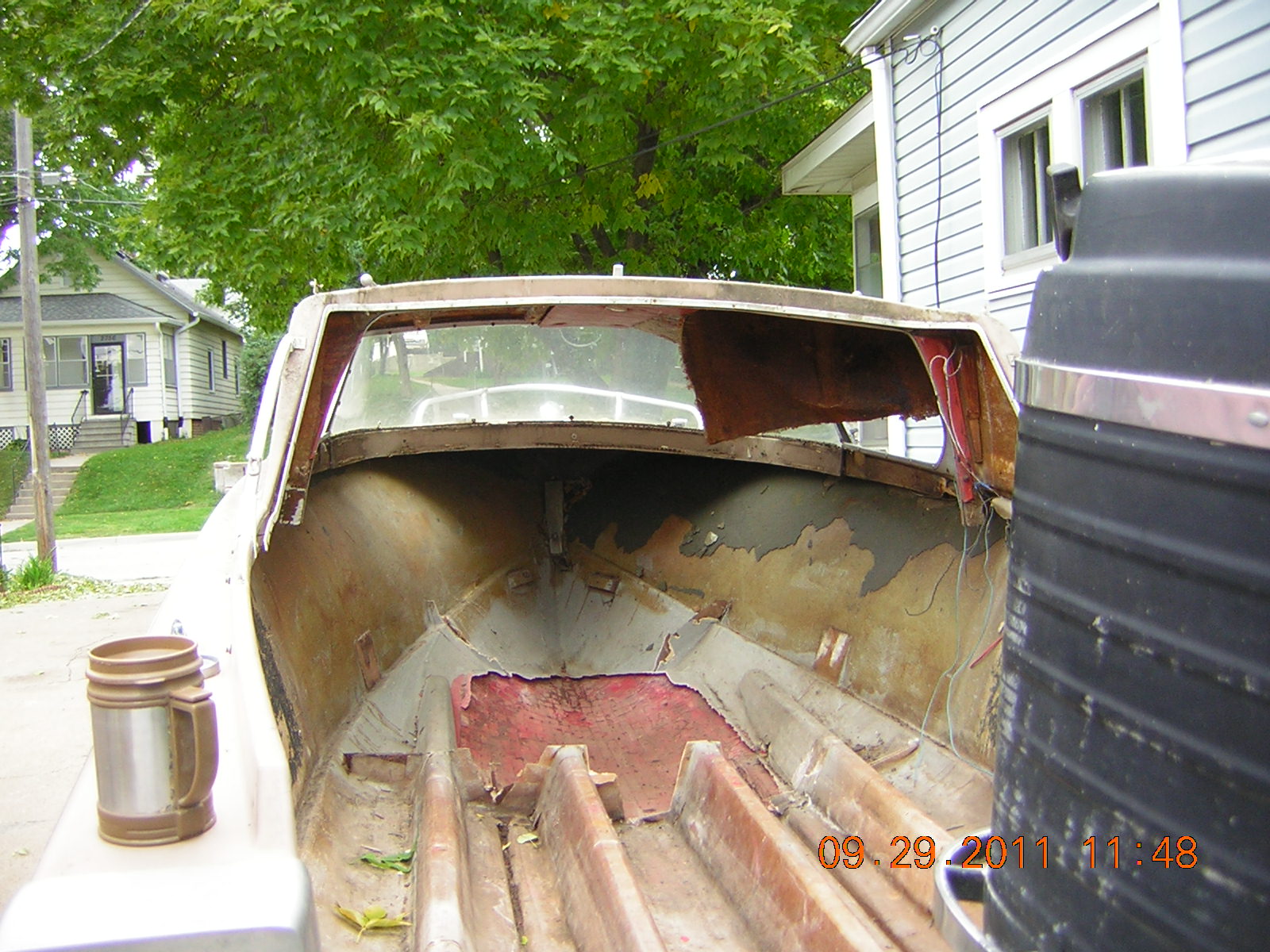

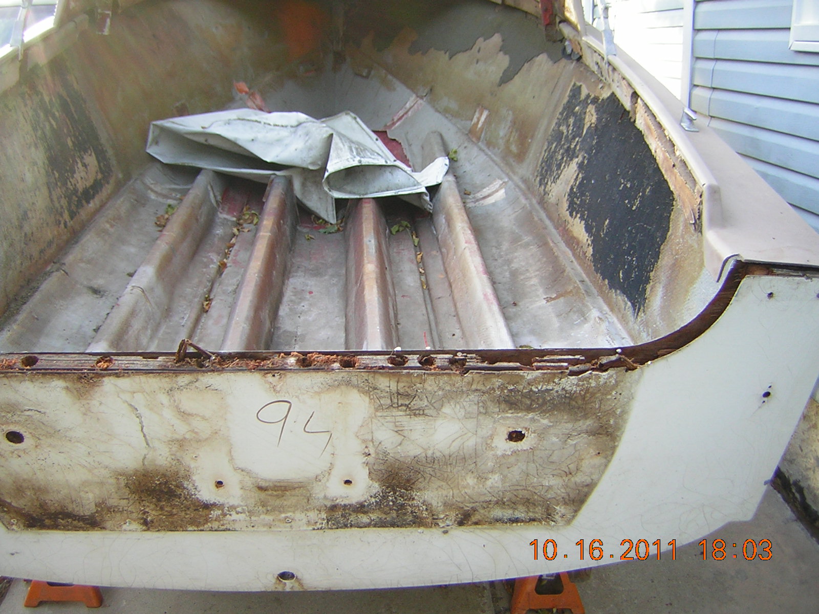

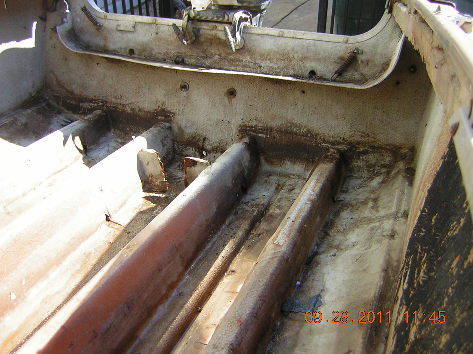

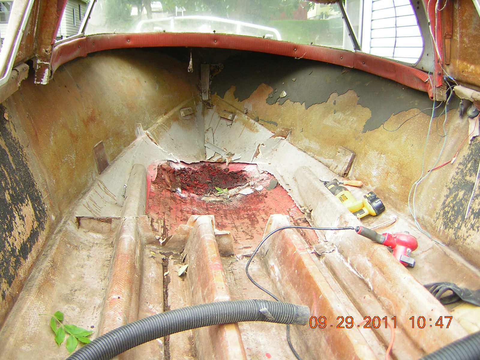

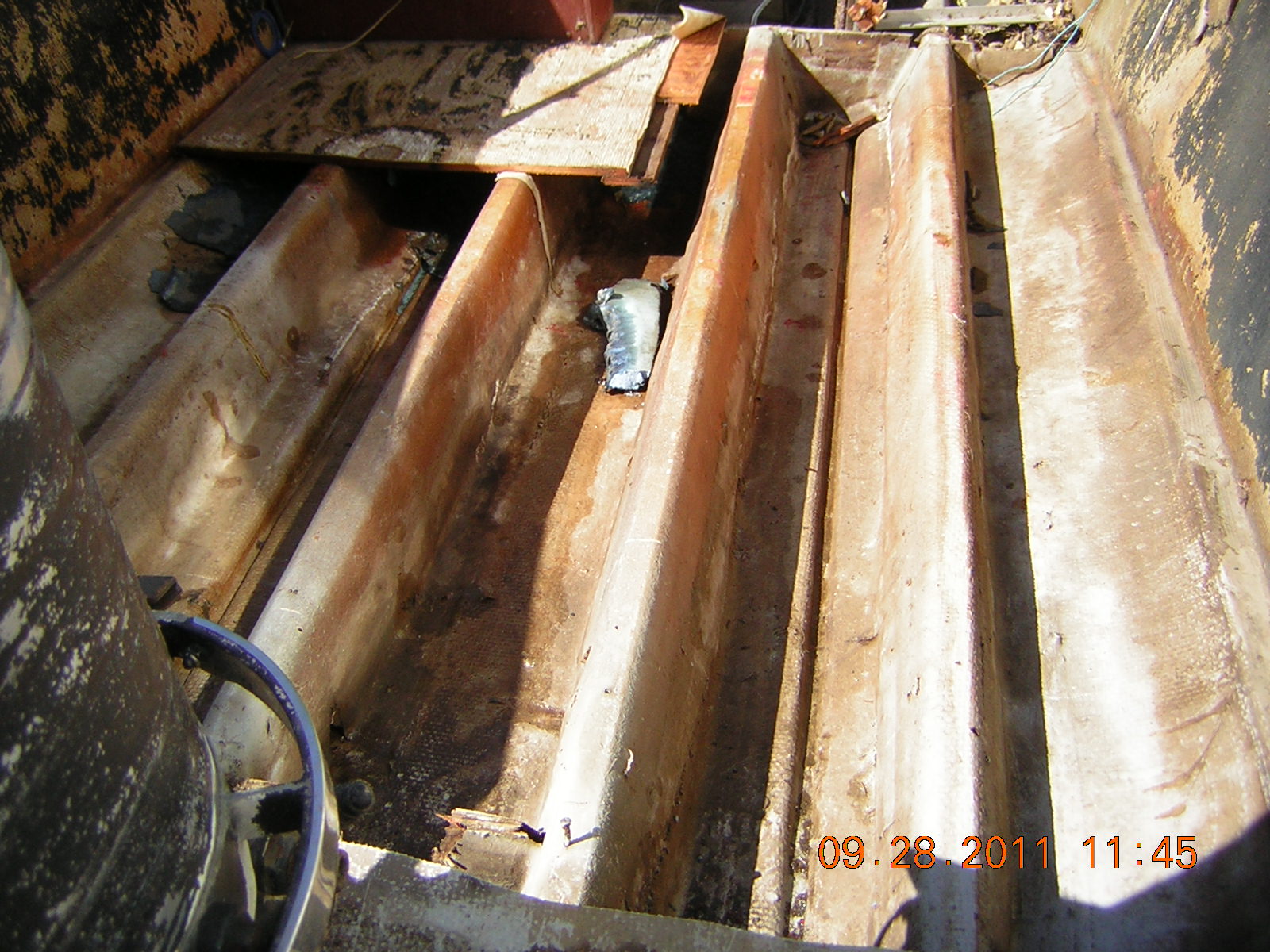

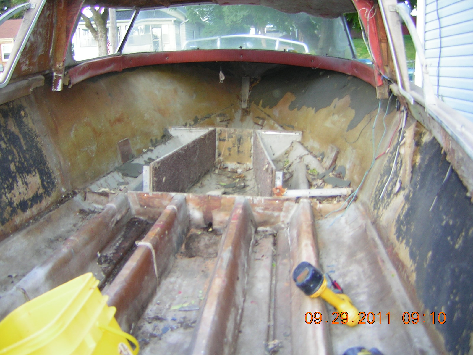

Here is what I did this morning before I went to work. Got the interior ripped out and cleaned up.
Re:U WILL 2 14 years 11 months ago #46027
Dude...wth is all that red stuff that was under the bunk area...did you cut yourself or something?
if that's blood.I sure hope you made it to the ER....
NANANA..I figured it out...that's where hoffa was ...
Re:U WILL 2 14 years 11 months ago #46028
wow skip,you dont mess around,that was fast,and its looking good,john
Re:U WILL 2 14 years 11 months ago #46036
Looks like you're going right at it Skip, won't be long at that pace. I'm glad to know we have a canoe, as we may very well need it if we get mush more rain...
Keep up the good work. That's gonna be one great cruiser when you get her done!
Frank

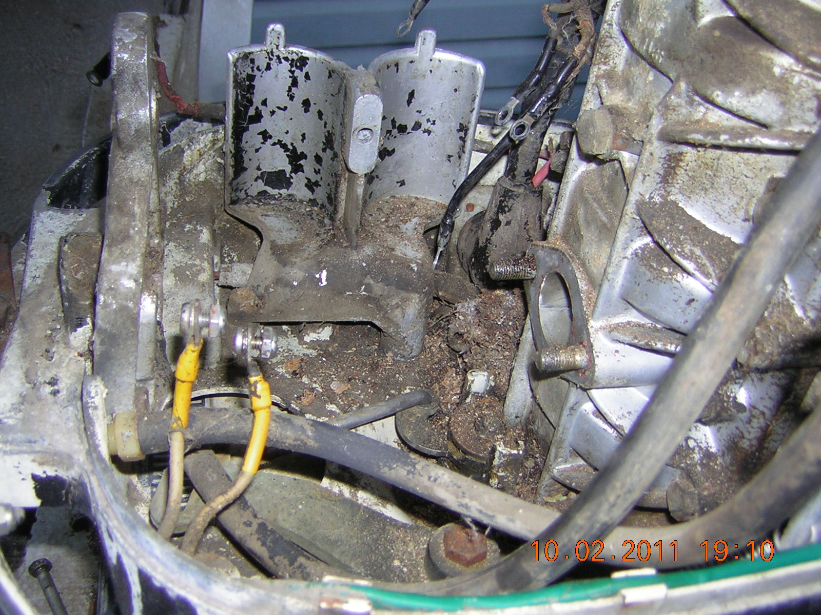

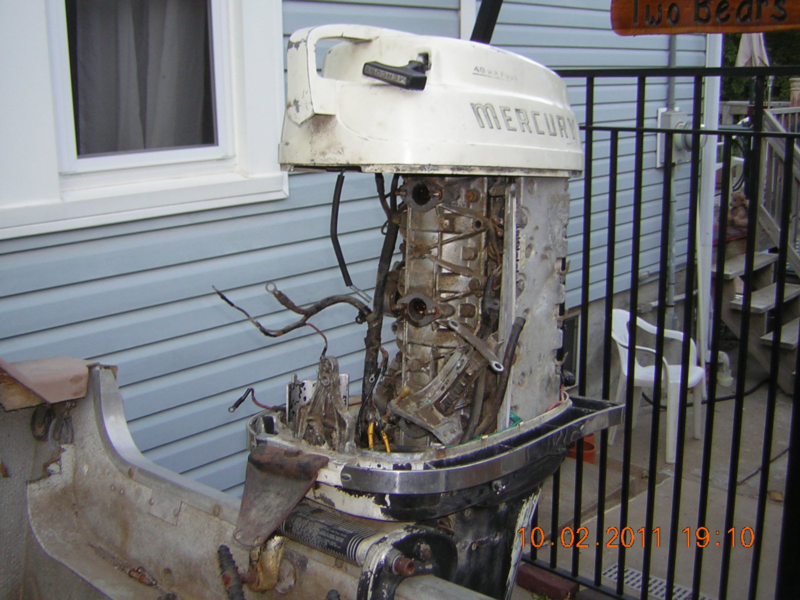

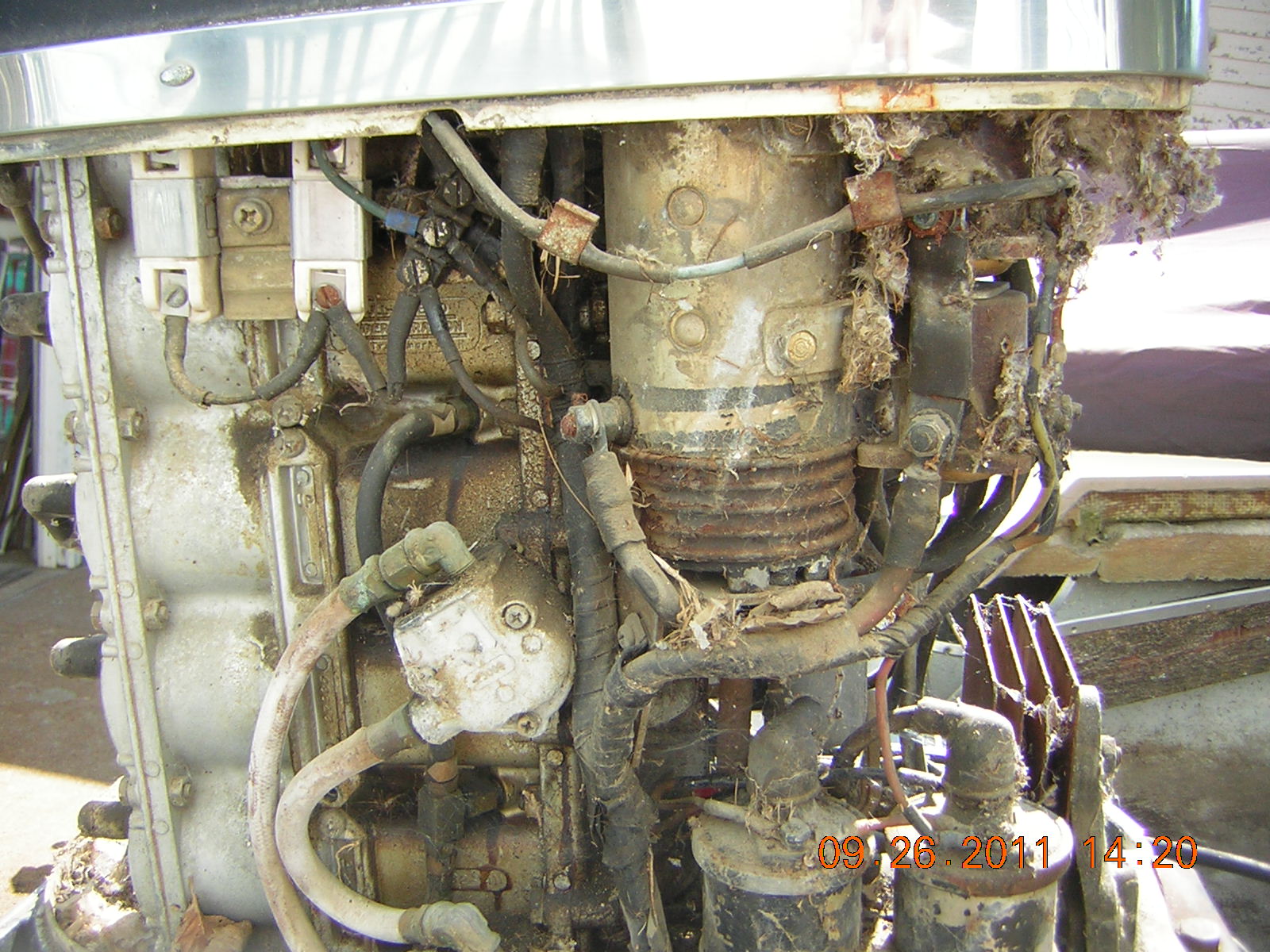

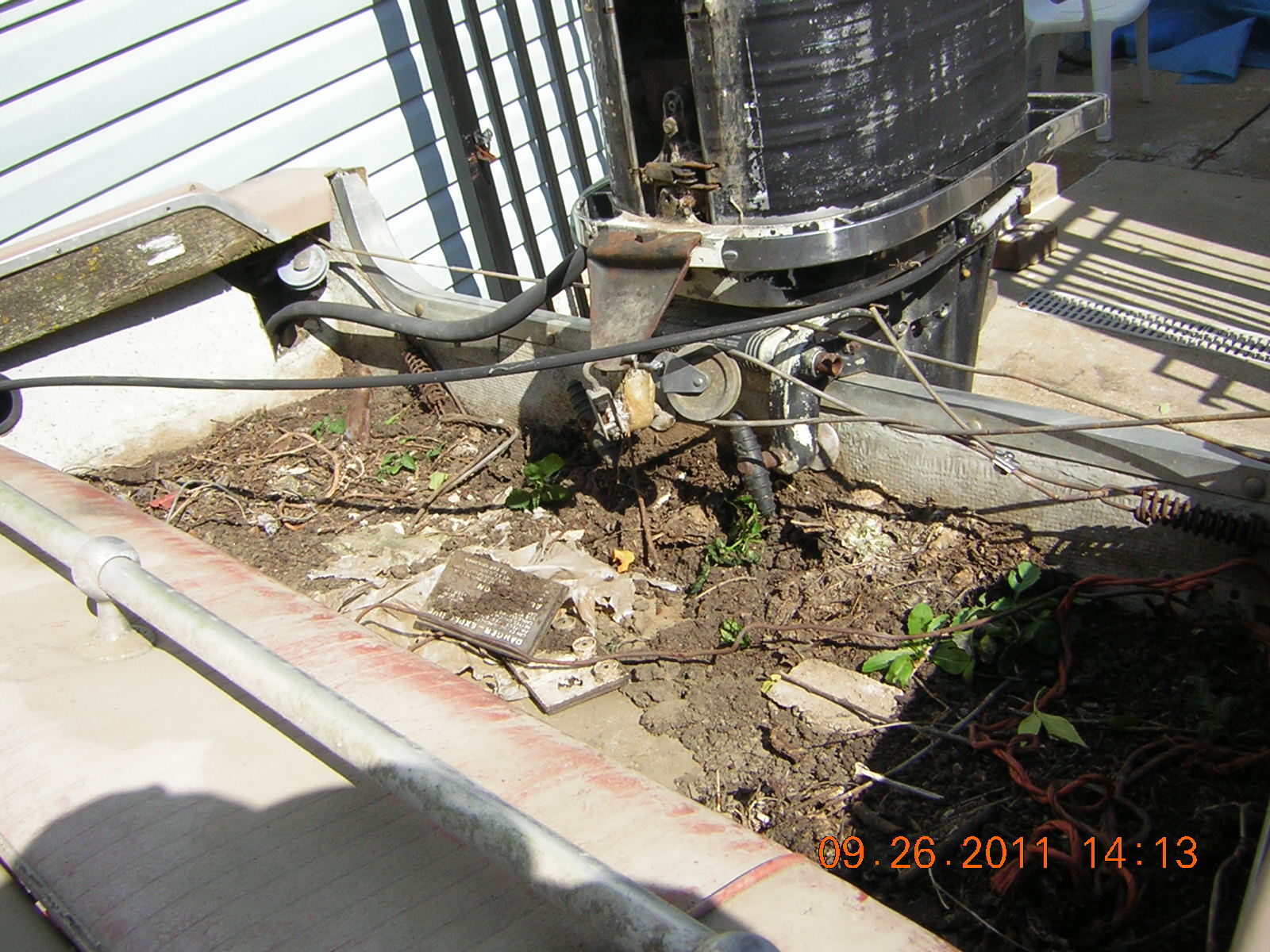

I started to pull the motor apart today. The chock butterfly are siezed solid so decided to pull carbs and starter. I have kinda forgot that nothing is easy to take off these motors. Haven't worked on one in about 40 yrs. Checked the compression on it . got 90 - 95 lbs on each cly. with just the pull start. Not to bad. I put a white top hat on it just to see what it would kinda look like. Hers afew pics.
This motor evan has the factory lead seal on it.

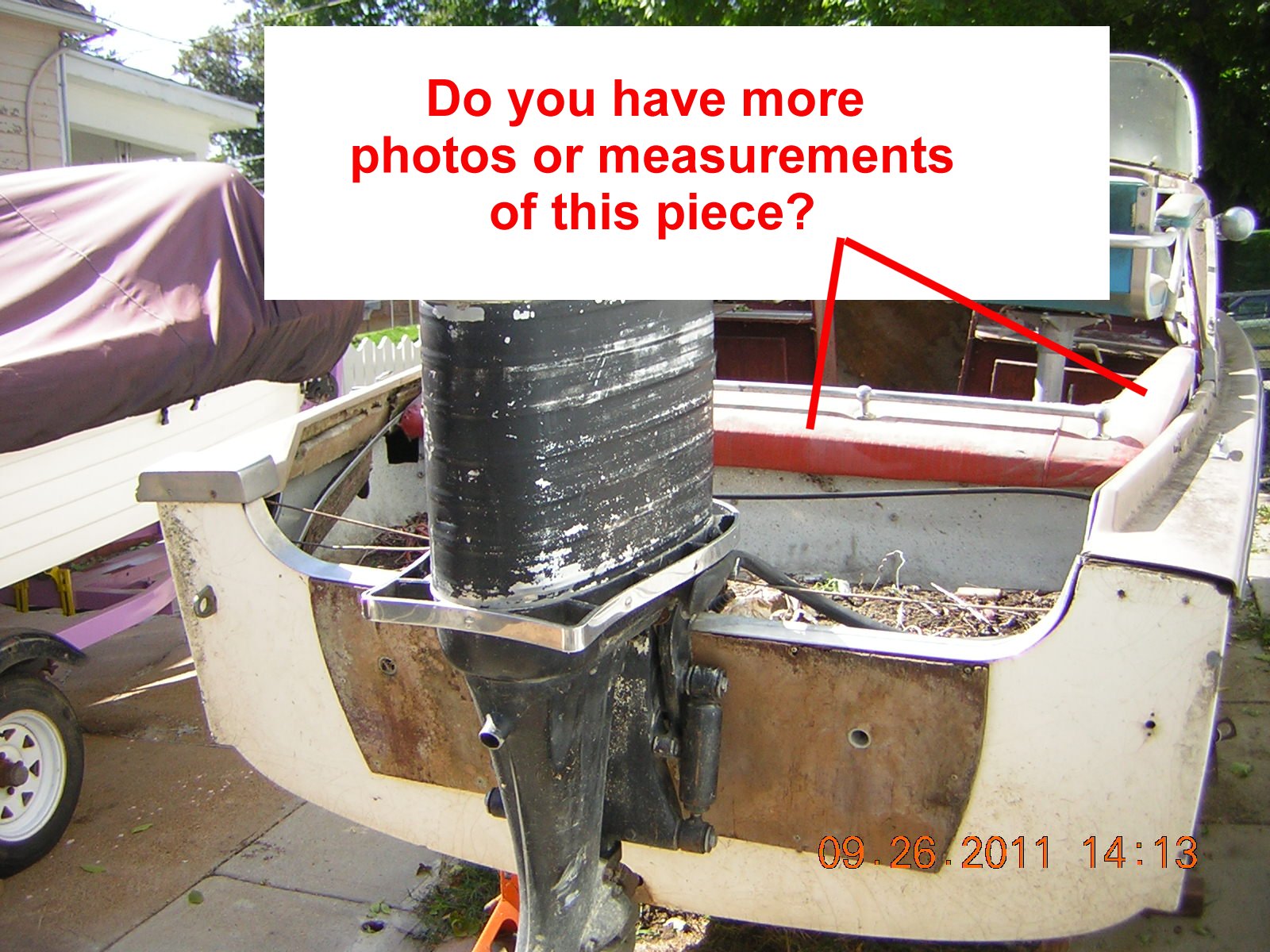

Hi Skip,
I have just joined the Crestliner Explorer club! I brought home what the title says a 1965, though I think its a 1964. The uphostered piece that i indicated in you photo below was rotted and replaced with a basic plywood replacement. I was wondering if you had any more photos of this piece or measurements that would help me to reconstruct the proper piece.
Thanks,

Dean, congrates on the Explorer. They are a fairly nice boat and are really easy to work on. The rear padded cover on the motor well on mine was made out of wood and cover with vynal. It was only a piece of 3/4" plywood and the side pieces were the same. I have the measurements out in the garage and I will dig them out for you and post them. I throw out the wood as it was totally rotted out. Ther was also a 3/4" piece of plywood that went straight down to the floor that had the same covering on it. The hinges for the 2 rear folding seats were attached to it.If you got any pics of yours post them. These boats are pretty rare and I have only seen acouple more of them around. Skip.

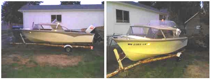

Thanks Guys!
I am really proud of myself for snagging the Explorer. I had been looking for months for a decent Dorsett Catalina, and came across this boat. The more I went back and looked at it on CL, the more it grew on me. :laugh:
I didnt get any photos before I covered it up, we are having a bit of December rain up here in the NW... and I told myself I couldnt touch it until I get my new garage finished (its getting close) so I can have a good warm place to work on it. So its under a tarp to start drying out.
Skip, you are right... these things are really rare! I have searched and searched for information... not much out there.
Its my intent to do a full restore, but this boat is going to be my Puget Sound fishing boat. I have a '59 Avalon that I am going to remove the Evinrude Etec 50, controls, bimini and all the electronic goodies to use on the Crestliner. I plan to refinish it with Awlgrip in red and white.
Here are some poor quality photos from the CL ad, I will post some in January as I move it from under the tarp to the new garage location.
Dean

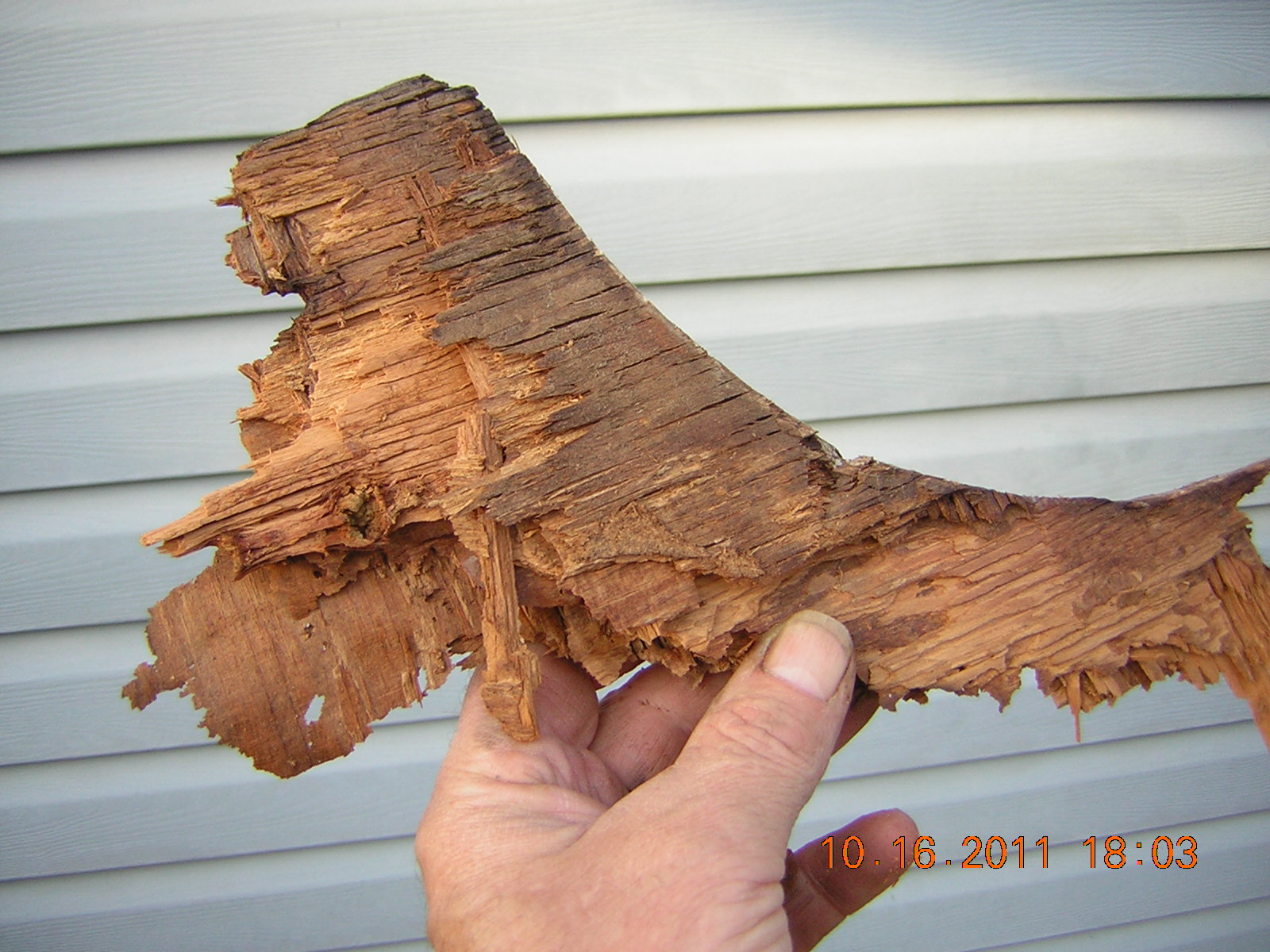

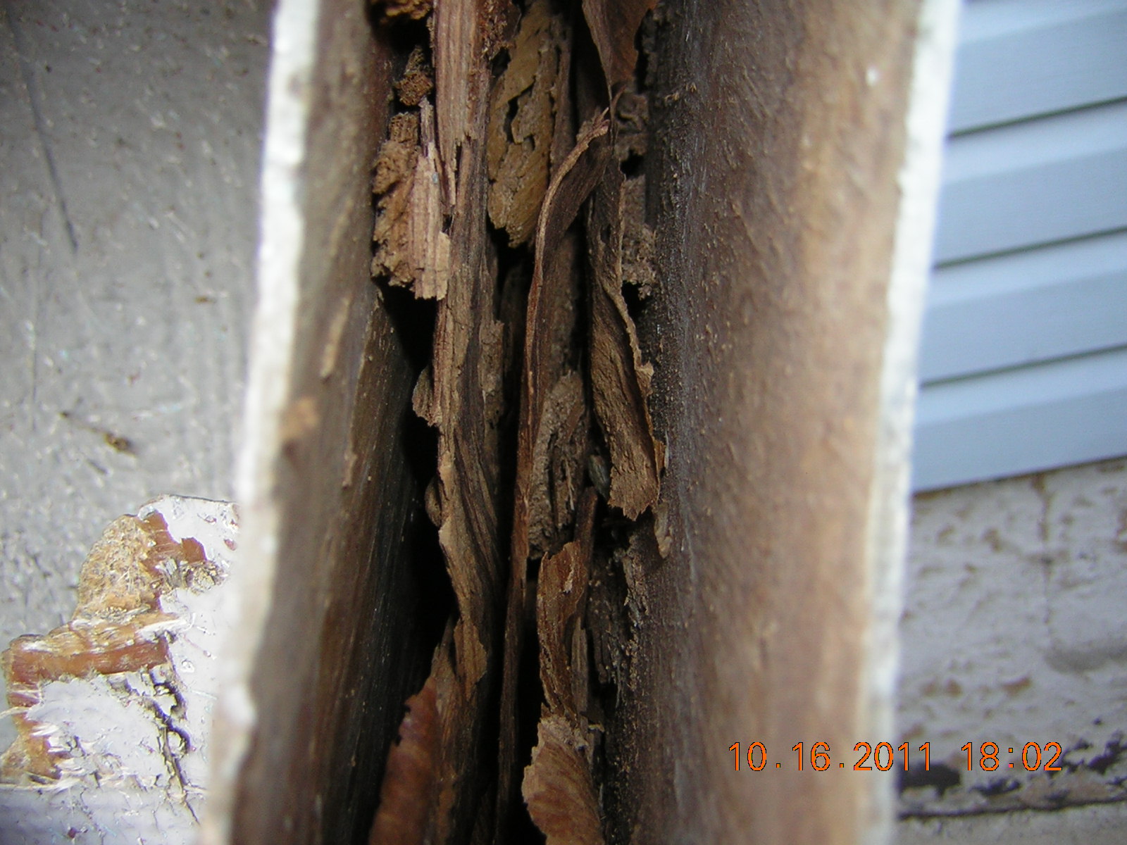

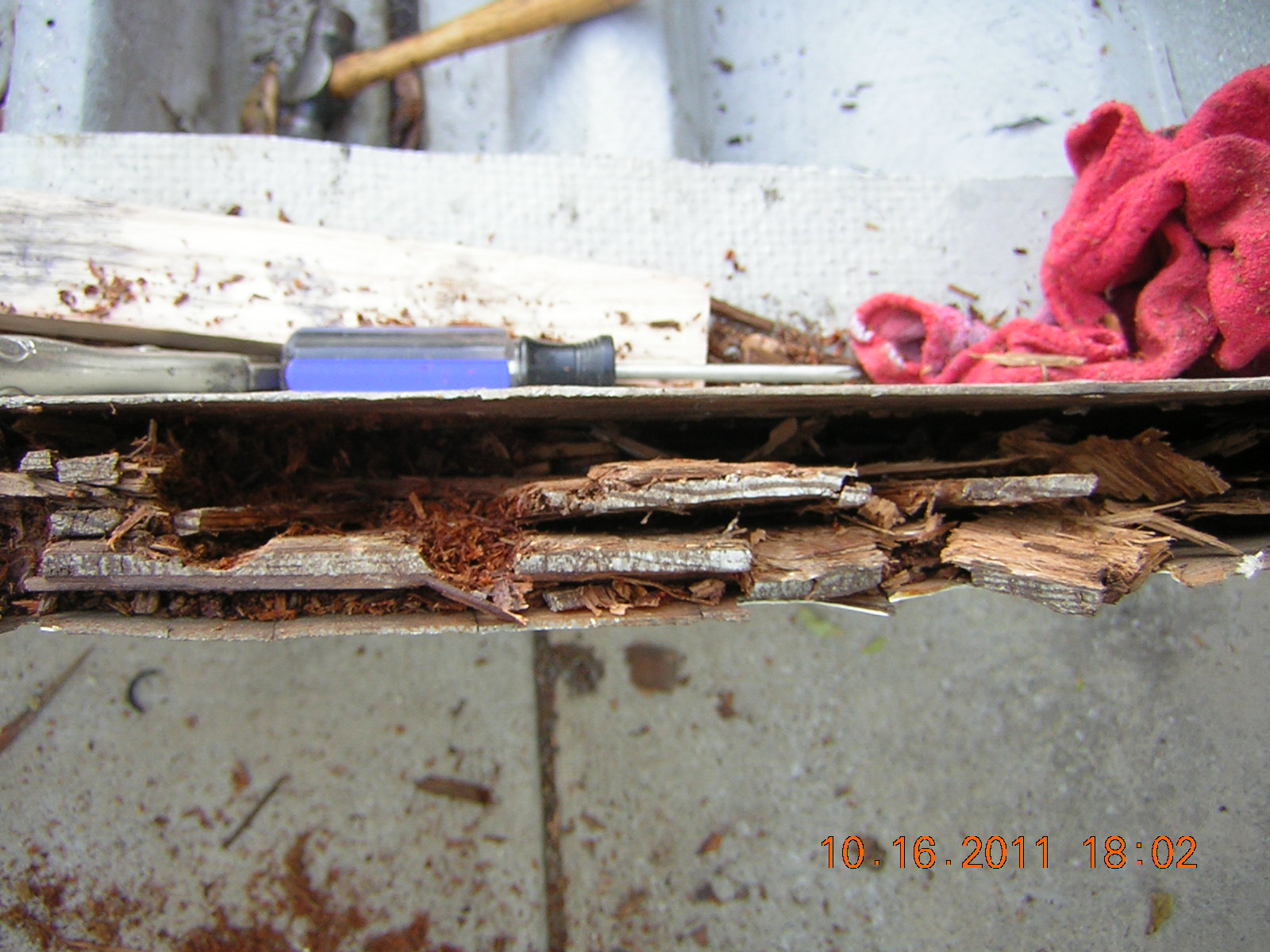

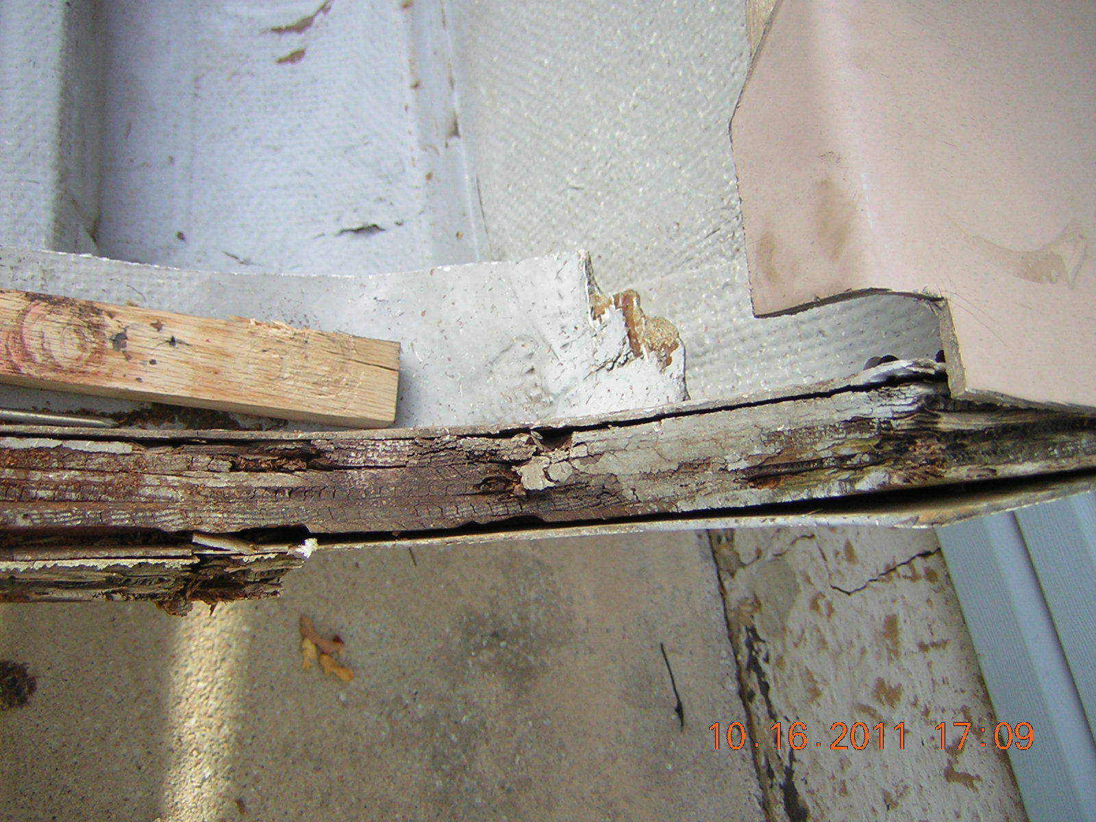

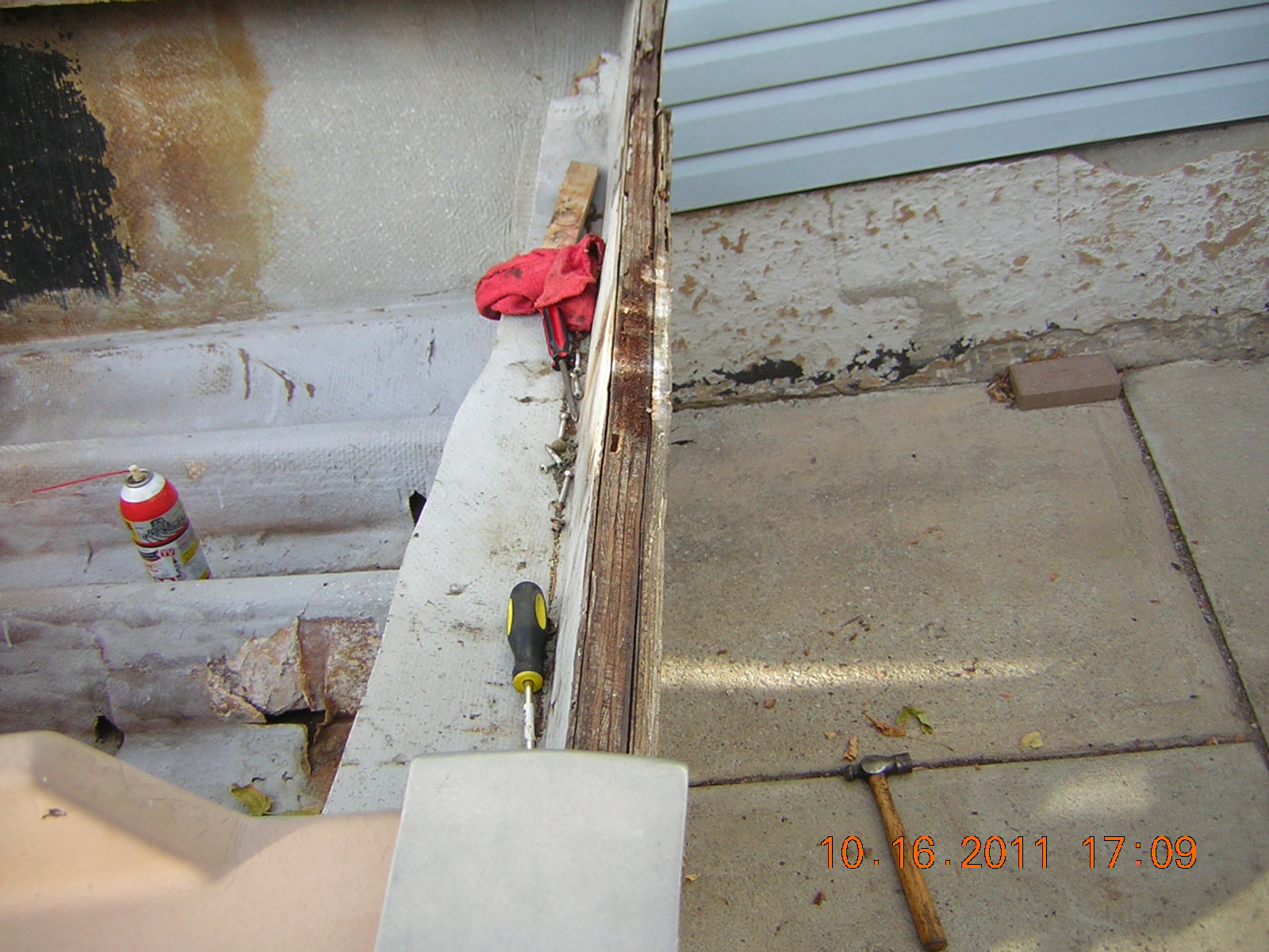

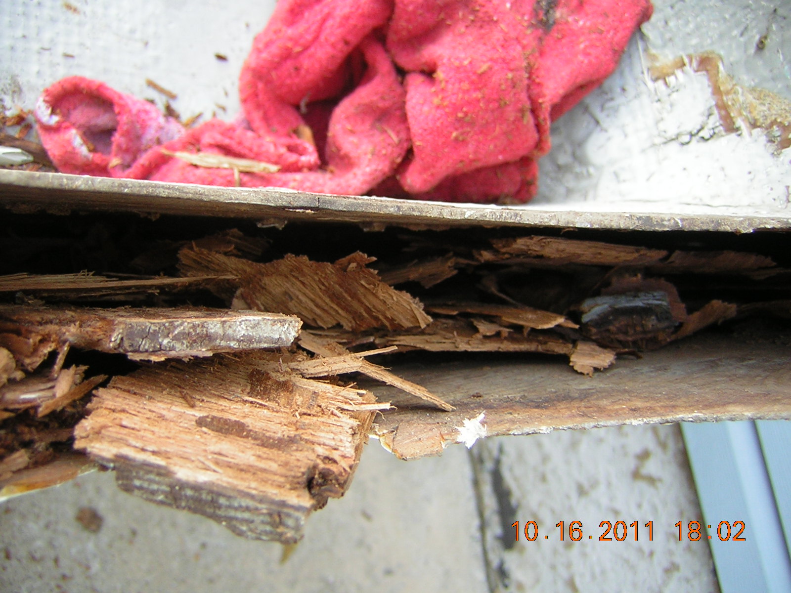

Dean, nice pics. Do you have the motor well like the one in the ad or like the one in my pics. One thing you might want to check is the transom really good. They were made of only 1" plywood and then they added 1/2" plywood to the outside of the transom to make it stronger. This plywood was attached with alum. screws that corroded away over time and then water would get into the wood inside the transom.It was a kinda designed to fail transom.If the outside wood is bad and the inside wood is good you can just replace the out side ply. One nice thing about these boats are the fiberglass stringers. No rot there,and the floor is not glassed in, real easy to replace if needed. There is another post with more pics of the inside tear out or I could post afew pics if you need them,and I will post the mesurements of the back piece you asked about tomorrow. Skip.
Re:U WILL 2 14 years 9 months ago #52734
Here are afew more pics of the transom. and next week we will learn how to put spaces between the pics. :S Skip.
