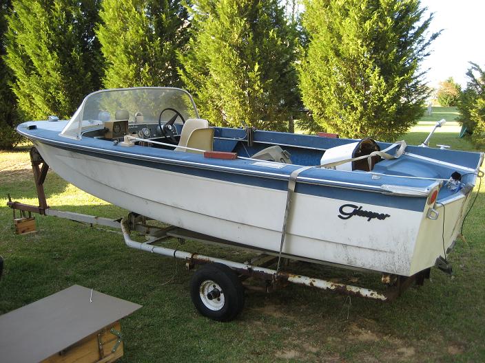

Fiberglassicers,
I just had my father-in-law pull up to my house the other night with this on the trailer! It was my grandfather-in-law's who just passed away within the last year and it has been given to me.
But where do I start? I wasn't raised around boating, lakes, the ocean or anything nautical so I'm unaware of what it would take to get these things fixed or what I should do.
Read on if you wish and please give me some advice! If you have any questions I hope I can answer them.

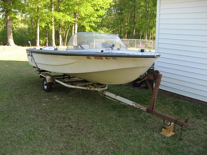

The boat is a 1967 Glasspar "Avalon" in great shape with some repairs needed. It has a 197? Johnson 115 motor sitting inside the boat that doesn't run, and it's on a pretty rusty trailer. I'll have titles for both boat and trailer soon.
What do you guys think? Where do I start? Any info on values of each item would be helpful to know if I should have them fixed/keep/trade-in or whatever. I don't have any idea on cost to fix any of these and if it's worth it. I'm not sure if a new hobby is something I'm willing to pick up this summer if you know what I mean?

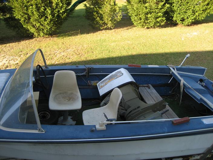

another picture...

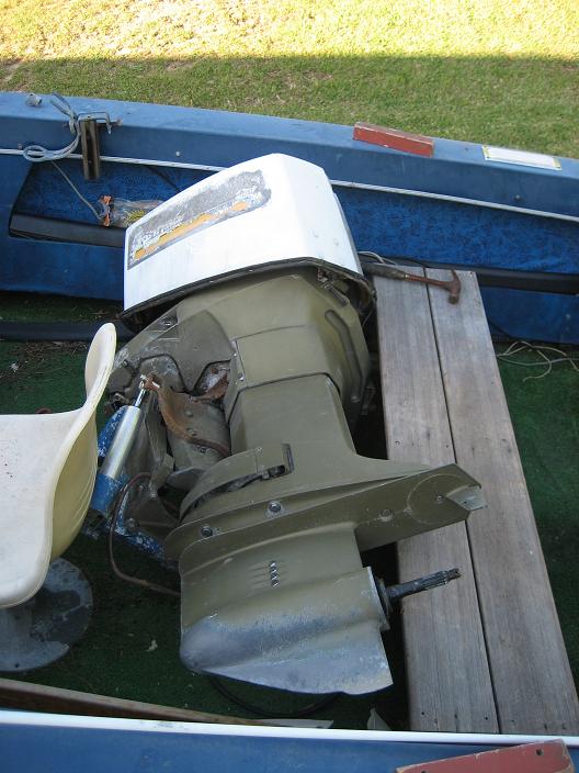

Motor picture

inside boat

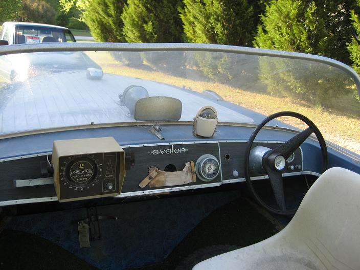

Boat dashboard, with fish finder!

Shawn: Good deal , CONGRATS. Hearing that it was passed down thru family, you should make a attempt to use the hull .
.. Good news it that a Glaspar Chapter was formed last year in your area , the Delmar - Del , MD, Va chapter. . If the trailer rust is just surface cosmetic , I would scrape & apply rust proof paint, If the back support frame is rusted thru , look for another trailer. . The big motor should be mid 70's era (?). maybe a tad too big for the hull. Could look or barder for a 70hp mid range as a possibility .
. The swivel seats seem to be a fisherman add on , not very classic. A good size for 2 or 3 people. if larger family , you may need a 17 ft Sunliner -Glasspar or so & then the 115 hp would match that hull .? Just comments, but again congrats, Glasspars are fun.

Is the floor solid? How about the transom? If you knock against the transom with the handle of a good sized screwdriver, does it sound like oak, or does it sound hollow and feel soft? Most the time, old boats need floors and transoms rebuilt, and this is not a job for the faint of heart. Do you have any experience with fiberglass?
I don't think what you have there is rare enough to be valuable. The motor may have some value if it runs, but if it's got bad compression, there's not much use fixing it unless the boat is ready for it to be installed, and you're determined to run it. Motors can generally always be fixed, just like old boats, but it can take a lot of time and/or money particularly if you have limited experience.
