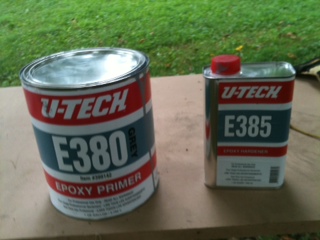

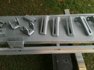

I used U-Tech epoxy primer on my trailer that has since been top coated with polyurethane paint. Granted the primer was painted on bare metal and not fiberglass. Someone with better knowledge may say yea or nay about the fiberglass. I'm not sure. The unthinned primer sprayed on real well and filled a certain amount of small cracks. I would definitely recommend spraying over brushing or rolling. Again, someone else may have better ideas about it than me. Good luck.

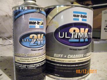

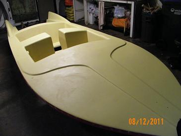

Phillipcinci, Welcome aboard. The Herters I am rebuilding had a bad surface topside, glass cloth showing through and a lot of "spider" cracks, the ones that appear on old glass. I used a high build primer that I got at a local auto paint dealer. A two parter. It's really thick and once you mix it with the activator the pot life is short. It builds up really heavy and fills cracks, splits, glass cloth show throughs and even bad patching like I do. It's like a liquid Bondo. Once on you can sand it with 220 grit to a smooth surface and all inperfections are gone. It sands really easy and if you're not careful you'll go right back down to your original finish. When you have it finish sanded you can squirt your finish coat without any other prep.
Here is the product I used.
You can roll it on with a cheap 3" roller and then toss it when finished, takes about an hour or two before you can sand.
Here is my topside after the rolling and sanding.
Here is what a finish looks like over that primer.
