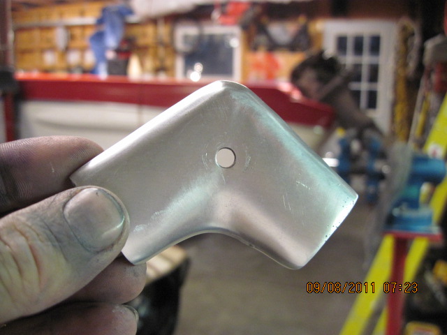

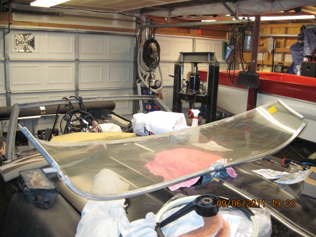

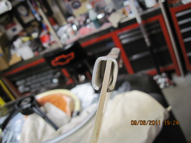

I am trying to remove the window frame from my window on a 60 Glastron Seaflite,I t appears to be held on with some internal clips.I do not want to break anything, what is the secret ??

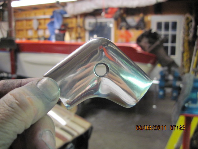

I needed to remove the frame to polish it and clean and polish the window ?
I was able to remove the frame by placing a piece of plastic board against the frame and hitting it quick and down, carefully, it came off great, and polished up nice.
