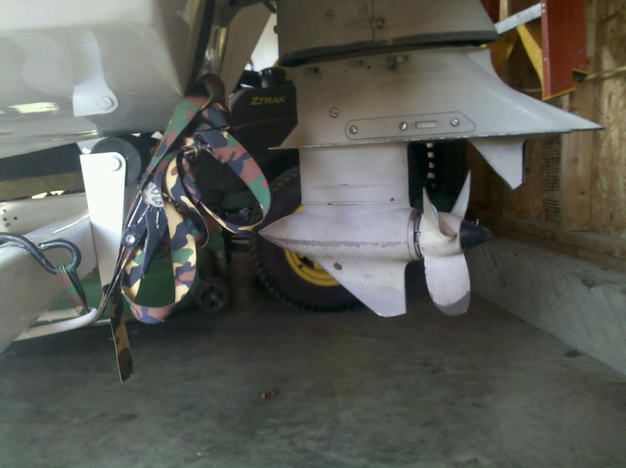

I have 8" from the bottom of the hull to the center of the prop. Is this about right? I ask because i see some here with risers.
Thanks!!

Your cavitation plate should be about an inch below the back of the boat unless it is a tunnel hull. That I'm not sure about.

Guess i am gtg then. So much to learn! Thank you!!
