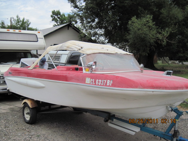

Yes its a 60 Glastron StarFlit 16'.
The step pads inserts appear to some type of butyl, white soft rubber. Mine are completely rotted away !!
I will,have to take a few pics and post them late !!

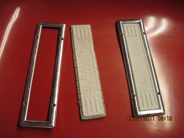

Here is a pic of the pad`s 2" x 8.25"

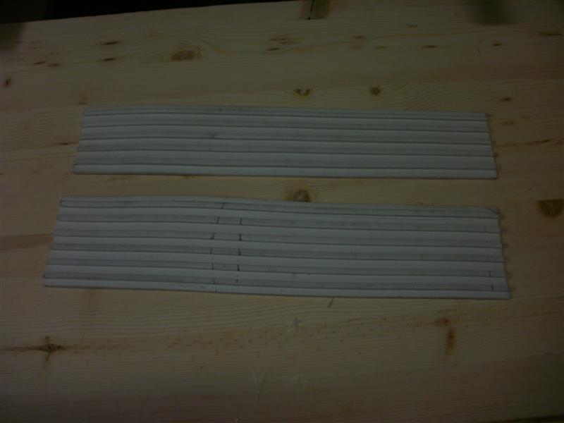

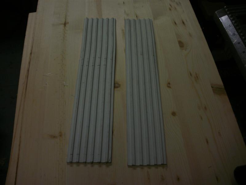

Here's a shot of some of the material I got from Wefco. I had a big order with some window trim and Rub rail when I did my 17' Skagit and Pete told me there was a minimum order on the step material? You could call them and see if you can get some the next time they do an extrusion. I don't think they have it in inventory. It comes in strips and you cut to length . Wefco Rubber
818-886-8872 ask for "Pete"

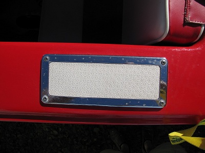

I got some of the sticky back stuff from Defender and made my own. One piece is the size of the frame and the other the size of the opening and put sticky to sticky. Not perfect but works OK. Here's a pic of them on my Tomahawk.

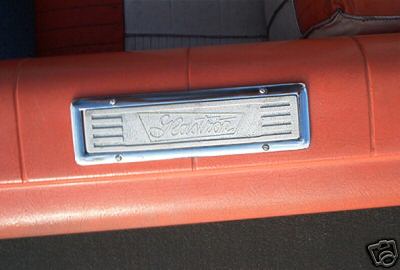

Here's what your pads used to look like
I heard someone in California was reproducing them, but never able to track them down. Love to have a few sets
