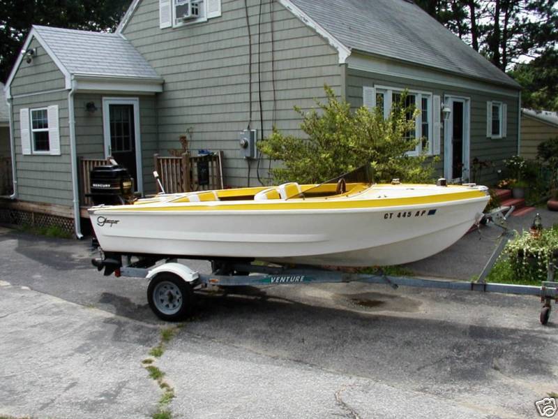

I bought a beautifully restored Glasspar Sport Lido a few years ago. I tied it to the dock for a few months, and when I pulled it out, I fould that the wetted surfaces were all blistered and discolored. All I can remember from the previous owner is that he used a 1 part epoxy marine paint.
I'm considering masking off the bad area, abn using a paint remover, then leaving the affected areas bare. A stripe may be painted at the discontinuity. What do you think?

Most runabouts weren't left tied at the dock for days or months. The paint and possibly the glass are designed to be used and then pulled out of the water at the end of a day or so.
I would probably strip the entire hull and re coat with one color. A boot strip won't look that great imho.
If you are going to leave it in the water I would suspect that you will need an epoxy barrier coat.
Nice looking boat!

Here is what happened, it can also happen with gel coat. Paint a gel are permiable to moisture. That is it won't pass liquid water but water molecules will make their way through these materials, this is known as permiability. Paint for the most part is very permiable so wehn the moisture works it's way to the paint /gel interface it lifts the paint off. This can also happen to gelcoat as it is permiable as well but not as much as paint is so it takes longer. The lifting process is also a little different once the moisture gets through the gel to the interface of the gel and the laminate, the water reacts with uncured materials, which there are alwys trace amounts of to varying degrees and this reaction outgases so that is what pushes the gel off the laminate forming the blister.
Generally there will be no paint manufacturer that would recomend their paints to be used below the waterline for this reason, unless they have specificly designed it to do so. Again some are more resistant. Generally catalized products are denser. The air dry varieties actually wind up with micro size pores that the volitiles will leave behind as they migrate to the surface and evaporate hastening the moisture getting underneath.
I use Imron, granted most of the time the boats are only wet during use but I have left them in for a week at a time with no issues. I'm sure if left in longer the same thing would happen as you experienced. A regular air dried paint would blister in a few days, they will disapear if boat dries out but paint really is not bonded anymore in these areas.
There are less permiable materials available now. They are commonly know as "barrier coats" this is what you need to use if you are going to leave it in. There is a white color one available (Interlux) so maybe you can use this with your idea of doing the bottom and use a boot stripe. The visual quality is not as good as with typical finish paints, that is the trade off, but below the water line it would not be noticeable. Regular anti growth bottom paints will not blister off but they will slowly disapear, that is how they work, they exfoliate constantly exposing new paint sloughing off the outer layer where thee growth is attached. Look at some ocean boats tafter a few years with out a repaint, they look worn off, this is why.
So either use a barrier coat directly over the gel or remove the boat from the water every few days to let the paint dry out.
