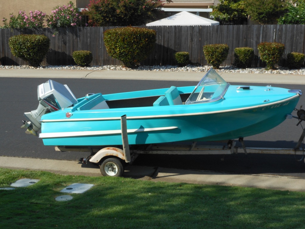

Boat in the garage cant wait to start the resto! Other than a little interior workj she is in fantastic shape. Need as far as i can tell the navagation post in the rear (anyt one know where i can find a NOS replacment?) and the rubber straps for the seats as well need replacing any suggestions?

Sweet looking little boat ! That windshield is probably worth what you paid for the boat , It looks like the original auto glass windshield ? Nice color looks like it will buff up like new. Good luck with the project like everybody says maybe get a new fuel tank and burn new gas , cool looking fenders on that trailer also.
Re:1960 Dorsett Luxury Lexinton 14 years 5 months ago #43865
  • Thank you received: 5
Gee whiz Lurch, has that boat been restored, or stored in a time capsule!?!?! Beautiful boat man, excellent buy IMHO. It doesn't appear to need a restoration, just a good going over and "freshening up" and you could be back out on the water. As the gang has suggested, old rubber fuel line parts and water pump impellers are trouble waiting to happen. Good luck, and let us see some more pics when you get a chance. ;)
