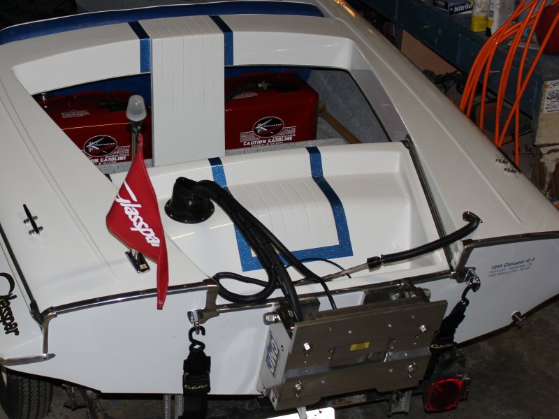

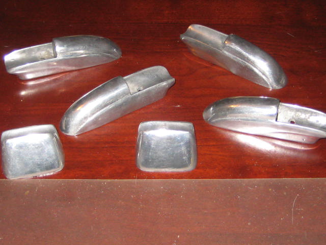

I polished a lot of real dull gray cast aluminum and annodized extruded pieces during the recent restoration of my G3. Like 65G3, I put a medium cotton wheel on my 6" bench grinder. I used black rouge, moved to white and then the brown, the pieces came out like chrome. I heard about folks that had problems with clear coat afterwards, so I sealed mine with Penetrol, where you brush it on, then immediately rub off the excess... like oiling wood.
For the annodized pieces, I first soaked them in a bath of Draino, which removes the annodization (you can't polish annodizing, it just turns black) only do this outdoors, as it creates hydrogen gas and other dangerous fumes. After the annodization is dissolved and the pieces are washed off, then it buffs up real nice, like the cast pieces.
For my rub rails and sponson rails, they were really scratched up, so before I polished them, I sanded them with a palm sander and 220 grit, then 400 grit... it got everything except the real deep scratches, but made those less noticable.
Oh yeah, the pieces too big to polish on my grinder with the cotton buffer wheel... i bought a cotton buffing wheel for my high speed drill.
Dean
